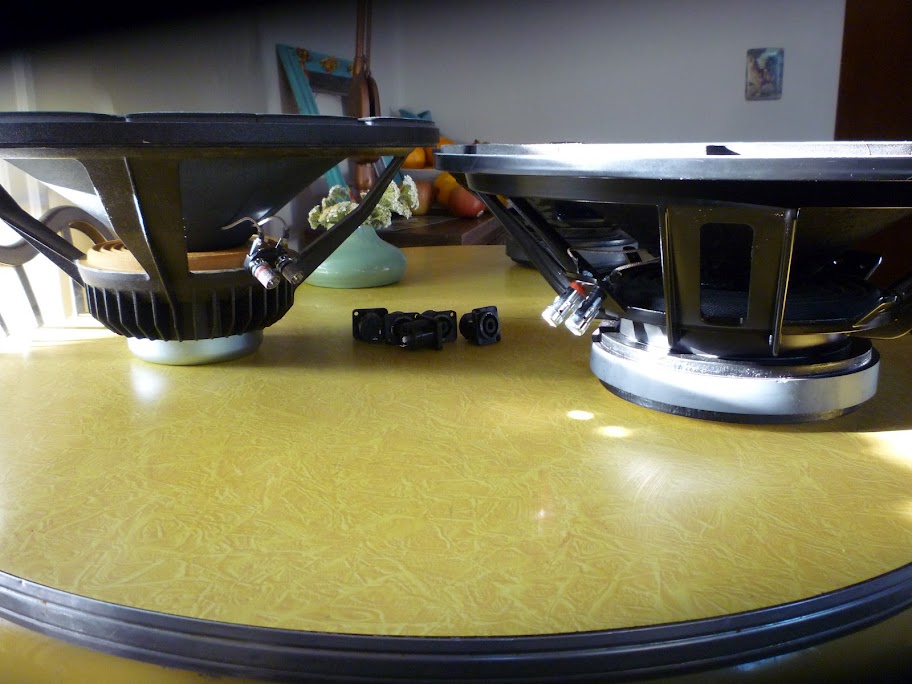

Oh Yea 7.5mm of travel on that driver!
Just got a E-mail from MCM, the datasheet from the manufacturer is correct and website is being updated.

I want to throw in the DVC385-88 in the mix only because I just orderd a couple 🙂
These are great drivers as I have used one for eight years for home/studio but do not have the necessary output for live sound.

How do I know that the 7.5mm x-max is fiction on the 55-2963?
Simple, it has a 3" coil and only 67oz of magnet. The Eminence Kappa Pro 15LF-2 has a 3" coil and a 120oz magnet and can only manage 6.7mm x-max. A Kappa Pro 15A has a 3" coil and an 80oz magnet with 3.2mm x-max.
The MCM might be 3.75mm, but the probability of it meeting the other claimed T/S parameters is highly improbable.

Not even close.
Everything I've bought from and measured from MCM with the exception of the 55-2421 has been utter shite. 😡
I will have to test it the old fashioned way.
I will throw it in a box and run some sweeps.
I am not sure to what extent magnet weight and voice coil diameter have to do with voice coil overhang but I can see where your coming from. MCM just gives the specs they get from the manufacturer (whoever that may be) and are not trying to pull a fast one any more than their neighbor Parts Express. The MCM 55-2421 8" driver considered a great budget DIY driver BTW.
For the price of the Kappa pro units I can get four and a half MCM drivers and for my purpose, (low powered bass bins), they should work fine. If they are as functional as the $25 15"s I bought last year I will be happy, they exceeded my low expectations and didn't blow.
The drivers look nice with cast baskets, here it is next to a kappaliteLF that now cost seven times as much as the MCM.
"Just got a E-mail from MCM, the datasheet from the manufacturer is correct and website is being updated."
And you believe them?
The MCM 55-2952 that did not come close to advertised specs is $13.50!
If you think you are getting B&C quality at this price point you have unrealistic expectations.
