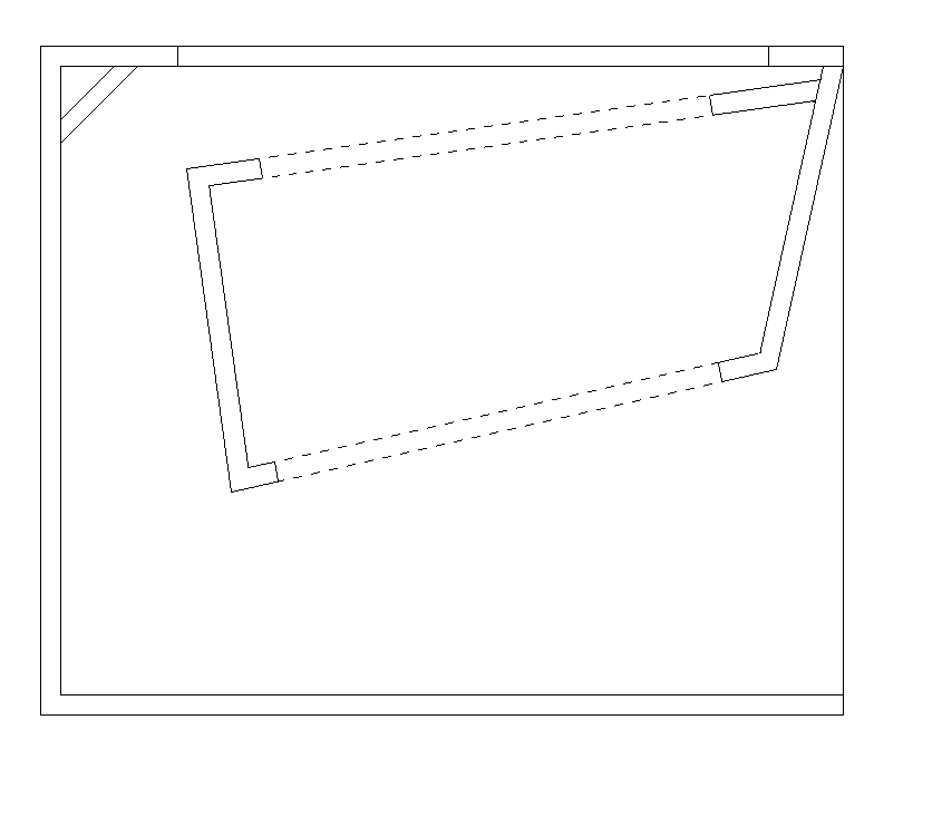

Does anyone know if it's possible (or reasonable) to combine a bandpass with a tapped horn? In other words, a subwoofer with two chambers. The first chamber is a tapped horn. The second chamber is fed by the tapped horn, and has a port. The mass of air in the second chamber is an acoustic low pass, and reduces distortion. It also resonates, and that reduces excursion. (A fourth excursion minimum.)
Here's my idea:
Is this loony?
I know that I could "test" the theory with an Akabak model. But making one would take me a couple of hours.
Is this a crazy idea?
In the meantime, here's my triple reflex model, along with some sims. You can see that the triple reflex is complex, but it definitely reduces excursion and distortion.
Here's my idea:
- A tapped horn has relatively wide bandwidth, high efficiency, and three excursion minimums.
- A triple reflex bandpass box has narrow bandwidth, high efficiency, and three excursion minimums.
- If one combined both, you could potentially get a fourth excursion minimum, and a reduction in distortion via the acoustic filtering of a bandpass enclosure.
Is this loony?

Interesting idea. It might not be too practical though.
Here's something that might work out well - a sixth-order bandpass alignment with an expanding vent for the upper chamber. A few HornResp models suggest that you can end up with an extended low end like a TH, a wider passband (a result of the expanding vent), and, unlike most THs, the "noise" is pushed to well outside of the passband of the alignment. The trade-off is a larger box (nothing's for free, LOL). Think "W-bin", but designed for less efficiency and better LF response.
To model, basically start with a "standard" 6th order BP alignment for a driver, then enter the parameters into HornResp and use the design wizard to increase the taper of of the front vent, then compensating for the change in F1 by lengthening it. If necessay, fiddle around with the other parameters (chamber sizes, rear vent size and length), until you get a decent predicted result.

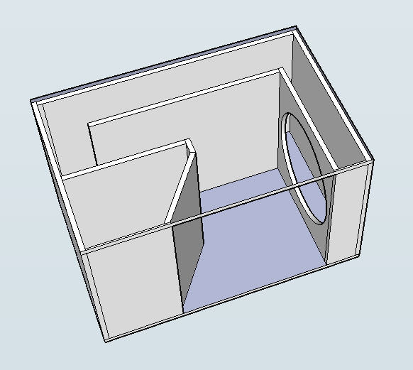

I built a cubo15, extended version, loaded with an eminence 3015LF
the nice thing about it is that it beats a bassreflex cab in output with the same driver and the same size.
the JBell tapped horn still beats it by alot though, but at 3x the size.
....I'd probably be more enthusiastic about this if I was smart enough to understand how it works. What's the practical upshot for the horn-uneducated layman?
Hi Patrick
the idea of a hybrid tapped horn is very interesting. One working example is the Cubo 15" posted on Freespeakerplans forum.
Cubo 15
This has a bandpass chamber, feeding a tapped horn.
Probably not what you are thinking about at all, but intriguing!🙂
Just to make something clearer...
The Cubo is something between a tapped horn and an 6th order series tuned bandpass alignment, just a TH with a big rear chamber instead of the first segment of the horn, or a 6th order BPH with the rear vent feeding the "hornloaded" front chamber.
I guess patrick was thinking of a design the other way round, respective the mouth of a TH is feeding a chamber which is vented via a port to the outside, or a bose style tripple chamber bandpass with a tapped horn instead of the two internal (paralell tuned 6th bp) chambers.
Isn't it?

So you want to add a bandpass filter to a tapped horn? I wonder if this is going to degrade time domain performance too much. One of the challenges with tapped horns is that they can tend to ring. Does this become worse if you add a port? If you build it then consider looking at what happens to group delay.

It's a tapped horn. You should be able to simulate it fairly well in Hornresp. Removing all the braces makes its shape clearer.

Looks like a tapped horn with a throat chamber.
thanks doll, i wrote in akabak before i posted but i didn't sure that was correct. don i feel a bit hate in the design so that i change to a new one . thanks again don.
