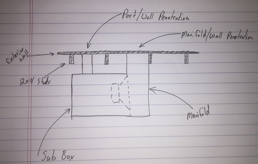

Parameters
- I would like a sub located in the crawlspace to deliver sound to the patio through the crawlspace wall.
- I would prefer not to cut 18" holes in the walls.
- I imagine a 4th order bandpass cabinet may be a good fit; the wall penetrations would be limited to the diameter of the ports.

A manifold IB cabinet can have as small an exit as a bandpass cabinet, as long as the drivers are mounted from the rear.
With only 15' to the neighbors, the distance from you to the sub exit will determine the ratio of level you hear/feel compared to them- if you are 7.5' from the sub, at the property line the level will only be -6 dB, at 40 Hz that sounds almost half as loud. If you were locate that sub under your seat, it's level could be reduced by 10dB or more while still sounding/feeling louder to you, while reducing level to the neighbors to a fraction of the annoyance.
For the levels you are looking for, a 12" with decent excursion (12mm Xmax or so) in a box that would fit under a patio chair would be plenty, and avoid cutting holes in the house and all the sealing problems. LP SmartSide paneling holds up to outside use quite well.

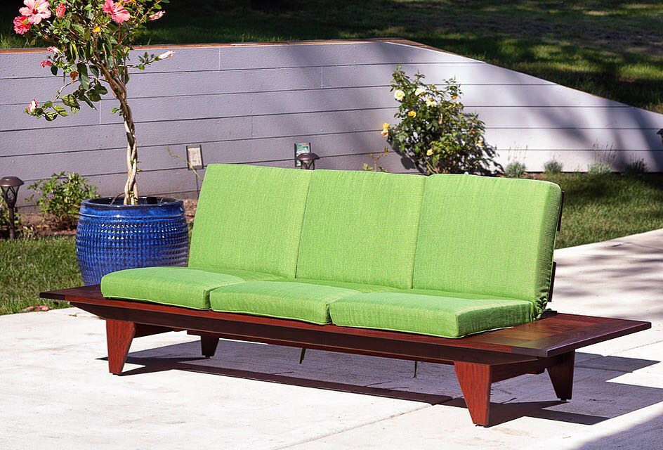

Our furniture is not compatible with tactile transducers - I am a woodworker and the patio sofa is custom made. Also, I am not interested in having sub boxes on the patio.

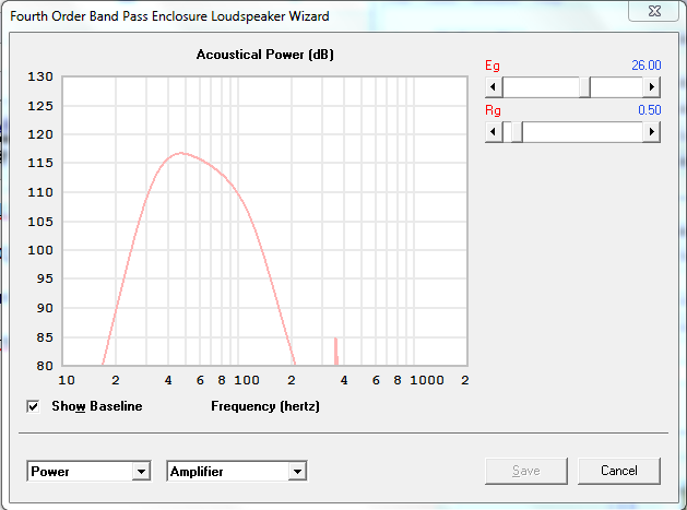

Using a Dayton Audio PA460-8 in a 4th order bandpass resulted in something quite workable, I believe.
Rear Volume 9cuft
Front Volume 5cuft
Tuning 50hz
High Pass filter set to 30hz
Nets a flat response from 40-80hz with theoretical max SPL of 118db.
Just adjust tuning frequency to 40hz and it still has a decent flat response from 30hz to 80hz and SPL of 114db

Bandpass subwoofers can be tricky to get right. All of the output is through the vents, and you will likely need to adjust their lengths a bit to get the tuning just right. WinISD also does not take semi-inductance into consideration, so the passband might not end up being what WinISD predicts.
These are the technical bits I do not know - the WinISD stuff and why I hope to be lead by the nose through the process.
As for port length, the ports will be on the outside of the box, thus by much easier to modify. The current math shows a 12" port. If it need be longer, just move the box a bit further from the interior wall and use a longer tube.
I understand this would affect the measurements of the front chamber and may need to make additional modification there.

Your sketch in post #6 has a rather large plenum/manifold which will increase upper output (80 Hz and up) quite a bit. Minimizing the size of the enclosed plenum area to the wall depth will make response like a standard ported cabinet.This is the latest idea.
It was a quick sketch to explain to goal in another speaker building site.

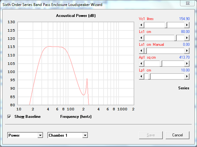

This is what I have come up with, however, I do believe there is something wrong with the WinISD file representing the PA460 driver.
Using the PA460-8 driver I created the following:
1. 7.75cuft cabinet tuned to 34hz and high pass filter set to 25hz.
2. A 6th order bandpass cabinet:
- Rear chamber is 7.75cuft and tuned to 34hz
- Front chamber is 1.5cuft and tuned to 150hz and a port opening of - 18"x6"this results in a port length of 0
- High pass filter set to 25hz.
I figured a 6th order cabinet where the front chamber is the anticipated volume of the manifold, and the port size is equal to the anticipated opening of the manifold would be a useful simulation.
If anybody would like to look at the WinISD files they can be downloaded here:
May have to right click and "save link as" to download as a file, otherwise just opens the text in a new page.
Manifold Simulation
Ported Cabinet
In an ideal world I would build a standard ported box where the port is on the front of the cabinet. I would then have the driver and port feed into a manifold and out through the wall - thus I only have a single hole in the house.
I am not entirely sure how to model this or if its realistic. I would like to keep the overall penetrations to a minimum but have decided an 18" x 6" should do the trick.

Way back when I used WinISD, don't recall having the option, but Hornresp is more accurate.
Loaded the 50 Hz Fb/BP4 into Hornresp and with 30 Hz hi-pass can handle 50 Hz/116 dB/m/85 W/2pi, but doesn't sim flat; it needs a smaller front chamber tuned lower to flatten it out.
Load Hornresp and IMPORT my .txt file to see all the info, play with the Wizard: Hornresp

Sorry, didn't feel like wading through all that, so just did a series 6th order in the same vein as the BP4:
