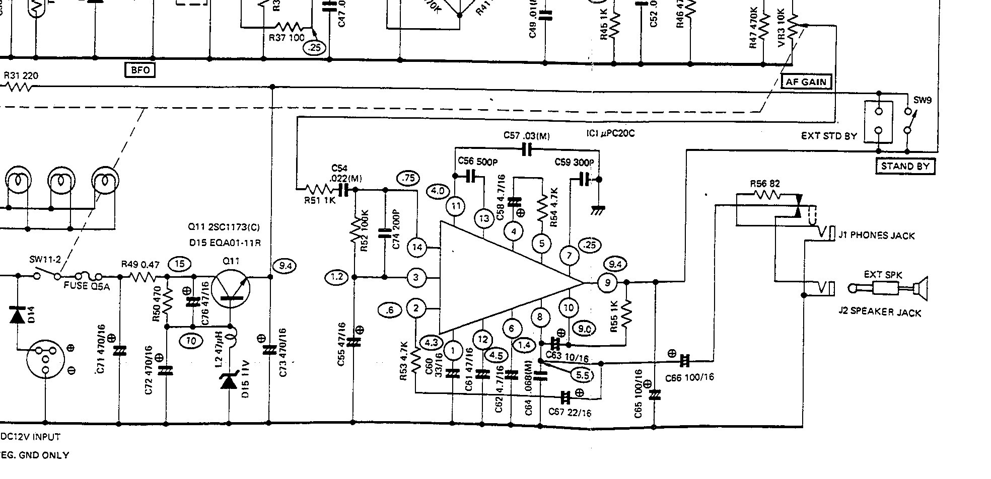

Hi. I recently acquired a Realistic DX-160 Communications Receiver, made around 1975. The audio circuit does not work -- the chip is bad. I am going to order a new replacement chip. My question is concerning what I think are bandpass filters surrounding the chip. Can anybody help me determine the nature of these and why they are there? See the image of part of the schematic containing the audio circuit. If needed I can provide a datasheet of the chip. The schematic contains the values of the parts.
OK I'll take a shot. There seems to be more than nessisary parts around that chip. Because this is a communications reveiver perhaps they are doing some audio emphasis -demphasis depending on the type of station. They may even switching the tone automatically. I would be intrested in seeing the datasheet.
A communications receiver might well have some sort of filtering to make the most of poor signals. The datasheet would be of help in figuring it out. Google draws a blank on it, BTW.

No, the uPC20C is obsolete. Mouser has a replacement -- the NTE1075A. I will attach the datasheet for that one.

I've listened to a few DX160s over the years before synthesised tuners were adopted. I wouldn't say the audio was particularly filtered as in a serious comms. receiver, as they made a fair AM receiver too. It is usual in budget receivers to carry out bandpass filtering primarily by the IF bandwidth. Post or audio filtering for various impulse or wideband noise, is by intermediate adjustable/switchable filters.
Unlike modern, one chip audio amps, most early ones needed a bucketload of external caps to make them even function. The likelihood of RF leaked into the audio and mussing up the amp's operation might be a good reason for placing filters there.

For one thing, the output coupling cap (C66) certainly is on the meagre side for speaker operation. That one should be like 470..1000µ then. C63 seems to be a bootstrap cap, enlarging this by about the same factor seems worth a shot. For everything else, the NTE datasheet is not detailed enough.
In general, I wouldn't trust average quality mid-1970s electrolytics too much any more. If the unit should still be using carbon comp resistors, these should be checked for upwards drift, too.

Thank you for that valuable information. I'm going to replace the resistors with 1% tolerant metal film. My decision to repair the circuit rather than build a new, separate one is so the unit is kept in relatively original condition. Later on I might build a custom external amp and have it so I can change back and forth. That way it retains it's nostalgia factor.

The audio chip ur looking at is nothing special as far as I can tell... what the freq response of the circuit is can be guessed at looking at the thing... the datasheet would tell the story. Regardless, it hardly matters what you throw into that spot, although finding one would make things easier. ARE YOU SURE the chip is bad??

The 1%MF resistors are overkill, and probably not worth the effort unless you find a bad resistor in there. Change the electrolytics, or check them for leakage by noticing unusual offsets, etc... the voltage are shown in the schematic.

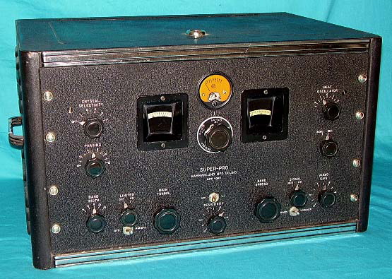

Here is more information on these receivers than you can shake a stick at, it gets more interesting
to the middle and end of this very long webpage...
http://www.radioblvd.com/hammarlund_super_pro.htm
What it looks like:
What it looks like:

Well there are other brands of receivers that are neat too... just that I thought it was you who was interested in old receivers... have fun with the repair for your friend...
