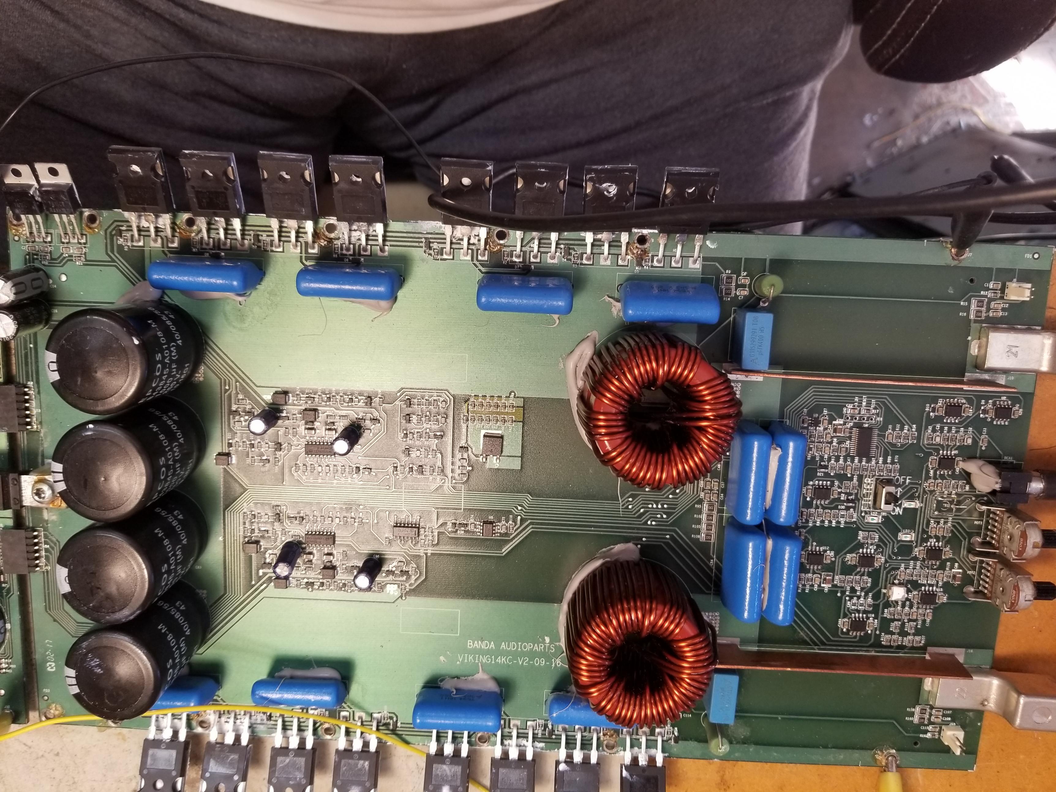

Hi, Checking a Banda Viking 15,000. I'm getting 150 volts across the speaker output. Meter positive on the speaker positive. Negative on the negative. No shorted outputs. Looks like this amp only has a -rail.

Maybe someone who knows this amp will be able to give a definitive answer but, generically...
If an amp has only one rail, it will be a positive rail.
If an amp has only one rail, BOTH speaker terminals will have a DC voltage that's 1/2 of the rail voltage. Neither speaker terminal will be connected to ground. Both positive and negative will be driven by the output transistors.
Okay, double checked. I don't know what's going on with me today. Sorry Perry. The rail is +250 volts. I was getting really strange voltage measurements. I found the problem. I have my Fluke hooked to a power supply. When I took it off the power supply and ran it on the battery. Things started making more sense. The rail stabilizes at +250 volts. The Speaker terminals have 0 voltage across them. The output is really noisy but I believe it is because the amp needs to be capped. All the caps are a little rounded on the top. Not enough to pop the plastic cover on the top.Sorry about the meter mistake but I learned something and won't make that mistake again. I'll keep it on battery from now on. Thanks for your help.
