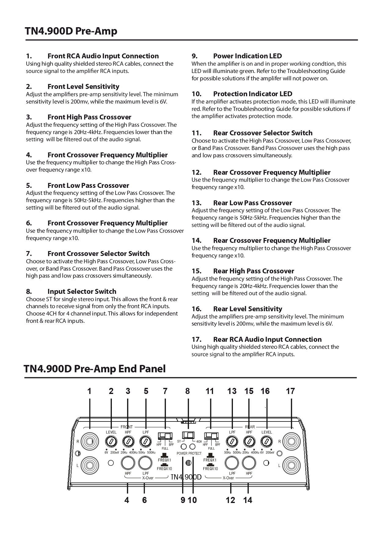

Hello,
I need advice, how to proper adjust BPF settings in my amp. Asking cause one pair subs allready burned 😀. Order again new ones and this time I hope set correct frequency within a certain range. If needed signal frequency generator to test subs is not problem, subs enclosures without any modification- vented BMW OEM.
System: Amp soundstream tn4.900d
BMW aftermarket under seats subs: Helix Match 8b-bmw.2
AMP:
AMP:
