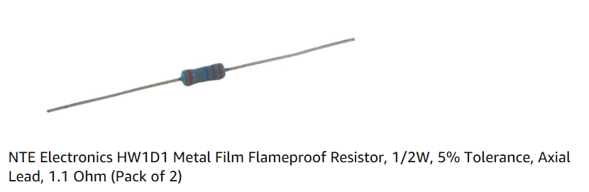

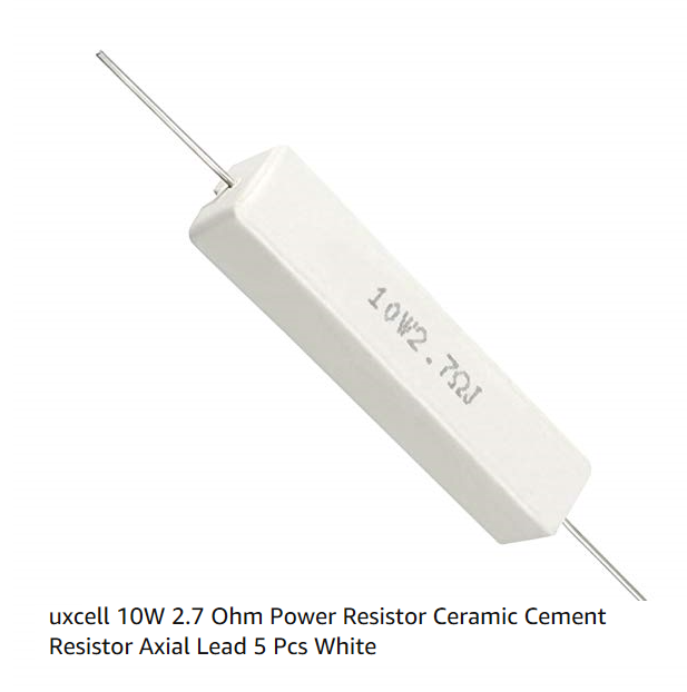

Ceramic wire wound resistors like the ones in your first pic are what you need, but see my previous post.Will these work:

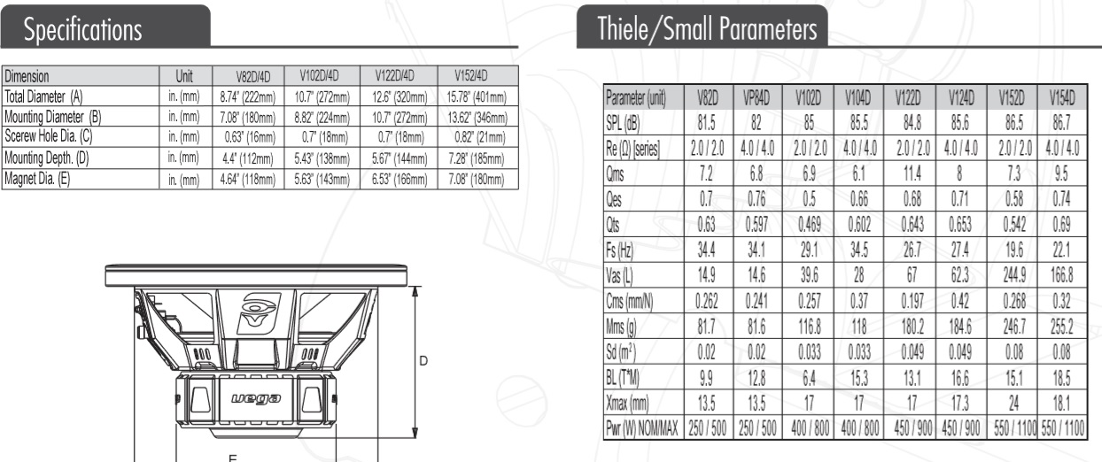

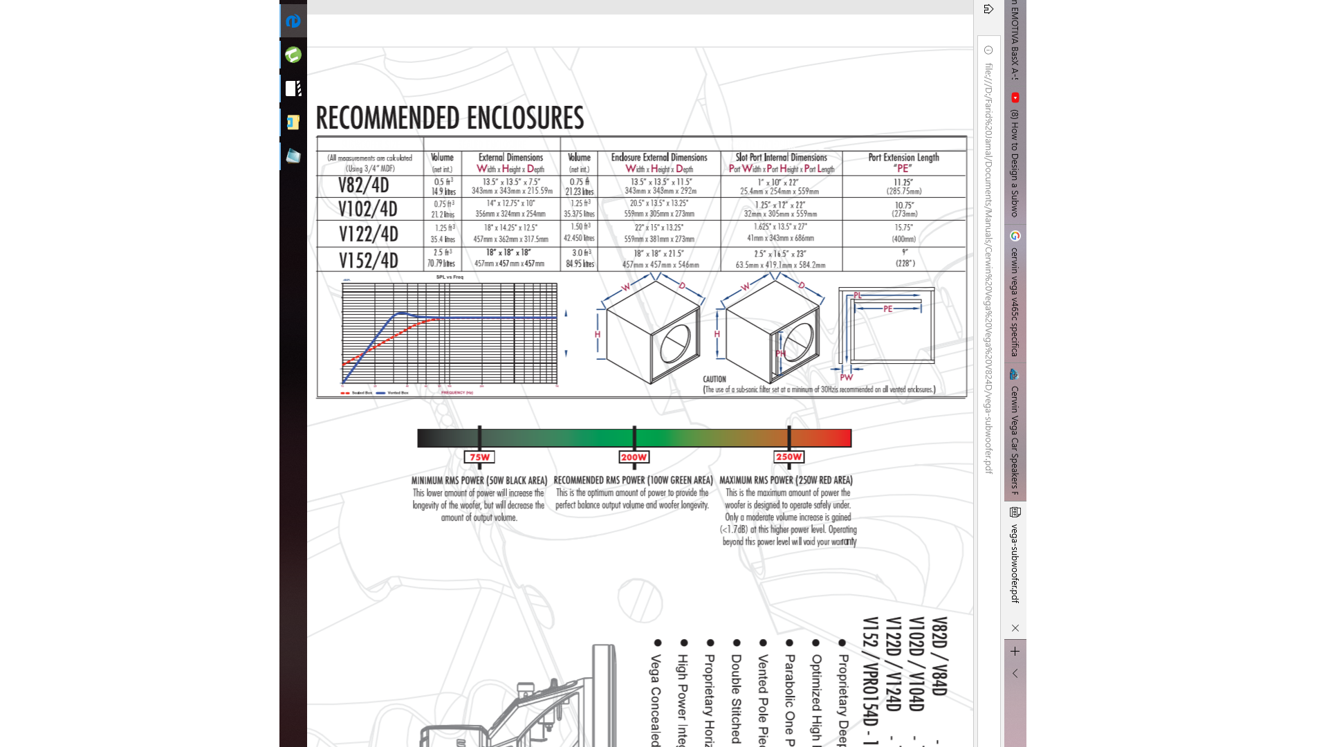

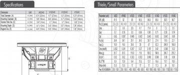

Sorry the attached thumbnails is for current woofers just wanted to share the stats. The midrange and tweeters are 94 db. So you would recommend going with the new woofer?
