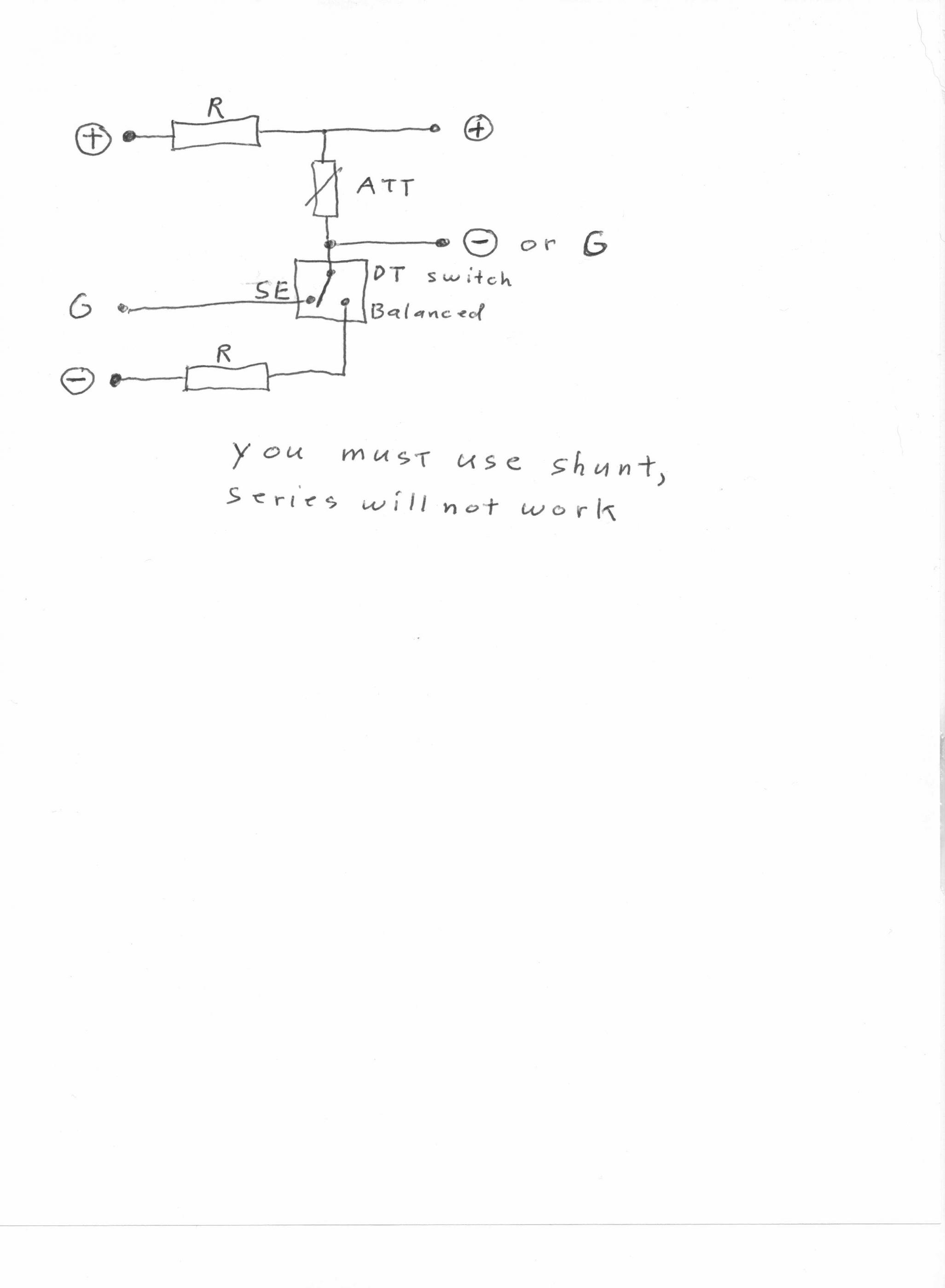

It's correct this schematic for a balanced 10K shunt attenuator:
Or only needs the 10K resistor in the hot line?
Merlin,
you need both. If you omit the one in the cold line, your attenuator will affect the hot line only.

Thanks for answers, I know that for balanced need the two resistors but the problem is when the input is a Single Ended signal remain the resistors in the ground see wiring schematic:

The two deck don't force me to do a series attenuator, I use it as shunt attenuator as this schematic for each deck:
The question is how can avoid the 10K resistor to ground when I connect a single ended signal?
That wont work balanced in and single ended out. You will have to disconnect one of the inputs and shunt the other to ground. You'll also need a ground reference from your source.

I believe that for balanced can not do it with only 2 decks. Please specifie how can do it?
go and look at Borbely again. You need 2decks for each channel.
Yes I know as per Borbely schematic is as you said: every +-signal connected to ground but follows the same problem when needed & input single ended signal when used the switch for bal/unbal un the position unbal there is two wires connected to ground one of each with a 10k resistor???
I mind that the solution must be in the input selector adding the 10K series resistor in - signal there instead in the attenuator.

If you want single ended output the shunt or series att has to go to ground. PERIOD. You can do whatever else you want, it's your unit.

I need two inputs in the preamp: one single ended & one balanced.
