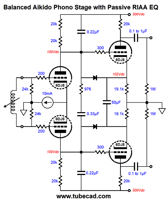

Balanced RIAA Phono
What do you think of this circuit?
I think it's four triodes too many 🙂
I also think that a more detailed opinion requires more details... like desired tube type, intended cartridge, etc.
I say, lose the active loads, and run subminiature 6N16B for cathode followers and concertina, and 6N17B for gain. It would have excellent performance, and be rather compact, too. Great curves on those little tubes.

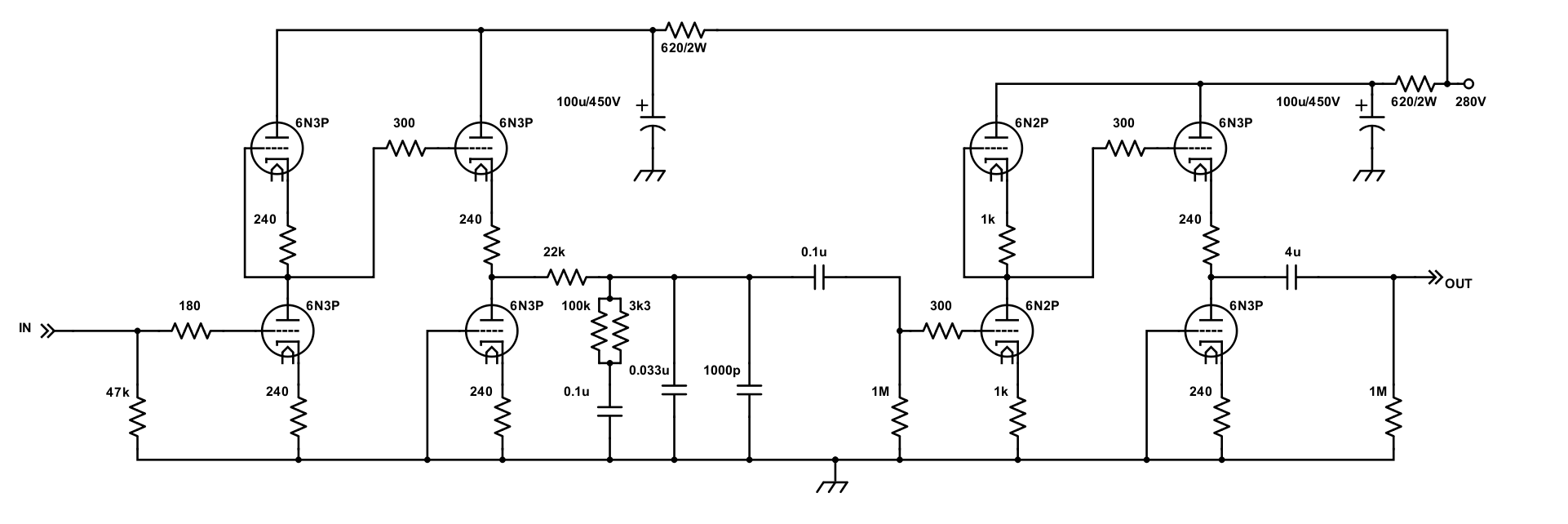

Thanks for the opinions... As it stands it's built as in the attached schematic. It's an excellent amp. I was just thinking of a way to make it balanced for someone I know...
Piano3: I love the 6F12P.

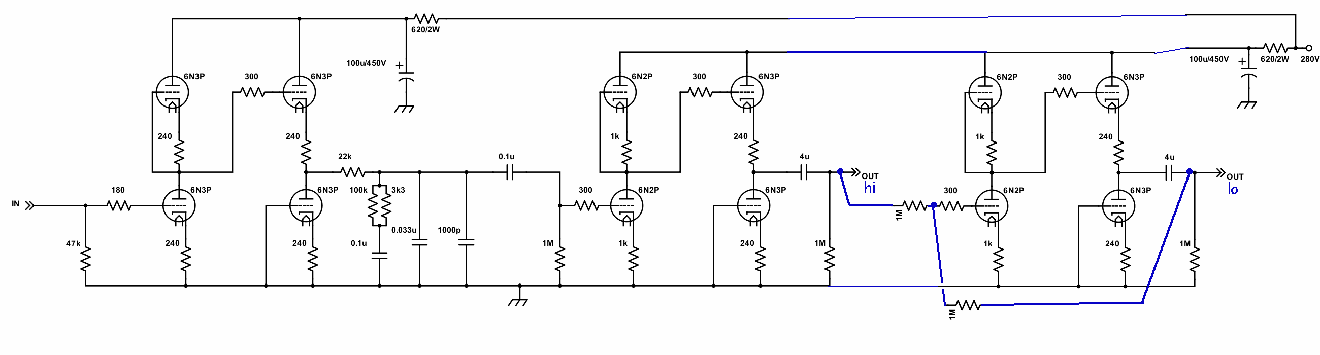

You need *three* cathode followers:
1) drive the EQ with a low impedance
2) drive the output with a low impedance
3) drive the other output with a low impedance
IMHO low-Z line drive is MUCH more important than "balanced", at least until the signal leaves the room and runs down the street.
Or put a triode-strap 6V6 on the end with a 10K:600 transformer.

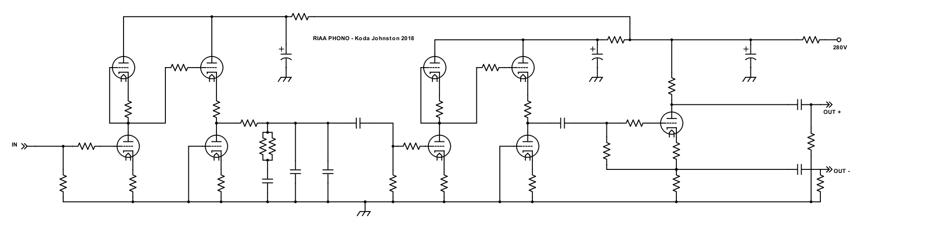

interesting, huge signal gain ( full bandwidth ) with attenuation at the final buffer stage. lowest possible noise with tubes. I also like the high signal levels 10mv @ 10khz * 5000 = 50v p-p. Assuming 12ax7 srpp gain = 70 single RIAA Resistor/ capacitor EQ is more like NAB tape EQ. 10 db boost from 3180pf || 100k resistor brings it into compliance ?

My calculations tell me the Zout of the one I've built is about 500R... The amp has a 1M input. If I wanted lower Zout, I could use a 6N6P instead of the 6N3P, and make the output push pull (in my headphone amp, the 6N6P drives 32R headphones)
