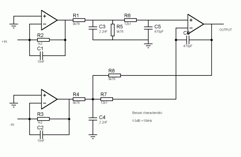

For balanced operation I made a scheme with three discrete opamps. Two opamps are for IV-conversion and one is for output buffering and balanced to single ended conversion. I also incorporated a third order Bessel low-pass filter. -3dB point at 10kHz. The first pole is in the IV-converter. I can post the general schematic but will not post details of the discrete opamp.

Balanced IV-converter
Hi Guido B,
Attached the schematic of a balanced IV-converter and outputbuffer. I got the idea from a Crystal datasheet. The whole filter is calculated with Burr-Browns FilterPro(R). A nice side effect is that any offset caused by the DACs is cancelled as long as the offset is equal for both DACs. This eliminates the ouput cap.😎
I similated both inputs with Microcap. It simulated good and measurements confirm that. No overshoot at a 1kHz sqaurewave.
As a experiment I changed the filterresponse to Butterworth and a 15kHz -3dB point. The squarewave showed the slight overshoot exactly as in the FilterPro papers. Sound was worse more "digital" so I quickly changed it back to Bessel filter response. This result withheld me from trying higher order Butterworth filters. Kusunoki states that the bad sound is not due to oversampling per se but due to the digital filter. I don't agree as you will understand.
Oops, attachment lost in transit. Trying again!:bigeyes:

-3dB Point at10kHz
jean-paul said:
Hi Elso, I don't see the use of the -3 dB point of 10 kHz. You will throw more than half the spectrum ! To me it seems like listening cd's through a telephone since it has almost the same bandwidth.
This can not be called HiFi.
Hi Jean-Paul,
It is all about choices!
I want a smooth 3150 sine wave.
I can put the -3dB point at 20kHz. This will not remove the staircase on the sinewave.
It does not sound dull as I feared.
NON-OS sounds very bright to my ears. Maybe this explains a bit.
I have been critisized a lot for the low crossover point. That's why I tried the 15kHz filter. It is a dilemma we will never solve in a NON-OS DAC. If you want a steep, brickwall filter you get ringing and overshoot and bad sound. If you choose a filtertype without ringing like the Bessel characteristic you don't get a steep filter. Especially the soft knee or shoulder of the Bessel filter can not be avoided. A higher order Bessel filter at a higher crossover will not solve the problem. I can not bend the laws of physics. Steep filtering is not possible without ringing. If you have a scheme that accomplishes steep filtering without ringing I would be most interested. As we all know the bandwith of the redbook CD is choosen too low. This was due to the constricts at the time of introduction of the CD.
I have also experimented with notch filters like in the Zanden DAC. Notch filters give even more ringing and overshoot. The result is a very weird square wave.
Feel free to use a higher crossoverpoint f.a. at 20kHz. It will not remove the staircase signal, only round it off a little.
