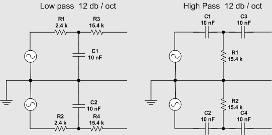

I was just asked about building a passive balanced cross over. Now I have NEVER seen one, but I'm sure it has been built.
Searches here yielded nothing so I was hoping someone might have a reference or experience they can share.
The requirement is 6- 12 db / oct high pass <passive and balanced>.
The initial ASSUMPTION is to mirror the circuit to the 2 signals to the common conductor and calculate the values as a single ended passive XO and apply to both sides.
Sound about WRONG enough? 😀
Again any starting point would be appreciated.
with passive cossover You mean the typical cr placed between poweramp and driver, or a highlevel cr placed between pre- and poweramp?
In the first case the transformation is easy. Split all series elements in two equal ones. Half the value of Inductances and resistors and doublet he value of caps. Place one of the two in the positive, i.e noninverting branch and the other in the inverting path (i.e. gnd). parallel elements remain the same.

Hey Calvin-
Thanks for the reply. You guessed it.. An odd situation where someone wants to try a passive balanced crossover on the "hi-z" or signal side <before the amps>.
Excellent. I would have calculated each side as it's own value and would have been way off.
Now I have never made a passive signal xo.. Other than the Harris mods for automotive use I don't know of any in existence. Does anyone has a schematic with values and frequency I can use as a starting point?
The low-pass example will only yield a first-order slope since there's a single capacitor.
FYI, you don't need to make the ground connection in the middle of the shunted components. You can span all the way across with a single component.
