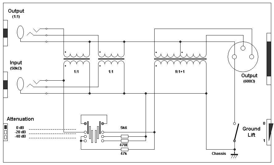

I would like to have a go at making something like the second link. Not sure as to implications for picking up from headphone out, though. Its not the Headphone/line out dual purpose single jack as on cheap keyboards. Just a regular headphone out
Thanks for sharing. So this circuit, if I am reading correctly, is a mono balanced input and output on the left side and a second 600R mono output on the right?

Thank you for that. If I insert the 2.1 filter between the TRS and transformers, I'll need one more transformer for the .1 channel, right? I should be able to work with this. Thank you
Yes, every channel (up to zillion : 1) needs a separate transformer. Use a 1:1 type, audio capable. Have them perpendicular placed if close to each other - you've got three axis available! I've not quite in view how to extract the .1 channel from a stereo headphone output, but that's your challange!If I insert the 2.1 filter between the TRS and transformers, I'll need one more transformer for the .1 channel, right?

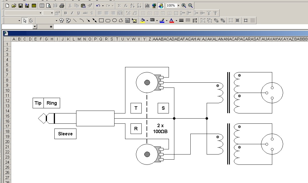

Hey man, if I am understanding this now, linked would be the correct transformers? The two pin side is signal and earth and the three pin side is signal, signal- and earth?All right.
(Sketch made with excel97, draw tools, gridlock.)
I think I might need to connect the 2.1 filter first to the headphone out and then add one of these transformers to each of the 3 outs on the filter. Would it help to have another two transformers between the headphone out and the 2.1 filter?
Yes, three pin side is signal+, middle pin is XLR-ground (separated from the Jack-ground!), signal-.The two pin side is signal and earth and the three pin side is signal, signal- and earth
Yes indeed.connect the 2.1 filter first to the headphone out and then add one of these transformers to each of the 3 outs on the filter
I don't think so, unless there is a good reason for it, eg avoiding another (yet unknown) groundloop which would cause hum.Would it help to have another two transformers between the headphone out and the 2.1 filter?
