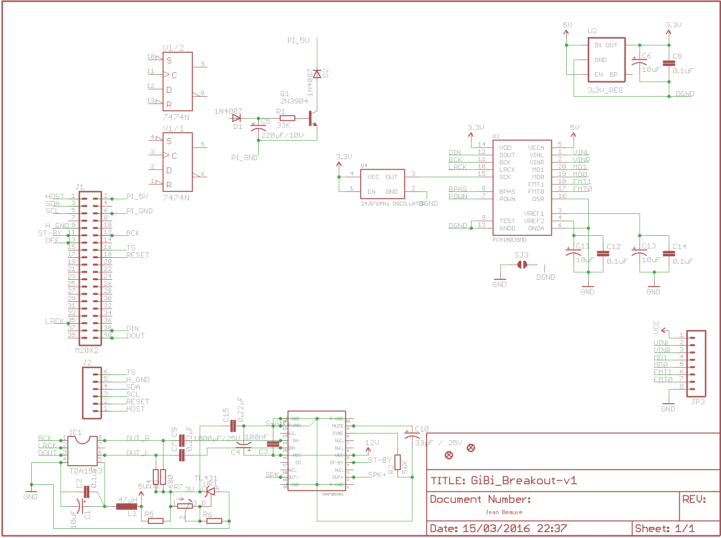

Hello,
Thank you for taking care.
Yes TDA1543 is current output DAC, I use passive I/V as most of the people here.
I don't connect Vref and use a voltage reference as virtual ground.
Here is the full schematic, I still have to finish the RPi power managment and to add the Gestic Microchip.
Any way, the part of interest, here is in the lower left corner.
Thanks to asound.conf it is supposed to be Mono channel on both Left and Right Output and accordingly to be a mono symetrical single TDA1543 output.
I should then be able to suppress the two signal coupling capacitors.
However, I beleive that there is a slight delay between "L" and "R" that prevent this trick to work.
Any idea ?
Thx,
Jean
