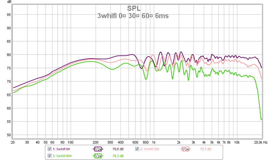

This is the dispersion of my prototype 3-way, Avalon style narrow cabinet with 8" woofers, 4" mid and 3/4" tweeter. Low directivity, low distortion - interdriver vertical lobing problems do exist anyhow and perhaps coherence is not perfect... choose your way!

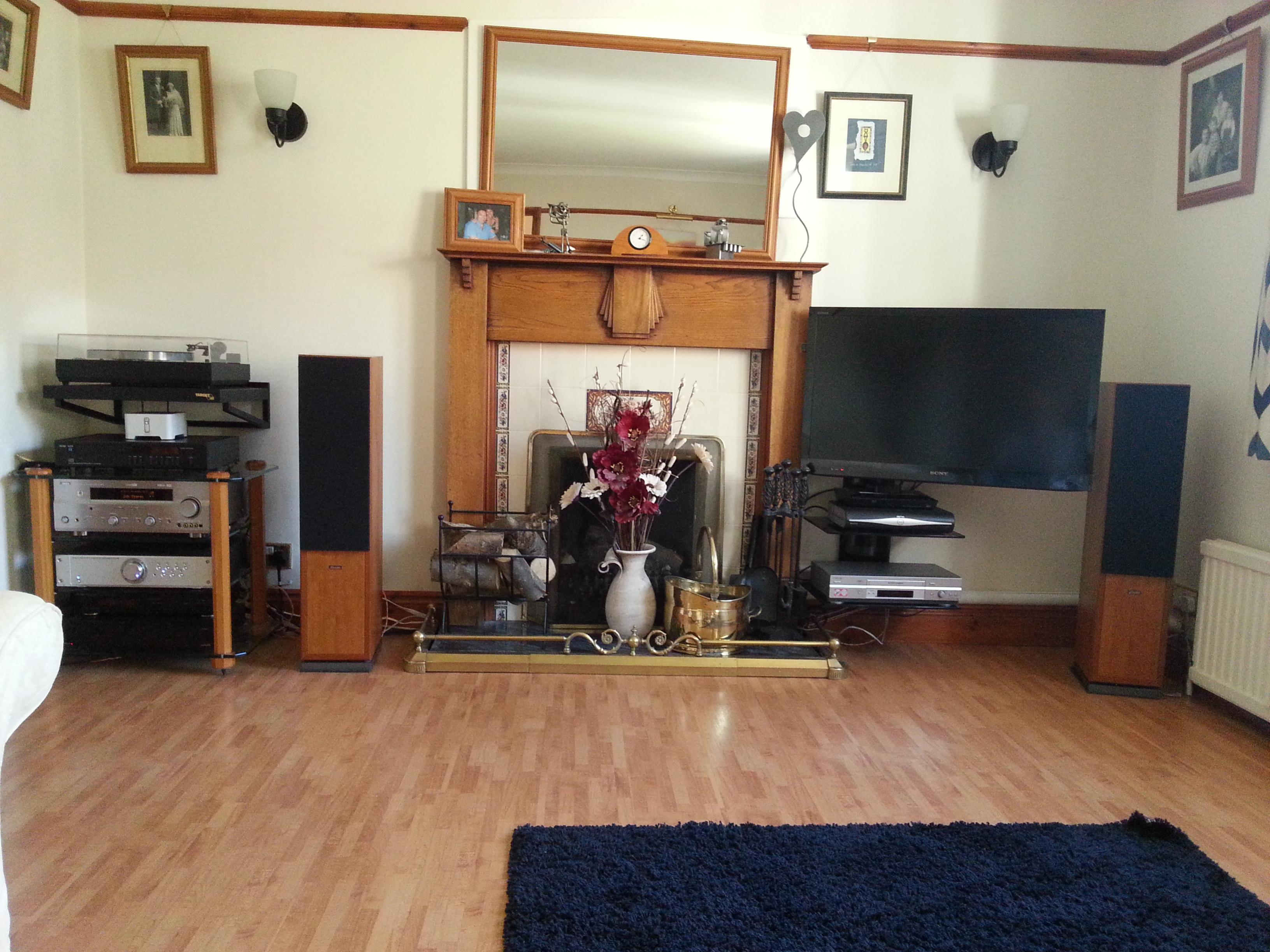

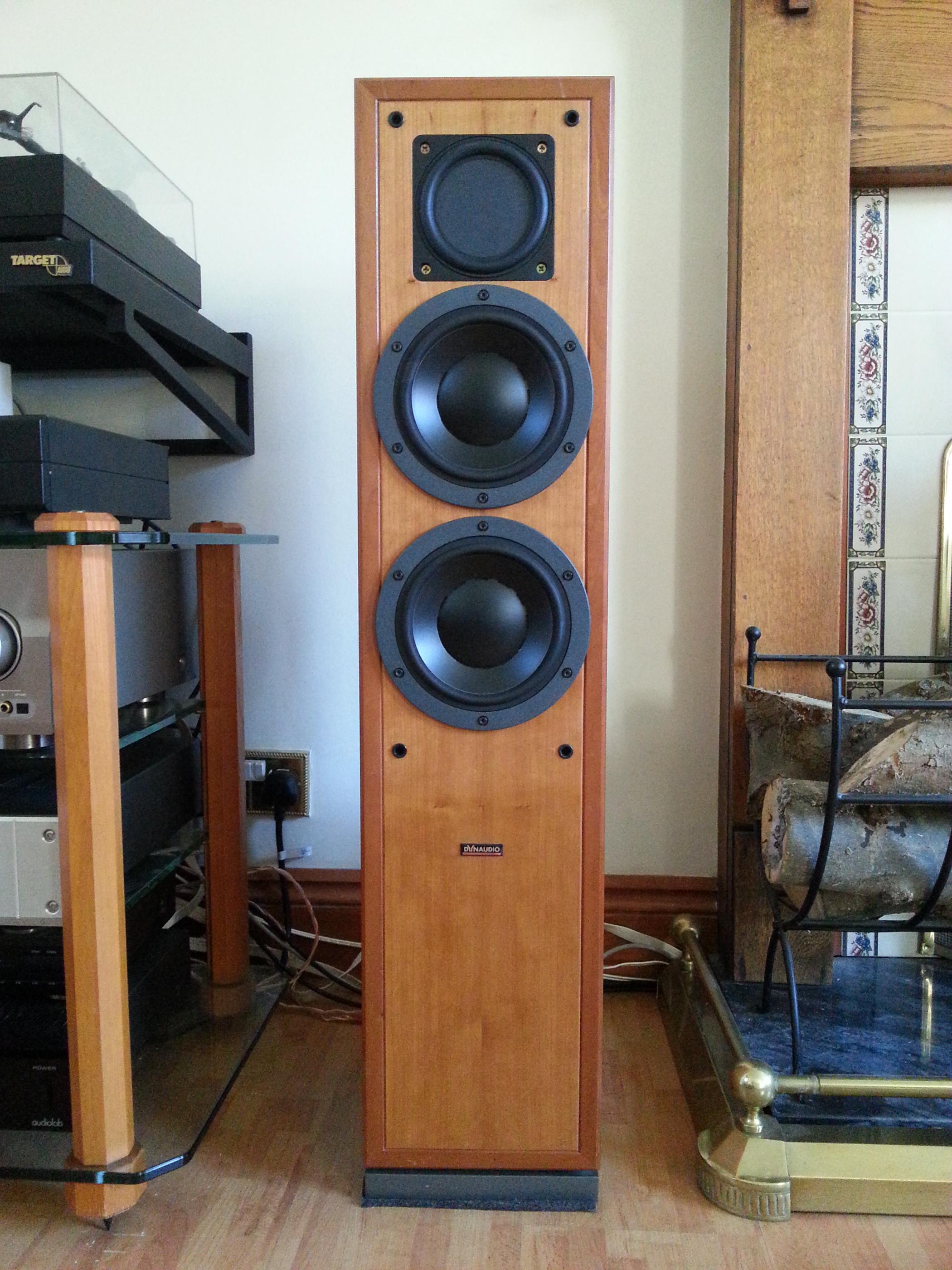

An instant upgrade would be to ditch the passive crossover and use a Mini DSP or decent (£600 to £800 ish) AV amp with DSP.
I did this with a pair of Dynaudio floor standers and replaced the silk dome with a 4.5inch Neo BMR ( see attached) The customer is over the moon and I must admit I am amazed at just how great they sound in even with compromised room placement they fill a big room with very natural & powerful low distortion music.

I don't see that this "BMR" part offers anything over another 2" ~25USD driver, the Aura Whisper. Seems to have about the same dispersion as a 2" cone/dome, but doesn't have that clean underhung motor.
