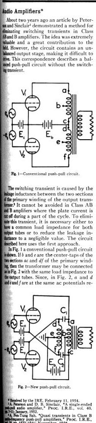

The article says:
"However it may be noted that the required driving voltage is about one-half of that for the cathode follower for the same power output"
Implying the circuit has gain, and is not "unity" gain like the McIntosh is... so the drive requirements would seem to be relaxed somewhat.
Is he calling for the inductance between D & F to be a winding on the output tranny? Or is that a separate inductor?? I suspect the former...

I think both circuits are 2 x gain of cathode follower. I don't know where the term unity gain got started referring to the McIntosh. You can get even higher gain by using a lower turn winding on the cathode section than the plate section. See two posts up, about 3 x gain using UL taps on xfmr for cathode connections.
