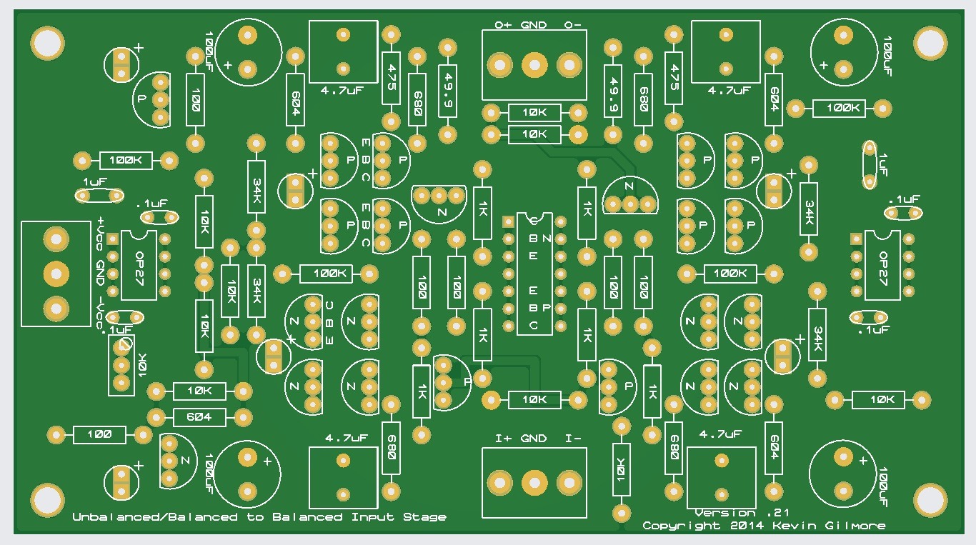

I need to convert a few SE sources to balanced. I have seen quite a few boards on AE featuring the DRV134 and similar. Some require DC and others differential AC with various levels of filtering etc. I could not find any discussion or reviews on diyaudio.
Can anyone suggest one of these affordable boards or link to a discussion I may have missed?

If you duplicate the output impedance of the hot with an equivalent value resistor to ground in the cold this will give a balanced output albeit the cold will not be a driven cold .

However I have a few sources and would like to convert them all with fbsric board. Power supply etc.
This questions seems to have been asked a few times but doesn’t look like many people have used a generic board.

You may have read this article by Rod Eliott already:
Rod also offers a PCB for his project 176, that’s more to do-i-y than a box from AE, possibly better and more versatile. Costs a little more as well.
Success!
Balanced Inputs & Outputs - The Things No-One Tells You
https://sound-au.com/articles/balanced-io.htmRod also offers a PCB for his project 176, that’s more to do-i-y than a box from AE, possibly better and more versatile. Costs a little more as well.
