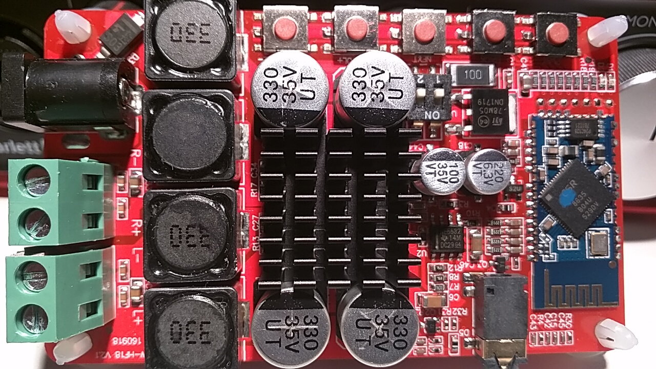

I have the red one mentioned but it is v 2.1 (which I can't find a high res pic and my camera is crap ). I am struggling in locating J8 and J9 on my board. If i can get a high res picture, would you be kind enough to show me on the picture? Also do you know if I will still be able to use the aux input as normal?

This is the best I could do so far, but I will borrow a better camera and load one tomorrow. Thanks again
G'day,
The photo will probably do. The jumpers J8 and J9 are shown in that circuit diagram as example on how you can use the TDA7492 with a balanced input or with a non-balanced input. On your circuit board there are most likely no such jumpers because the designers for a start chose for an input configuration that matches the output from the Bluetooth module.
Said in other words, the input for an amplifier has to match the output from the source feeding the input. If the input source (in your case the Bluetooth module) has a non-balanced output, it is pointless to configure the amplifier used with the Bluetooth module for balanced input. You can insert a non-balanced -> balanced signal converter but unless the Bluetooth module has a very high quality, it is not worth the extra costs - you won't notice the dfference. Craftsman-wise it will be difficult to cut into the tiny connections on the board.
Therefore, for this board, accept it has been designed for the Bluetooth non-balanced output signal and even works well like that. If you want to play around with balanced inputs, buy another cheap amplifier board (TPA3118/TPA3116, TDA7492, TDA8932) without Bluetooth and make sure you actually have a source with a balanced output (only on more expensive equipment).

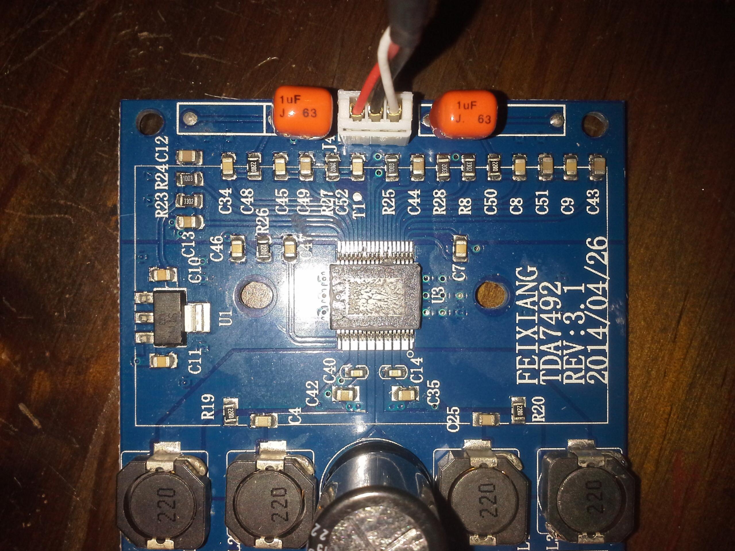

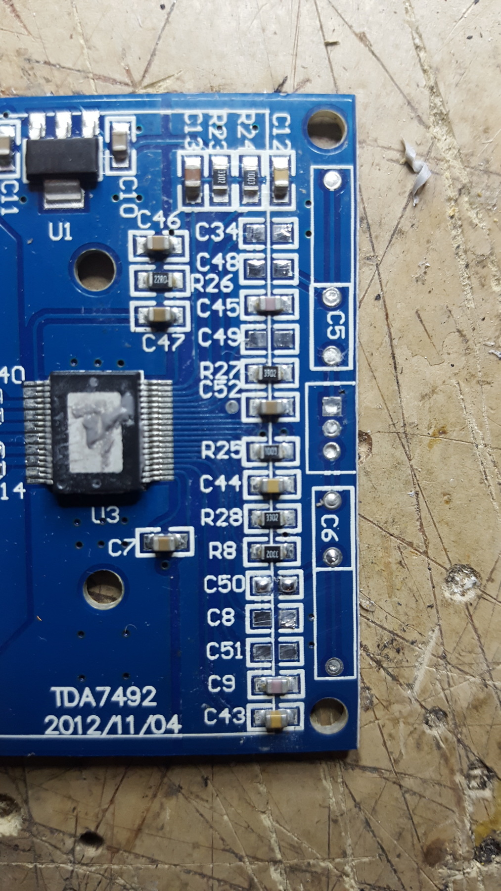

I got the board today and removed the heat sink to see what it needs (pic "mine"). I also found, what i think an identical modified one (pic "modified) online by someone stating that these are the mods that are needed for balanced input. From what i can see they removed capacitor C5 and C6 and also the C34, C48, C49, C8 AND C51.
I have a couple of questions that i am hoping you can help me with:
* Do i need to reconnect the capacitors C5 and C6 after the mod?
* Where would my L- and R- connect to (I am guessing that the L+, R+, and Ground will connect to the usual place)
* Will i need any resistors? and,
* Am i missing something?

That modified board has extensive component removal, possibly to be connected to some off-board components, but I believe they went too far - C34 and C8 should not be removed.
Here's the situation with your board:
C45 and C9 are effectively DC blocking caps for the differential -ve inputs, and since the board is configured for unbalanced input, these caps presently go to GND.
Normally I would suggest you break this connection to GND, then the newly exposed ends of these caps would become the L- and R- inputs ...
but these caps are clearly different to the large orange DC blocking caps on the +ve inputs, and ideally they should be matched - so I suggest you replace all of them ie. buy 4x blocking caps. Others here may chime in with suggestions on good/better/best caps, but the Nichicon Muse Green seems to be a go-to product for this purpose -
UES1HR47MDM Nichicon | Capacitors | DigiKey
By the way, your board has 1uF caps, but the datasheet specifies .47uf
For the +ve inputs remove the 2x orange caps, and replace with the new Nichicons.
For the -ve inputs;
- remove C45, then connect a Nichicon to the exposed pad (or for stability, the metal edge of C49) and from from the other leg of the cap to your L- source.
- remove C9, then connect a Nichicon to the exposed pad (or for stability, the metal edge of C51) and from from the other leg of the cap to your R- source.
And finally, I see a 22ohm resistor in series with the +ve inputs. I think these are unnecessary, so you can bypass them by putting a small solder blob over them. But if you decide to keep them, you should add a 22ohm resistor in series with the -ve inputs, so your +ve and -ve inputs are matched.

Thanks for the explanation mate! Can I just clarify that i understood correctly. I should remove the C9 and connect one leg of the cap (Nichicon) to the board (side closer to microchip)and the other one to the R- input (do the same for C45). That way i don't need to cut the ground. Or alternatively cut the ground, replace the capacitor and connect input on side further from chip. From memory caps less than 1uF don't have polarity so i wont need to worry about it, right?
Correct.I should remove the C9 and connect one leg of the cap (Nichicon) to the board (side closer to microchip)and the other one to the R- input (do the same for C45).
Now that I think about it, though, I don't like the idea of the Nichicon just sitting up above the board, supported only by this tiny solder connection. It would be better to lay the Nichicon on its side, or top, somewhere at the edge of the board, stuck down with a small blob of silicon. Then bend one leg of the Nichicon across to the connection point.
