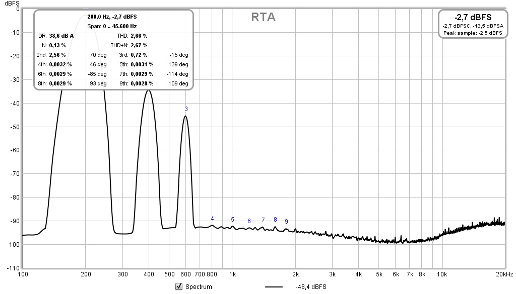

Here is the schematic and some LTSpice performance predictions - predicted THD for 2Vpp into 250ohm cans is 0.006% - a very respectable figure:

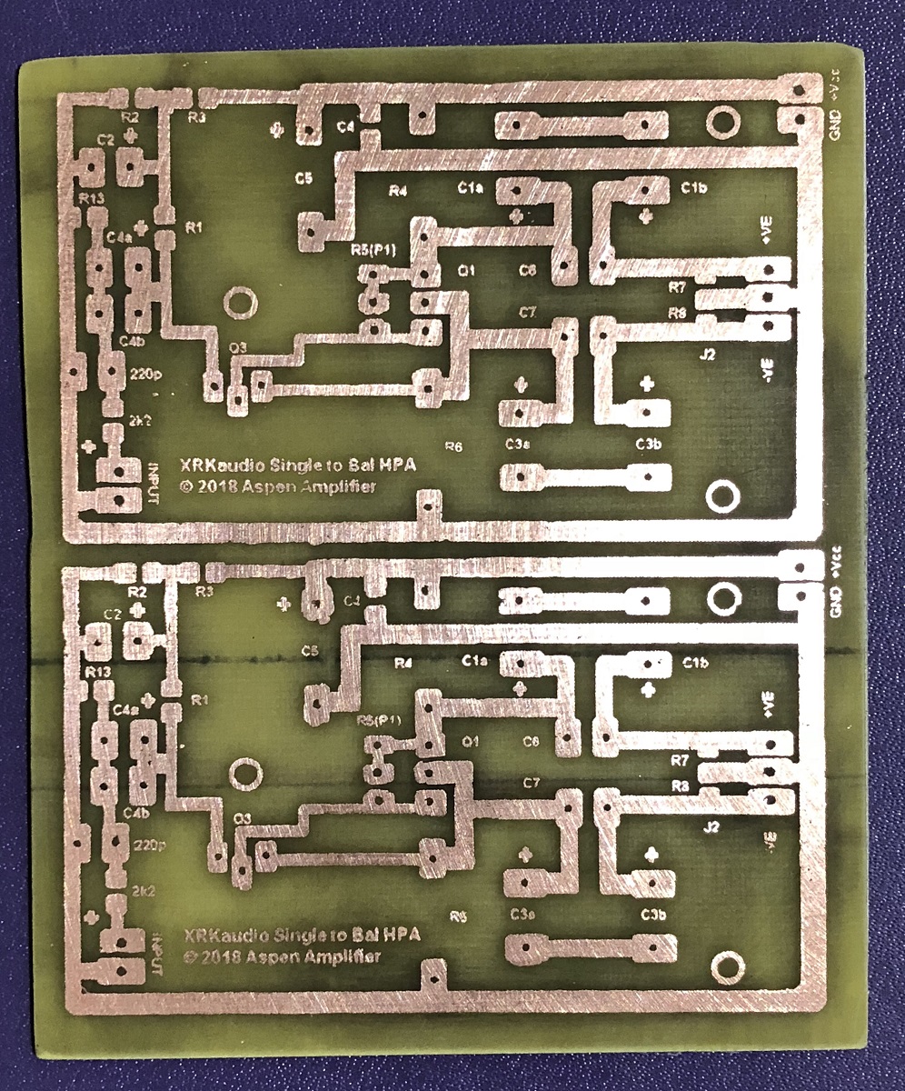

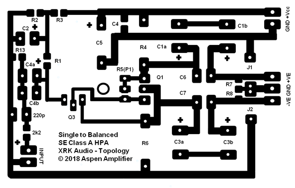

Here is the artwork for a home etched PCB:
Here is the resulting hand-made etched PCB:

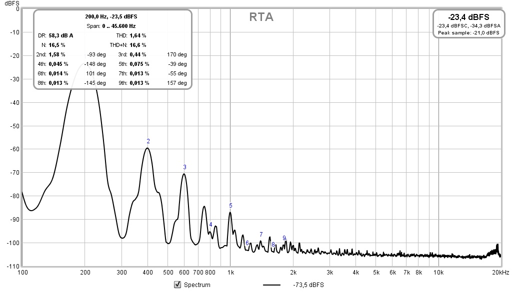

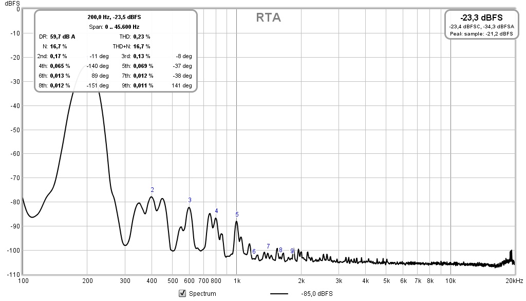

And here is the measured FFT for 2.0Vpp into 49ohms:

0.03% THD is not bad for 2 transistors
Correct. And it’s mostly 2nd harmonic and a little 3rd. Beautiful sounding. Very natural and yet very dynamic.

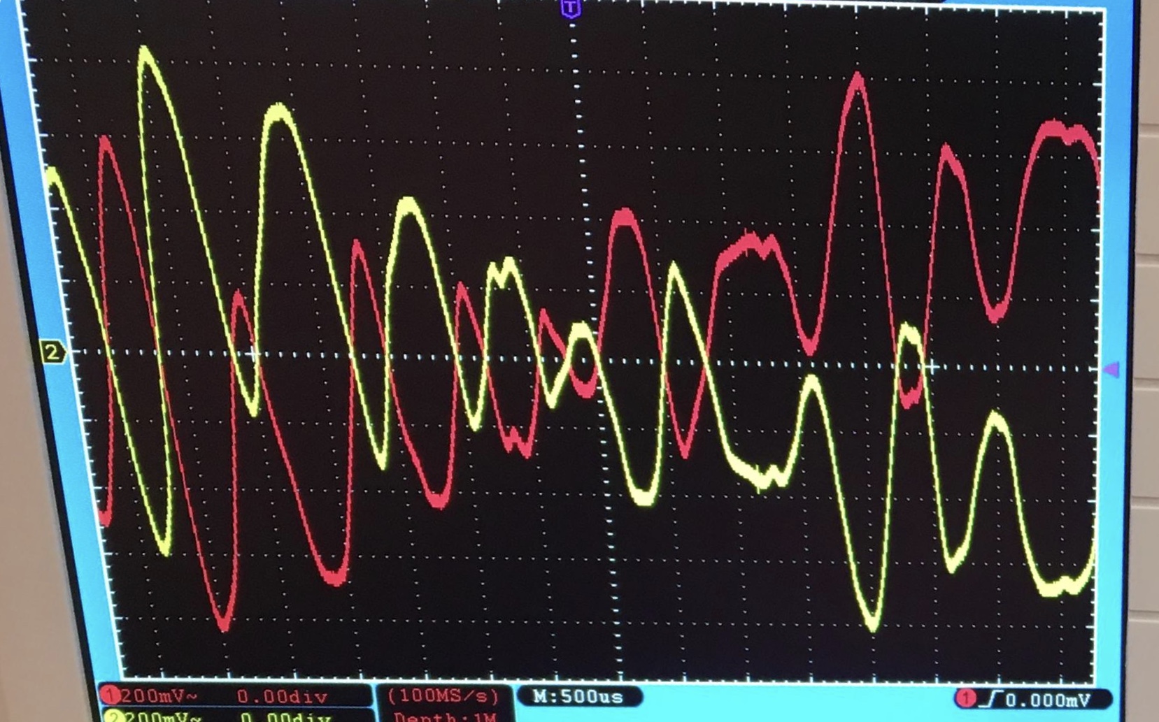

When viewed with an OScope the signal splits very evenly with square waves:
And with music:
And with music:

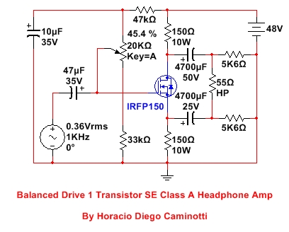

Horacio, take a close look at the "balance" of the 1-MOSFET circuit you posted. The output impedance of the top node (drain) is 150 ohms, while the output impedance of the bottom node (source) is [150 || (1/gm)] where "gm" is the transconductance of the MOSFET at the chosen bias current. I assume you'll bias it somewhere around 77mA , similar to the schematic in post #1. The impedances are not even close to balanced.
Possibly, I should change the name of my circuit from balanced to unbalanced, or better yet, to floating 😀😀😀. I should change the name of my circuit from amplifier to buffer, too 😀😀😀. If someone tests it, you will find that it does not respond very differently to the one that starts this thread.
You know Mark, you don’t need perfectly balanced impedance on the two halves to have pretty darn good balanced output signals as anyone can see from this OScope screenshot. Also, the slight imbalance imparts a more pleasing second harmonic signature as shown in the FFT.
