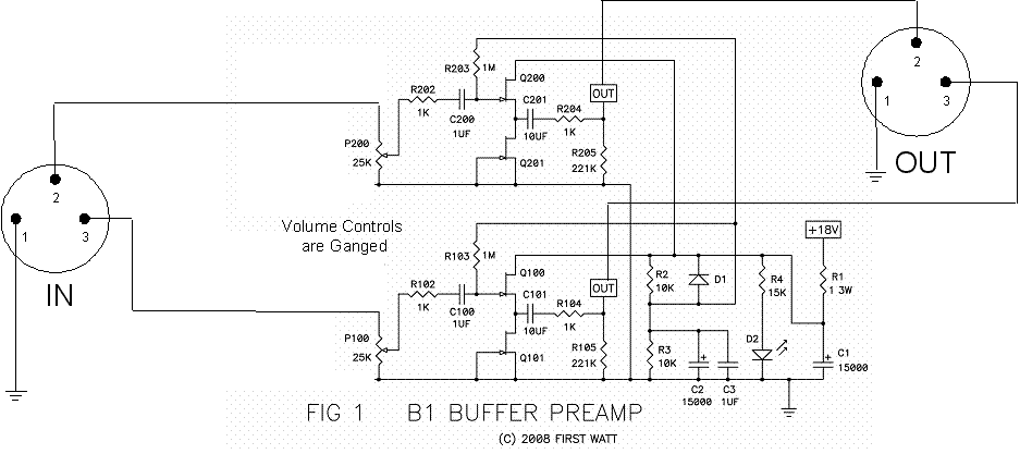

Hi:
I have read through the B1 buffer thread and while there are several references to using the B1 in balanced configuration there has been no schematics posted.
I want to use the B1 to buffer a 4 deck pot. I need balanced line in and balanced line out.
Will the following work (using the Pass B1 Buffer)? Only one channel is shown.
Are there any changes required?

Hi Doug,
Newbie here. I am interested in building a balanced b1 buffer. Now I am trying to finish the 200 over pages of thread on the b1 buffer. Your thread is the only one that I have searched and came across that discuss about balanced circuit for B1.
Just a few questions,
1. What do you mean by volume controls are ganged?
2. Since I am using 2 b1 buffer boards, how do I tie in one volume to control both balanced L/R channels?
Thanks.
Hi Doug,
Thanks.
Answer:
1) It means that the volume control (in this case) has 4 distinct variable resistances or if you prefer 4 "channels". You will also see them referred as to 4 ganged pots (I do mot know the explanation of the word)
2) Buy using one of these (AS AN EXAMPLE). This type of potentiometer is able to handle 4 channels.
ALPS Quad Potentiometer RK27114 blue velvet 5K 10K Pots - eBay (item 260562977001 end time Apr-03-10 05:10:06 PDT)
Cheers:cheerful:
Eric

You could also use two stereo volume controls, and then have a volume control for each channel. This might be easiest to manage.
Aaron.

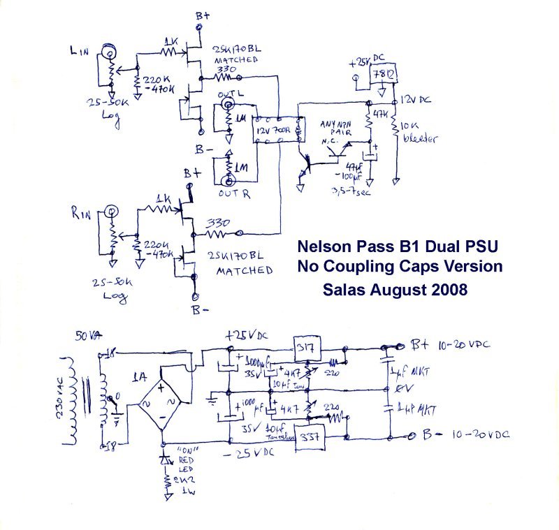

I think you have to make two stereo sets of the buffer and keep the psu ....😛
Warning there maybe newer versions in the diyaudio forum from Salas and other users!😱

What about going to Ground in the balanced B1 ?
Should I really go to ground twice as in the schematic in post 1 above?
So pin 1 of the XLR and between C1 and D2?
My technical knowledge is not very high but my gut feeling says no, maybe only the XLR pin1. In my idea it would make the amp unbalanced?
Ruudjoo
It's actually 6 times to ground in a balanced setup, isn't it?
4 XLR pins and 2 power supply Grounds.
Ruudjoo
What do you mean by 2 power supply grounds? In my case I used 1 ground for each # 1 XLR pin, one for the ground pin of the power cord and one for each PCB. All of them were bolted together with the same bolt at one point on the case. The idea was to do a star ground to prevent any hum's.
Eric
I'm beginning to see that it will work with all "grounds" together.
I'm not very technical, I was afraid of hum and found it strange that the minus of the power supply is connected to the other grounds in the scheme.
I count 4 #1 XLR pins and 2 minus/grounds (for a balanced setup of twice the stereo setup) but indeed I am testing my first print now and it all works fine, whatever I do with the Grounds.
A star ground is more or less what I try to do; it has many fans but I also read an article against it which was beyond my understanding; I think it was about tube amps.
