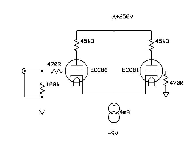

A slight disagreement ensued in another thread (Mullard 5-20) regarding balance in long tail pair phase splitters, where the "tail" is a CCS. My contentions were (and are):
1. The CCS does not assure DC balance.
2. The CCS does assure AC balance IF the plate loads are balanced. The phase splitter balance is dependent on plate load matching and nothing else.
3. The AC balance is absolutely independent of the tube matching.
As a rather dramatic demonstration of the power of the CCS tail, I set up the attached circuit. One half of the LTP is an ECC81, the other half is an ECC88. The mu, transconductance, and plate resistance of these tubes are wildly different, so this goes well beyond matching sections.

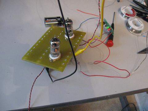

The test circuit was put together in my usual neat and careful fashion- i.e., it was a total mess. The CCS was a bipolar cascode, using the old diyAudio boards- it's similar to the bipolar CCS circuits in "Valve Amplifiers," 3rd edition. There is no provision for balancing or feedback, other than matching of the 45k3 plate resistors.
The supply voltages were as follows: B+ was 250V, B- was -9V.
Now, does the CCS cause DC balance? The voltage at the ECC81 plate was 205V, meaning that about 1mA was flowing through it. Plate voltage of the ECC88 was 118V, meaning that about 2.9mA was flowing through it. Clearly, the DC conditions are NOT balanced. But do they need to be in order to form an ideal phase splitter?

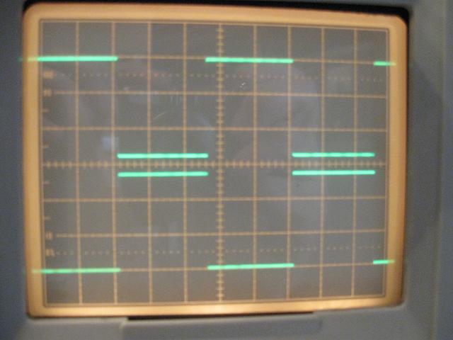

And proof of the pudding: with 0.4V peak to peak square wave input, here's the output (4.8V p-p for both sides). The balance is about as good as can be eyeballed on the scope.
CCSed LTPs do NOT require any sort of tube matching or feedback or any other fancy scheme for AC balance, even with GROSS tube mismatches.

Theory (Kirchoff's current law) holds true. Who'd a thunk. Moral of the story: use a CCS, and stop the fancy balancing schemes. Balance inherent to the topology, not the device.

No, because its two AC signals you want not a DC signal.
However if the DC conditions are way out you might get one phase clipping before the other.
The DC unbalance and AC balance with CCS tail seem pretty much as expected. There likely are some other reasons to keep the tubes more matched though. I would think distortion would increase if the two tubes are not operating from the same point on their characteristics. Not to mention some loss of headroom if the DC balance is off far enough.
