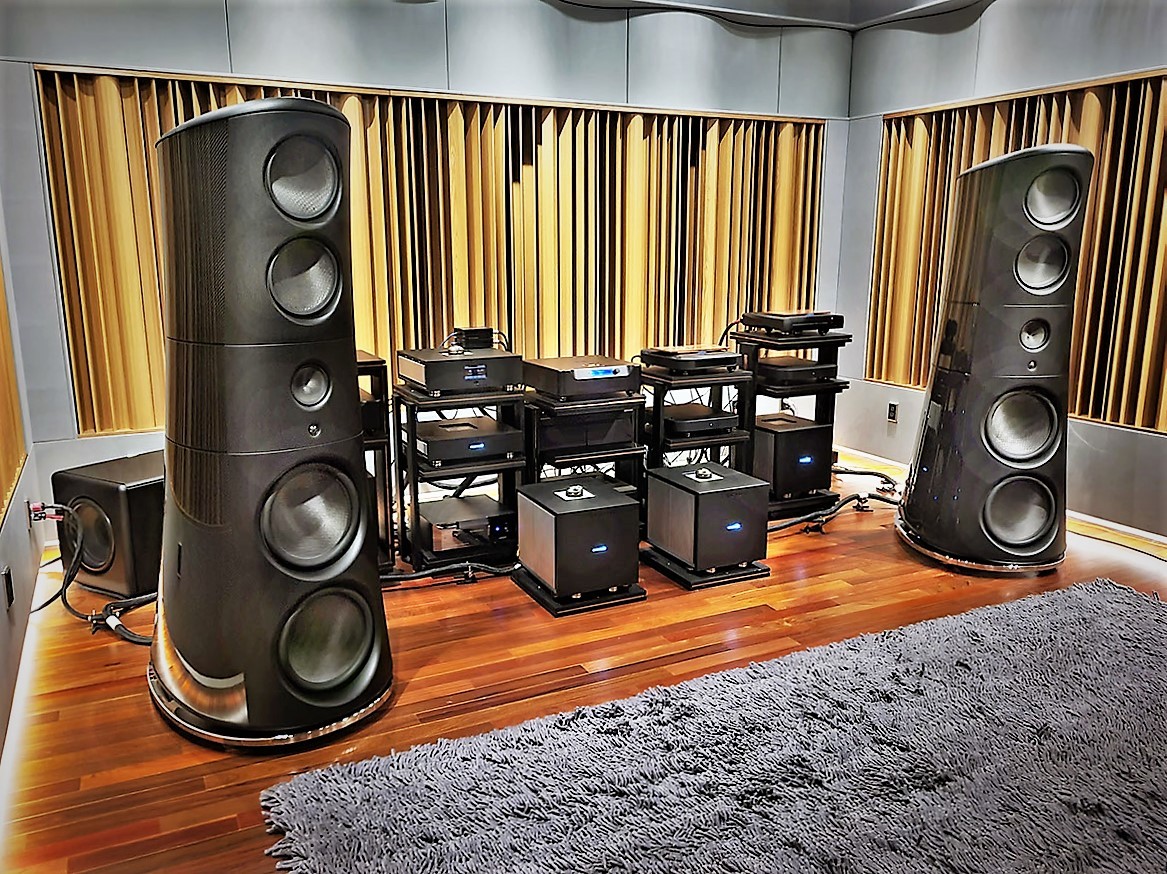

one question i always asked to myself, what pros and cons are those waveguides at midrange, bass driver in some designs.
ok, this is a real expensive speaker (something for the eyes ; ) , but i saw this at cheap shoutboxes also.
so, benefits more directivity in front of the speaker ? and still using a rounded baffle ?
only for looking fancy ? makes sense ? better for positioning at wall ?
we all try to flush mount our drivers to avoid diffraction, this is looking to me as it would create diffraction. or do they not ?
help me to understand this 😉

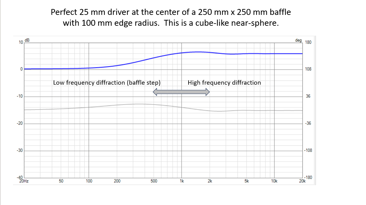

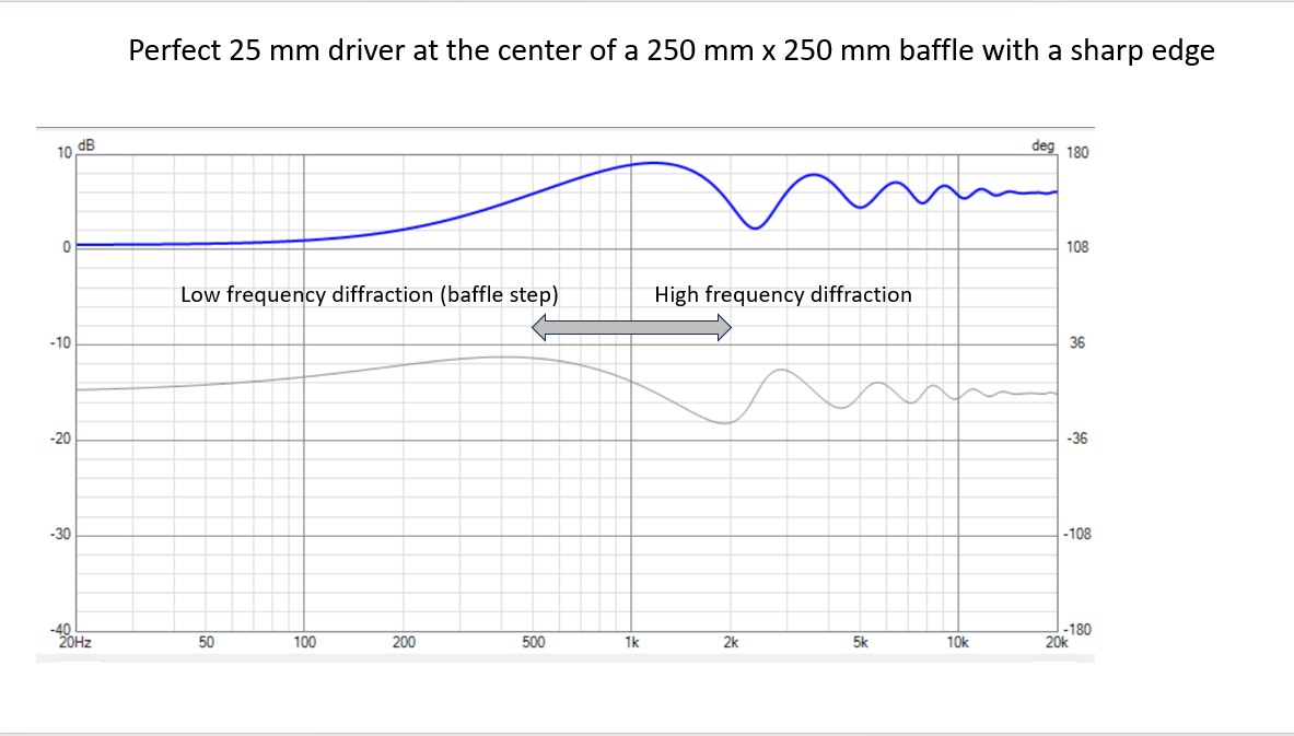

As Allen said, a sphere does have diffraction. Diffraction is what causes the transition from 4-pi to 2-pi radiation (the baffle step). What the sphere has going for it is that it has minimal high frequency diffraction. The high frequency diffraction takes place above the baffle step transition frequency. It causes the bumps and dips in the frequency response.I was watching a youtube video and that person said that the best enclosure shape is a sphere due to no diffractions? Is this true?
A quick example... a picture is worth a 1000 words
I'd argue that the higher frequencies still diffract, only their nature is changed.. and that frequency response variations can be a poor indicator of a diffraction problem. Temporal and spatial effects are a part of the bigger picture and are often not considered.

From the picture;
I don't see ANY waveguides?
As for why the woofers are mounted the way they are.
Knowing this industry extremely well. 99% is pure looks and/or beneficial for production.
Keep in mind that not everything is audio/acoustic related.

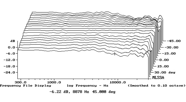

Sort of interesting debate. Magico speakers don't have waveguides as I see, but the box contour, bevels and roundovers help smoothing out diffraction ripples in responsse.
Multi-way speakers set some challenges and some benefits to the designer, which means whole lot of compromises. In my experience frequencies around 1-2kHz are most difficult to handle well. Magico M-series performs pretty well!
Here Stereophile measurements of M2 https://www.stereophile.com/content/magico-m2-loudspeaker-measurements

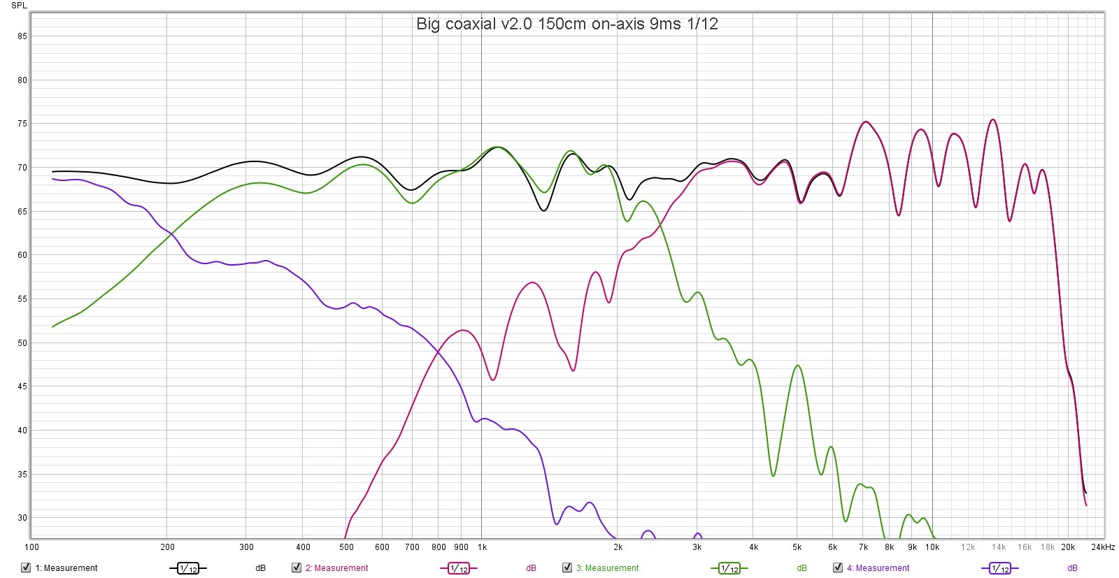

Here my test of wide baffle proto with recessed 12" woofer with extra edge contouring https://www.diyaudio.com/community/threads/big-coaxial-with-rcf-cx12n251.393313/page-4#post-7219975
and final outcome without foam ring, as a compromise...

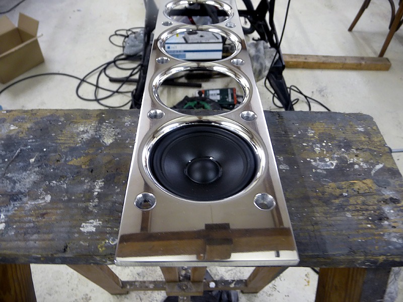

Yes, it is.Does that even include the frame of the driver?
Just look at that even and wide horizontal polar response (although the measurement is just up to +/-45 degree but still, wow!):
