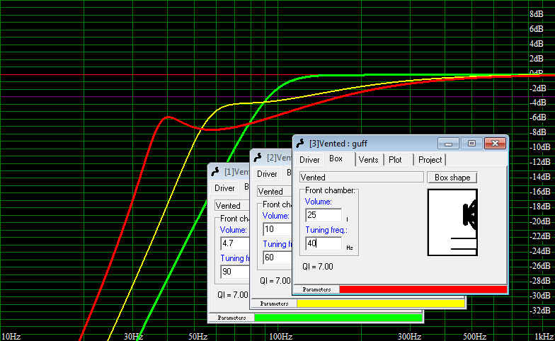

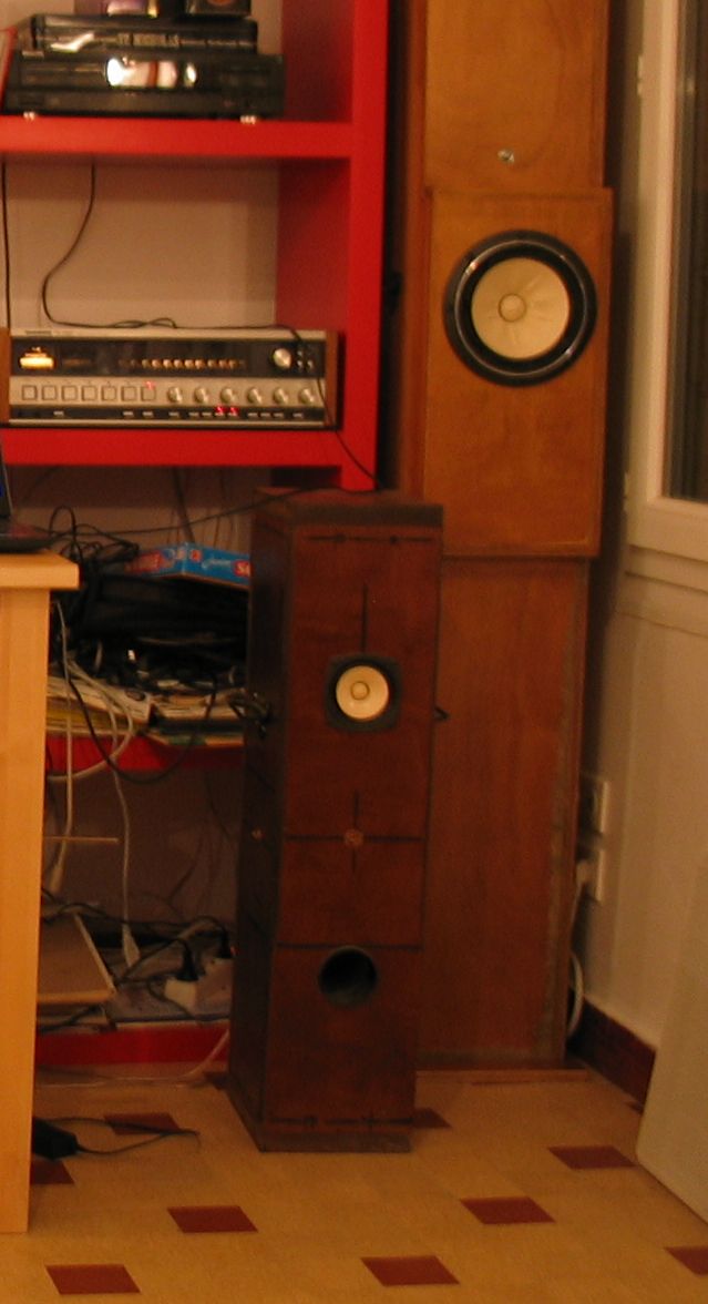

hi,
i dunno exactly what are the differences between these concepts (so you know how ignorant i am)
my fe103e single driver speakers are fatiguing because of exaggerated mids/hight frequencies
so i suppose i must digg there
enclosures are 25 liters , vented
what circuitry should be recommended?
thank you
dondiba

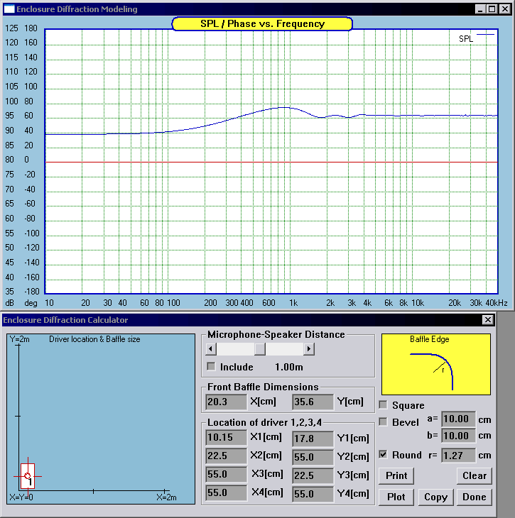

Above is the simulated ripple of a little over 8" wide baffle, with a 5" driver
and rounded edges. In your case ripple will be more due to the straight
edges and the use of a smaller driver (that increases ripple).
You might be looking at about 12dB gain, 100Hz to 1KHz, taking
into account some room gain, nearer 15dB anechoic probably.
rgds, sreten.

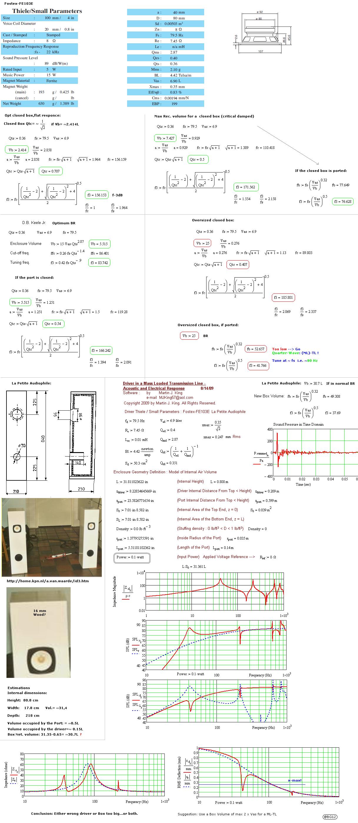

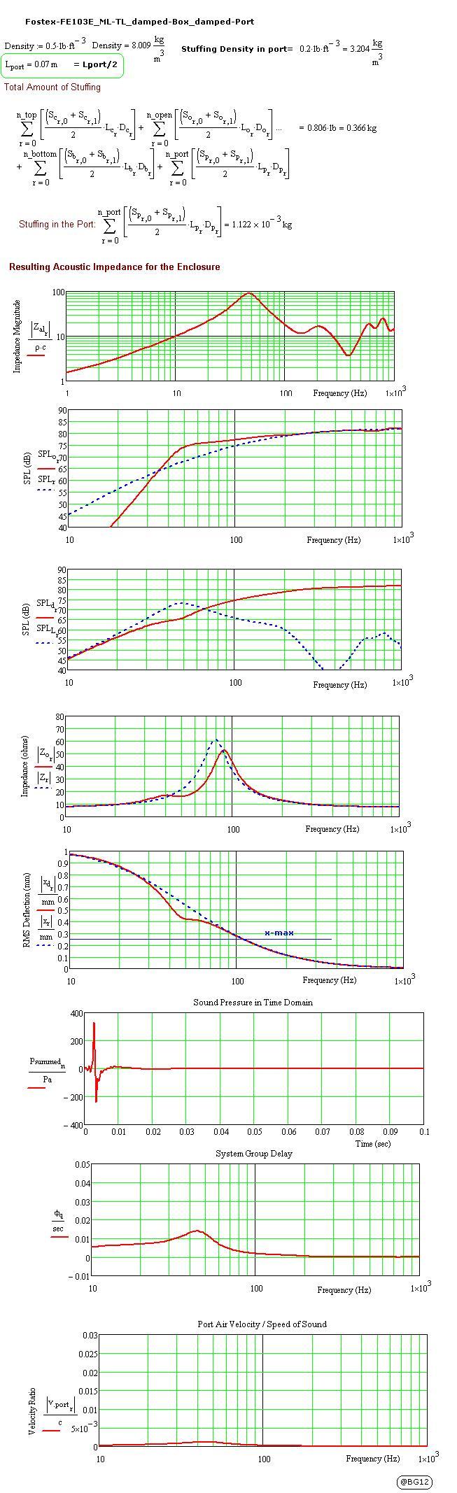

Agree with sreten.. First try to put some damping material into the port, reduce the port length too.
Hints on how much in the submitted picture:
b🙂
hi, why not ,
make a 2nd hole above the fostex' and closest as possible for a 2nd driver,
otherwise the precision of imaging would be impaired;
the 103fe and the aura are 8 ohms ,so in parallel the 'impedance' will be half, 4 ohms, i suppose, still drivable by a SS amp
could be fun but the enclosure is glued + screwed + braced very strongly...
so, i'll try to reduce the port first, it's easier ;-)
regards,
dondiba

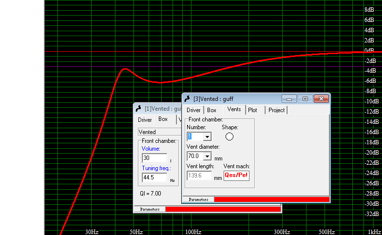

Lining the port reduces the tuning frequency, reducing its length
increases the tuning frequency and is generally a very bad idea.

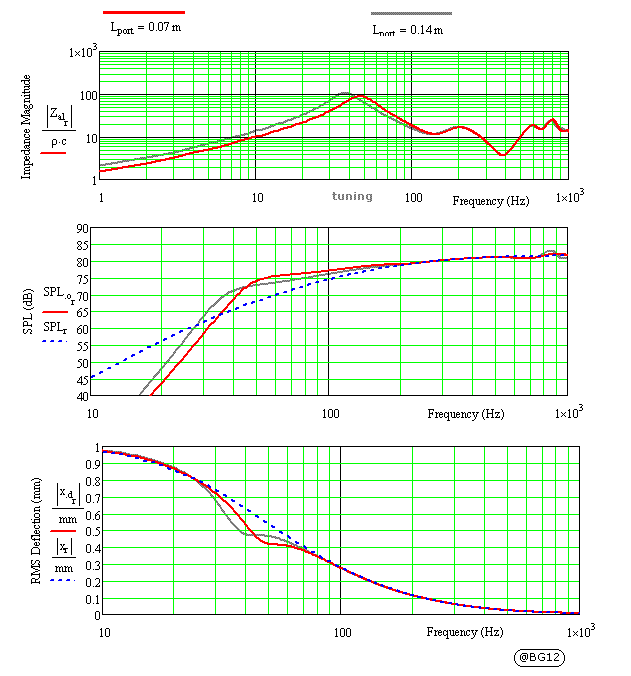

FYI:
The difference of using a 14 cm long port versus a 7 cm, both damped proportionally.
b🙂
Your damping criteria is very obscure and hard to relate to practice.
Whatever number your playing with there seems no related practise.
I can't see the system the two cases are applicable to.
Lining a 70mm port with 6mm foam will reduce nominal diameter
to about 60mm and damp port modes. I can't see how you can
model this, I do it and it works well quite often. 1 cm foam in a
70mm port ~ detunes by half an octave, but can't be modeled
well as far as I know, its generally suck it and see, or measure.
rgds, sreten.
Obscure 😀 See*

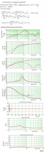

What Port modes?. I see only quarter-wave modes related to the entire length of the airways where the port contribution is minimal.
model this,
It can easily be modeled by using suitable acoustical engineering
methods. The math can for example to be found here:
http://grputland.com/files/thes.pdf
I have access to the appropriate tools for this but showing these here is way above my commitment to help DIY:ers.
* Rather the opposite, I submitted all the numbers needed for an successful damped box/damped port design, here is more:
Select (dedicated for speaker use) a lump of modern ordinary fibrous damping material with the given weight of~ 1gram for a 7 cm long port.
Compress or tear the fibers apart in order to fill the entire volume of the port.
By doing so: This would correspond to a ~ density of ~0.2 kg/m^3.
Secure both sides by using an insect screen or similar.
The fiber tangle will stay and act as a flow resistance much like the 'Scan-Speak Flow Resistance Vent'.
The wider the Port diameter is compared to the port length, the better the linearity is expected to be for this arrangement.14 cm===> 7 cm is a good way to start with.
The airflow in the port is IMO/IME very small and already as a precondition, (pre-)filtered through the entire enclosure= a fill of denser stuffing in the box, thus only a near laminar flow is expected in the port.
Look at the magnitude of the port air velocity.
Considering this case(design): Your suggestion using port wall drag coefficients is IMO only a first step to consider if much higher port velocity exists and if the box were only lined at the walls for defeating internal reflexes.
b🙂
