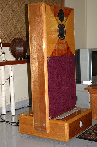

And finally, a pic of my baffles:

U-frame baffles
Hi
You chose this shape based on JohnK’s work? . . . is there a model using TS for this?
Cheers
Hi
Cheers
Hi Rick,
the frequency is a rough rule of thumb. SL actually mentions 200 to 100 Hz as the transition zone for the 6 dB gain based on empirical results. In any case it matters little whether it's driver center or boundary, given the wavelengths involved. At 200 Hz a 1/2 wavelength is ca. 86 cm or ca. 3 ft... so it's really plus minus a foot or two.
My baffle shape came about from various considerations - going for width, not depth, as shallow as possible to avoid cavity resonances but deep enough for a complete driver depth, including the woofers in the same baffle, and ease of build. The tweeter is conventional, the mid is in a 7" deep U frame, the woofers are in the same depth H-frame, very shallow indeed.
The foot houses the x-o and amps, so each speaker is a complete active setup that only needs an AC power cord and the signal cable. Mounted on rubber wheels of furniture supply origin...
Basically the shape is a mix of practical considerations and design intentions. The needed baffle dimensions were estimated using Linkwitz's formulas, and the intent was to run the mid with no EQ by having the dipole rolloff start at ca. 200 Hz where the floor gain kicks in - leaving the mid at no EQ until 100 Hz, in theory. The low Q mid (0.22) should have its first pole around 130 to 140 Hz, and I intended to use both dipole rolloff and low Q rolloff as 2 of the 4 poles of an eventual acoustic LR4. In practice a 125 Hz 3 pole HP seems to achieve the closest to an LR4, but I need to do better outdoors measurements. I first built a prototype, which turned out to measure OK for my intentions, then I built the final baffle. Asd I still haven't got around to confirm LF performance in detail by good measurements, but the dimensions are very close to the prototype.
The bass is courtesy two Vifa 10" in push pull configuration, Q=0.5 and Fs=23 Hz, EQ is currently from 110 Hz dwn or so (I keep modifying it by +- 10 Hz or so, a matter of taste really). I used to EQ down to Fs or even lower, but remarkable with music it made strictly no difference if I cut it off at 40 Hz. So, to save on excursion needs, I now use 40 Hz. I am toying with the idea of an 18" pro woofer, it would fit perfectly and give more volume displacement and possibly sonic benefits.
Software: I mostly use Audiotester, and have also started to play around with ARTA now. But my main problem is really to find a suitable measurement location , my outdoors is not quite large enough (small yard) and way to boomy in the lower octaves (city hum) , say in the 50 to 300 Hz region where you can't do any meaningful windowing, I get too much background noise outdoors and due to the large baffle, and the dipole, I can't just do nearfield measurements (at least not for optimizing the X-O).
I used almost exclusively SL's materials to learn about dipoles. I learned about JohnK's approach at a later date, and also about The Edge. Honestly I think SL's material ought to be absorbed first, then you might add alternate visions and ifs and buts.
In the end much of it boils down to personal tastes and trade offs anyway, AND, hard to stress this enough, to know what and how to measure!! That's actually the hardest part. Software and mics are not enough. You must know enough theory to know why you are getting what you are getting, in measurements. And simulations are just not enough, the deviations from reality are too large.
