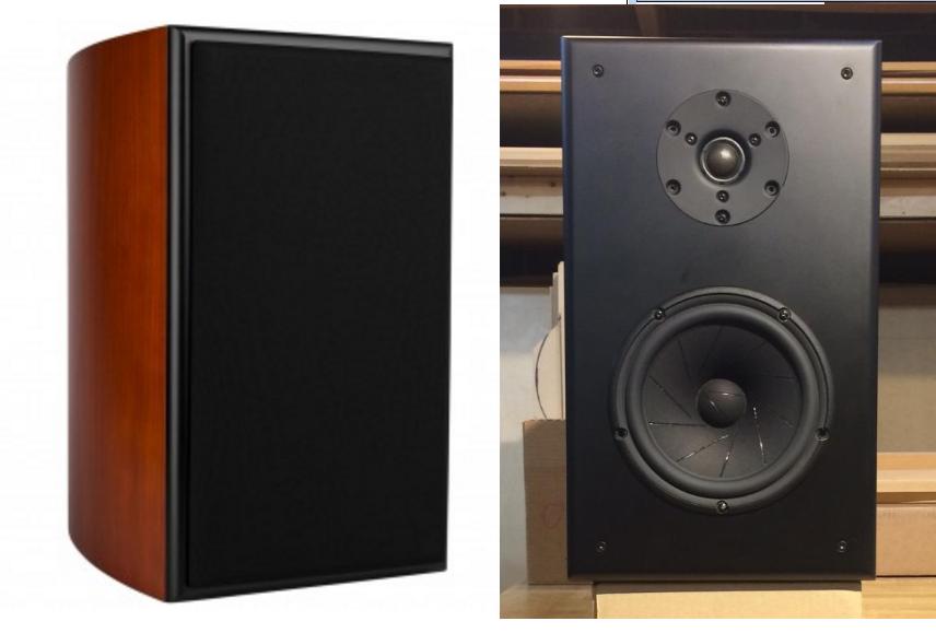

I've been ramping up the shop to cut precision cutouts in baffles.
And something that I didn't know until recently, PE has a nice selection of pre made DAYTON Cabinets, with removable fronts and grills. [extra parts available also]
Sharing this pic that might help others, because cutting pre-finished material does has a few challenges.

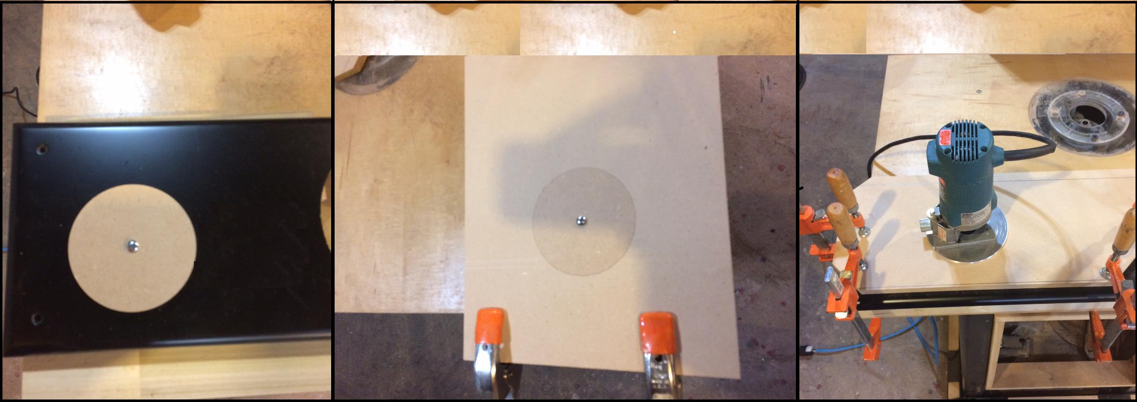

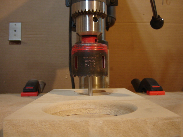

The idea here is to cut the thru-holes first, I use a drill press with a wing cutter.
Secondly, made a two piece adapter ring, the speaker could be used, but for this project, no speaker drivers -- only measurements from the manufacture.

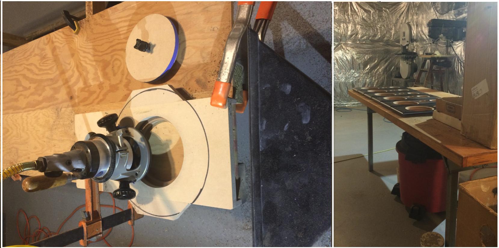

Third, slip the template over the centering adapter, clamp, removed centering ring, and router cut the lip for the speaker flange. I prefer to make the
lip cut the last step, less (or no) tear out, and the bit will last longer.
To set the router height, cut/rip small strip of wood to the desired height.

Wing cutters, collected about a dozen, found a sale on lathe 1/4" x 1/4" x 4" replacement cutters. They can be easily ground down, and/or turned/flipped to cut holes, or circles. Safety tip, slow speed only!!
PE baffles, 1" mdf, so there's going to be some nasty dust to consider when cutting.

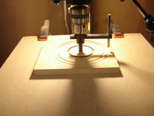

Couple of thoughts to add here.
Shown in pic one is the Stanley 04-419 large circle cutter, best to flip it around and use the 1/2" side in the stock - pre drill hole 1/2". This is the best that I have found.
That said, use a steel shaft in ALL circle cutting bits/tools. Using a drill bit as a center pivot can cause wobble problems.
