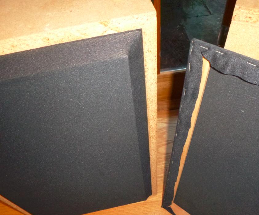

If you don't mind the look of it, a few strategically-placed nubs holding wrapped grill cloth off the driver wouldn't get in the way much, or even a frame of stiff round wire.
Depends on the kind of grille. If you use cloth on a wooden frame (is this still called a grille in English? Not sure about it) it will surely affect the frequency response, and renders any roundings irrelevant. Of course you can minimize the effect.

The grill material is not an issue, but the frame can be a big issue. The frame can cause serious problems in the critical 1kHz - 5 kHz range. Best to not use a grille unless you can do it so that there is no increase in the baffles smoothness as a result.
Absolutely what I was concerned about - I should have articulated my question better. Your response confirms my fears. I guess this was just a sanity check to justify not using a grill (or just using it as a dust cover when not using the speakers). 🙂The grill material is not an issue, but the frame can be a big issue.

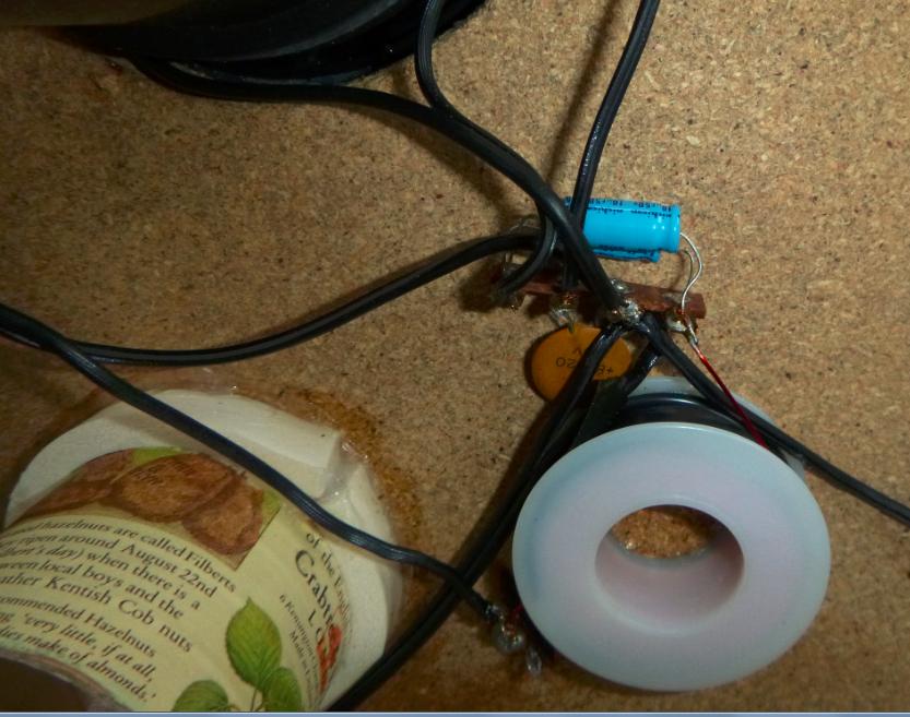

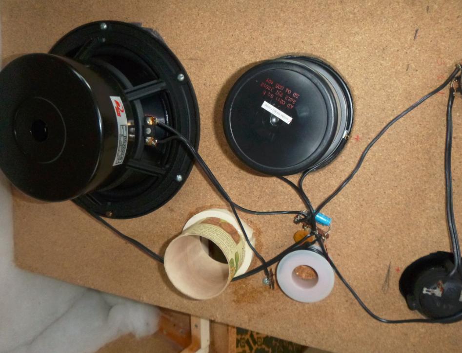

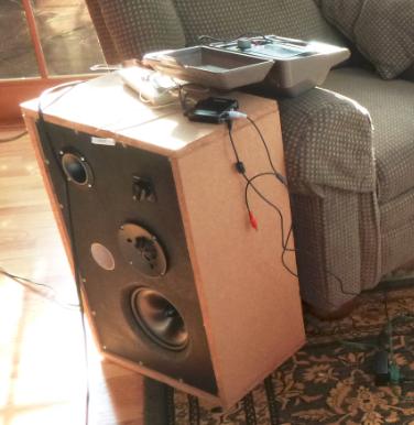

Below is a picture of 2/3rds of those speakers in their form before my son picked up my dusty 1980 copy of Weems' "How to Design, Build and Test Complete Speaker Systems" and said 'dad - build me a set of speakers like the ones you built in college'
Note to horrid Piezo tweeter, driver placement, polar electrolytic caps, 22AWG inductor, baffle edge...😱 With modern simulation tools I saw that the supposed smooth Butterworth crossover had a >5 dB dip due to my not accounting for the woofer Le. And forget about any attention to phase. Was anything right? Well - I had replaced the woofers in 2007 with Dayton RS225S models due to the rotted foam on the originals. And I did recall that the Mid was originally the most expensive part of the system at $60 (1980 $s that is) as still sounded good to my ears. (It says made in Belgium on the back, is Ferrofluidically cooled, is sealed, has an fs of 380Hz based on notes I scribbled in Weems's book and has no name)

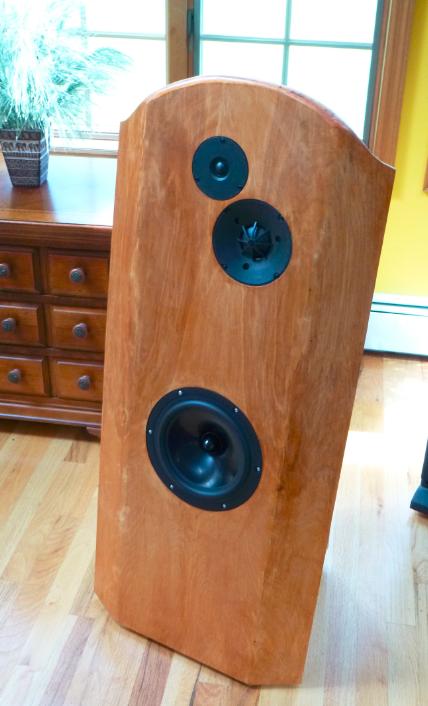

So - after building my son a budget 2 way set (that's another story) I bought some SEAS 19TFF1 tweeters, some Birch plywood, some nice crossover components to make a 2nd O LR, and converted the old beast to the picture above. You might consider it a ba$tardized poor man's combo of the Sunflower redux:
https://sites.google.com/site/undefinition/diy-sunflowers
(I took the sloped, ported bass box and flipped it 180 degrees to provide voice coil alignment)
combined with a baffle edge treatment borrowed from this masterpiece:
http://www.diyaudio.com/forums/multi-way/226914-my-refspeaker.html
that "taught" me how to bend plywood.
(So - sorry - it is not an OB design - the curves are to help the tweet and mid diffraction and because I didn't want to use birch on the other sides - built the things in 2 weekends)
Net - in the middle of the project I tested 1 of the new crossovers in the old box. Only then in a side by side listening test could I detect the >5db dip - which btw I confirmed with a home made panasonic microphone and Tombstone" software outside in my back yard. Until then I was blissfully happy with my old speakers for 3+ decades.
So - clearly I am in no position to judge any subtlety in this speaker system via the test you suggest above - though I do love the way this new version sounds, most of my fuss over details like the edge rounding are because I know it can be measured and thus figure I might as well try to address it even if I am not sure I will be able to hear it.
