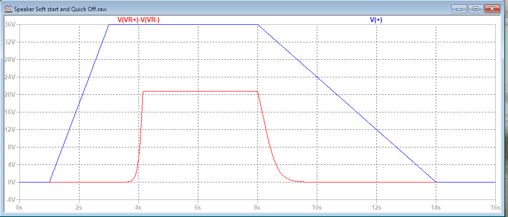

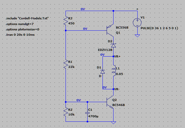

BAF 2022 Power Supply Filter and Thump Switch
On/Off
After sim, for quick turn off, the relay should have rated working voltage close to V+. By changing D2 or R10 to make the relay work at 75% of the rated voltage(70% is must on). In the worst case, the relay will release at 10% rated voltage. By doing so, It can short the turn off time.
