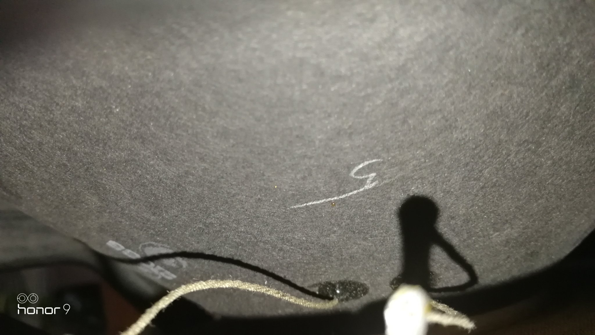

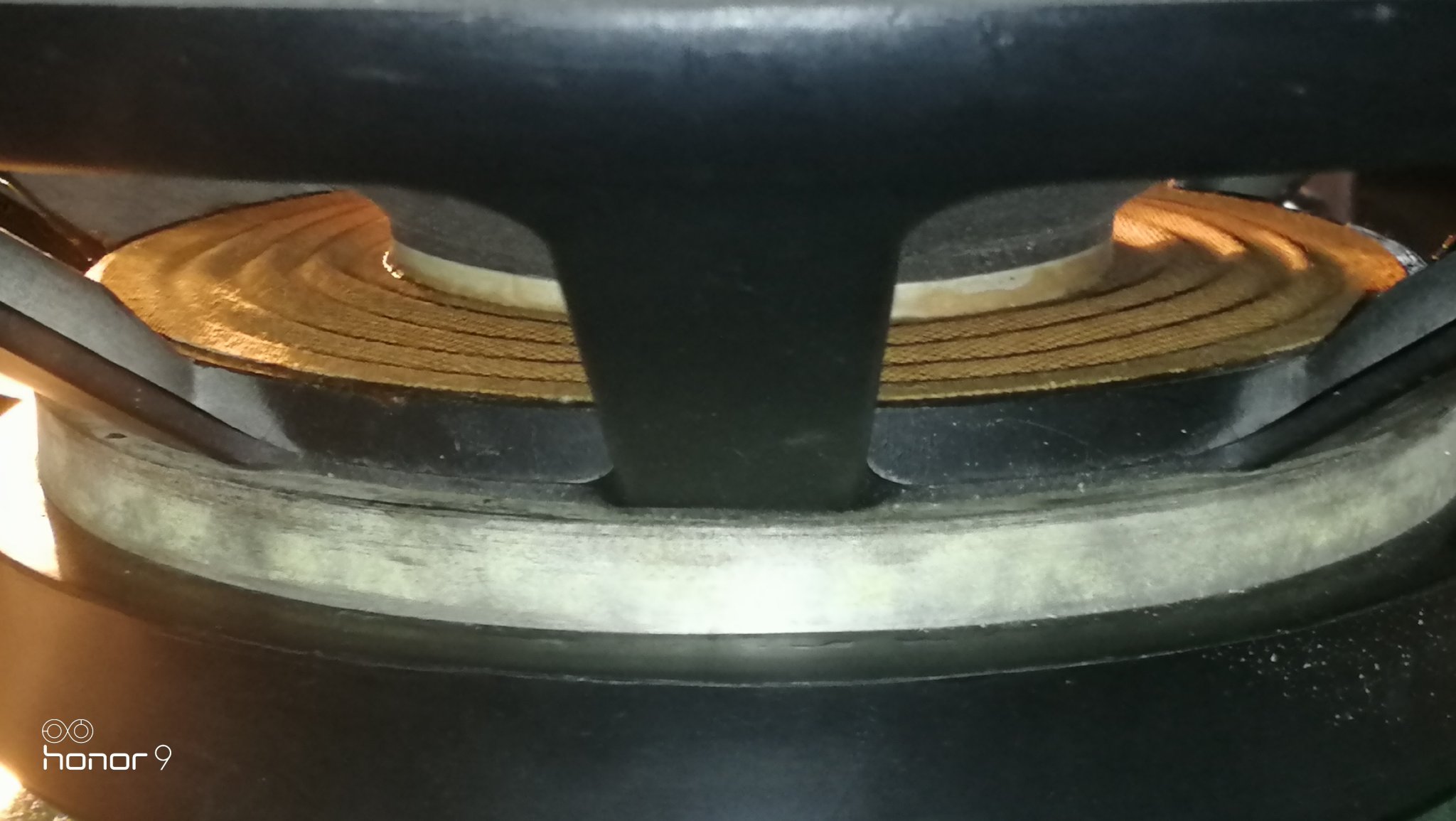

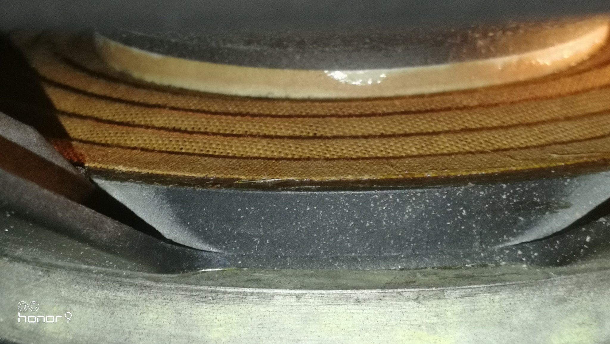

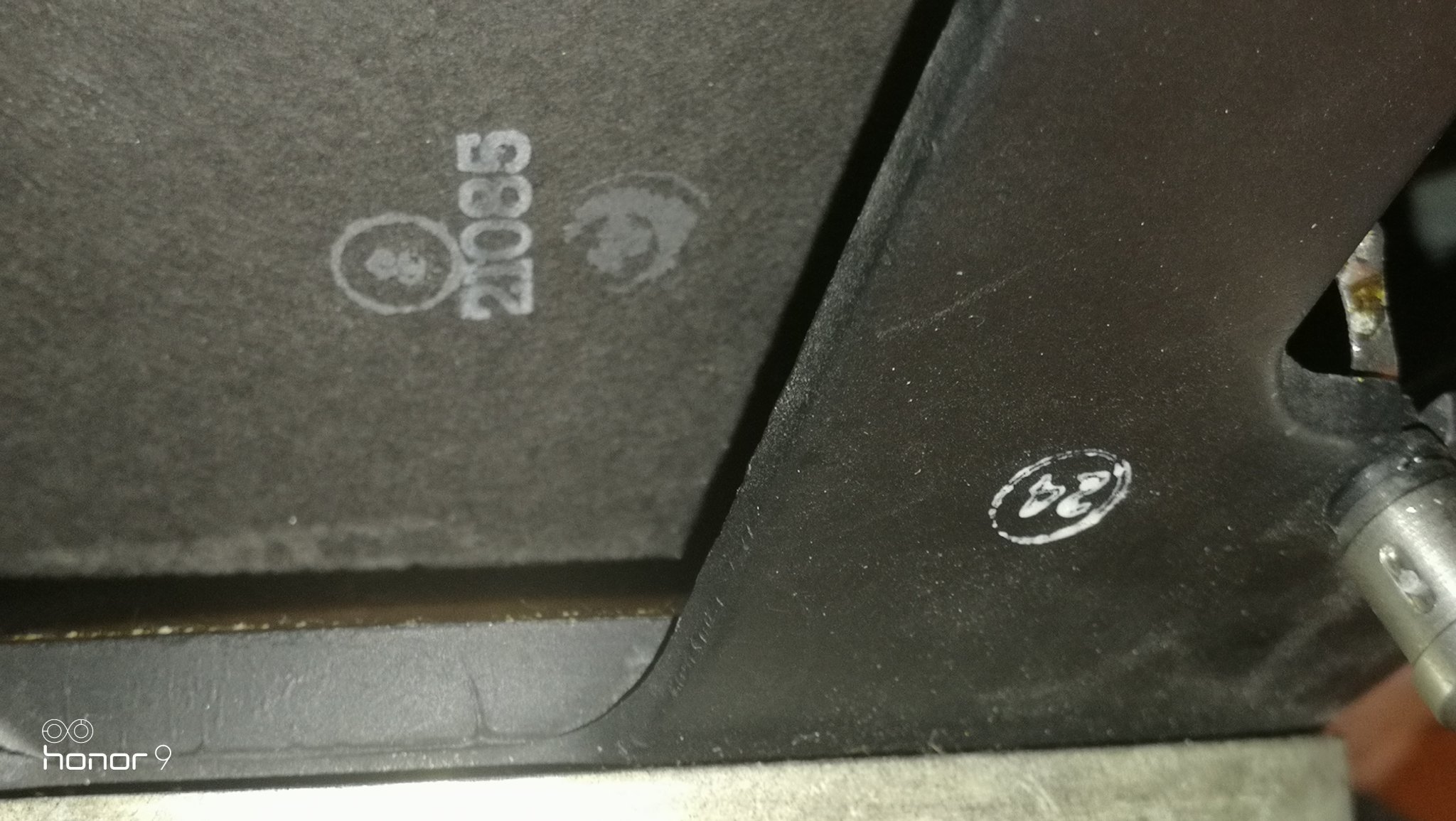

Don´t find so much prineted info on the backside of the cone it self, just the number 5 handwritten in white and the numbers 21085
Here some pics at the back at the cone and on the spider.
Anyone see anything wrong?
Regards John

I would run a finger along the spider at that area. That should fix the problem.I took it to be the outside of the coil touching a bit.
And not the way it scratch after burning a coil, that sound is more "massive"
Run a finger?
Do you mean to push gently at the spider around that area aka "massage" it a little?
Regards John
