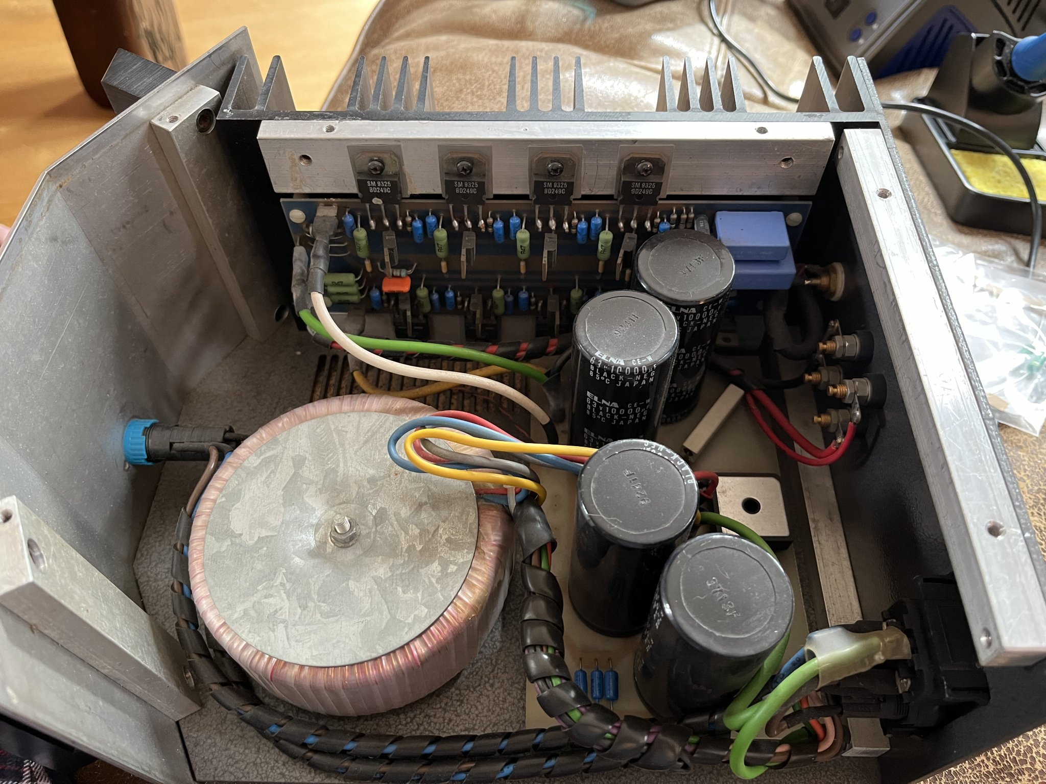

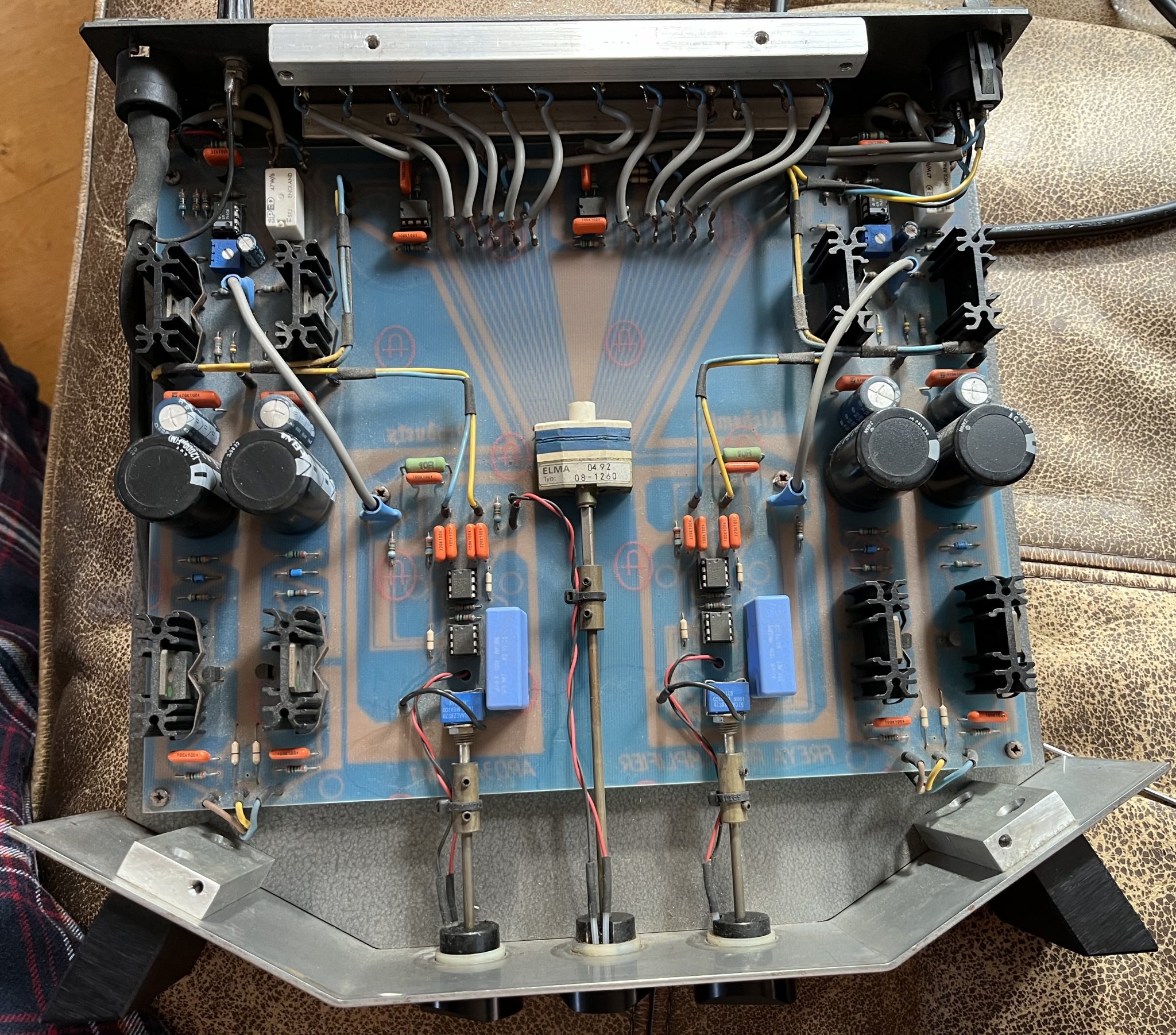

Hi gents ,
My monoblocks have the above heard through the speakers, the right mono is what I would consider a normal pop but the left mono sounds pretty bad , like a proper cracking sound . Also I the left mono needs more volume than the right mono ( the volume controls are separate on the Freya preamp )
They’re vintage British amps and look to be all original internally.

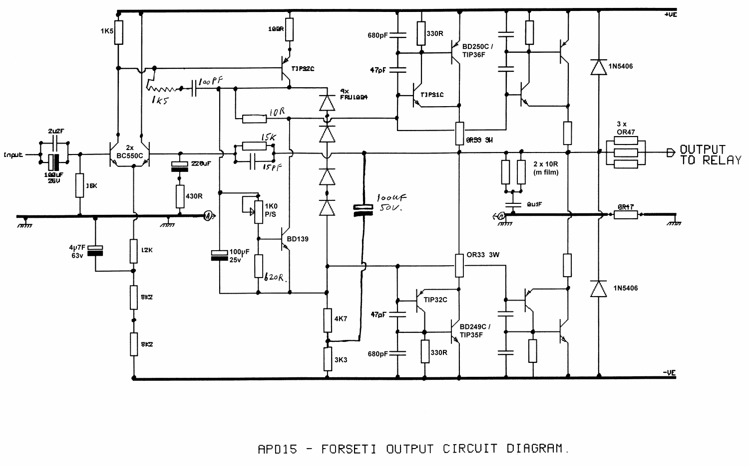

There are no schematics for them ( Alchemist Genesis)
So what should I look at replacing or testing?

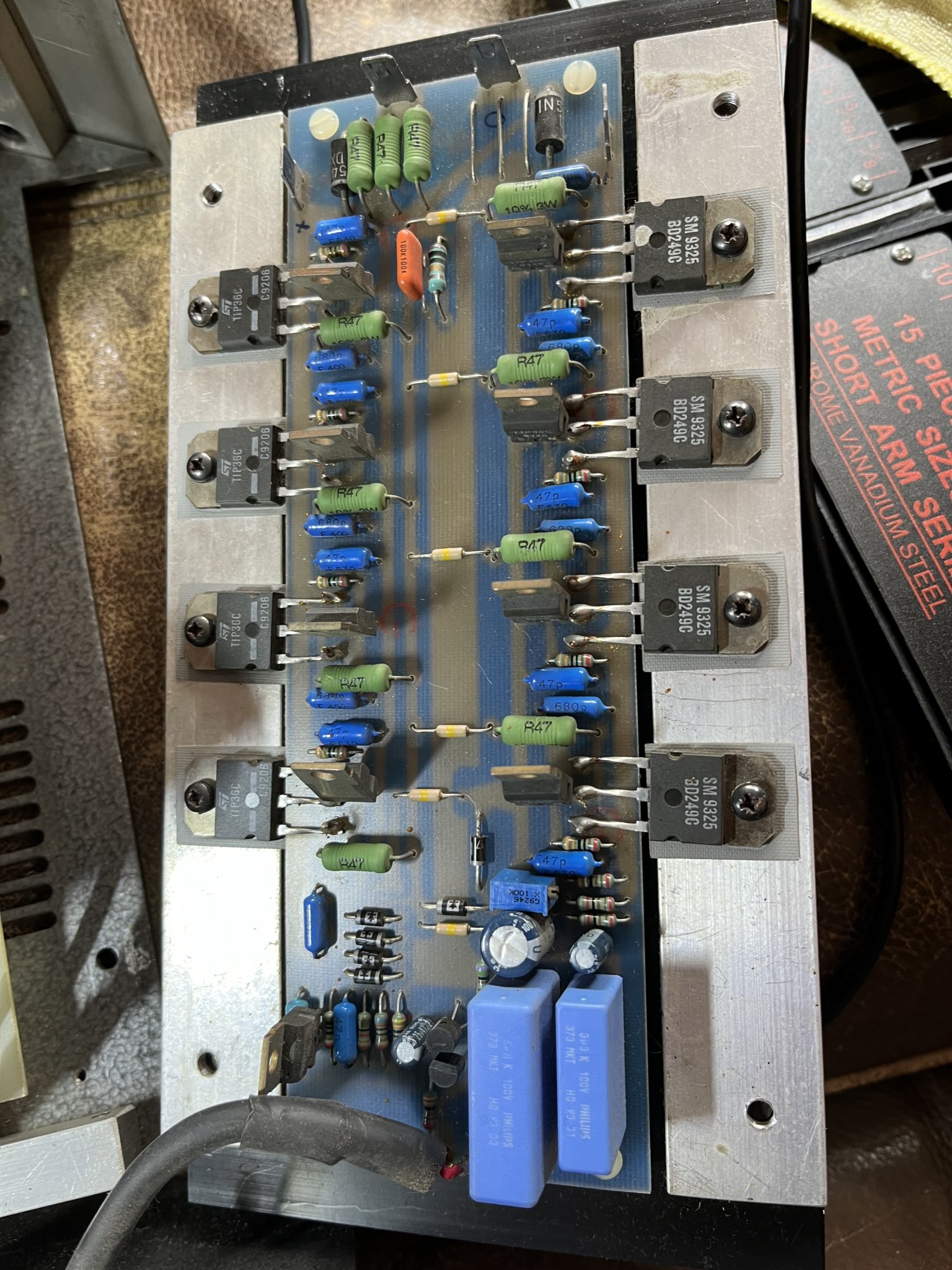

Stock photo ( I can take some photos if needed)

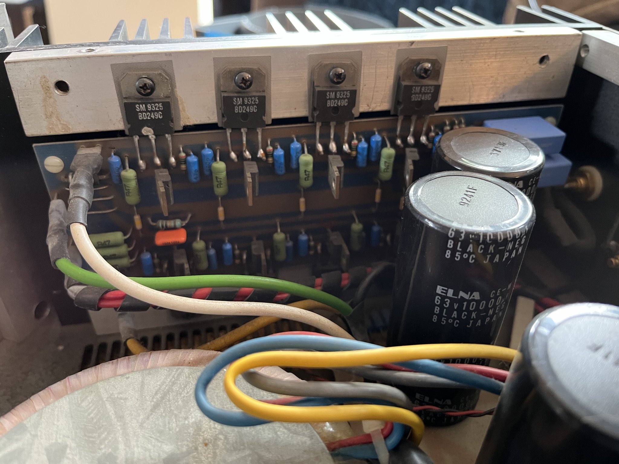

Looks the ols transistors were just "cut off" on the component side and the new soldered
to leg pieces left.
All outputs look like they are cut off but I think this is original. These BD's have pretty short legs making it impossible to bend them and reach the solderside.
Complement of output transistors BD249 is BD250, or for TIP36 that would be TIP35. Both could be original, but normally a manufacturer would stick to one of the pairs. That's all I can see. 🙂
I wouldn't worry about these output transistors for now but focus on the crackling channel.
