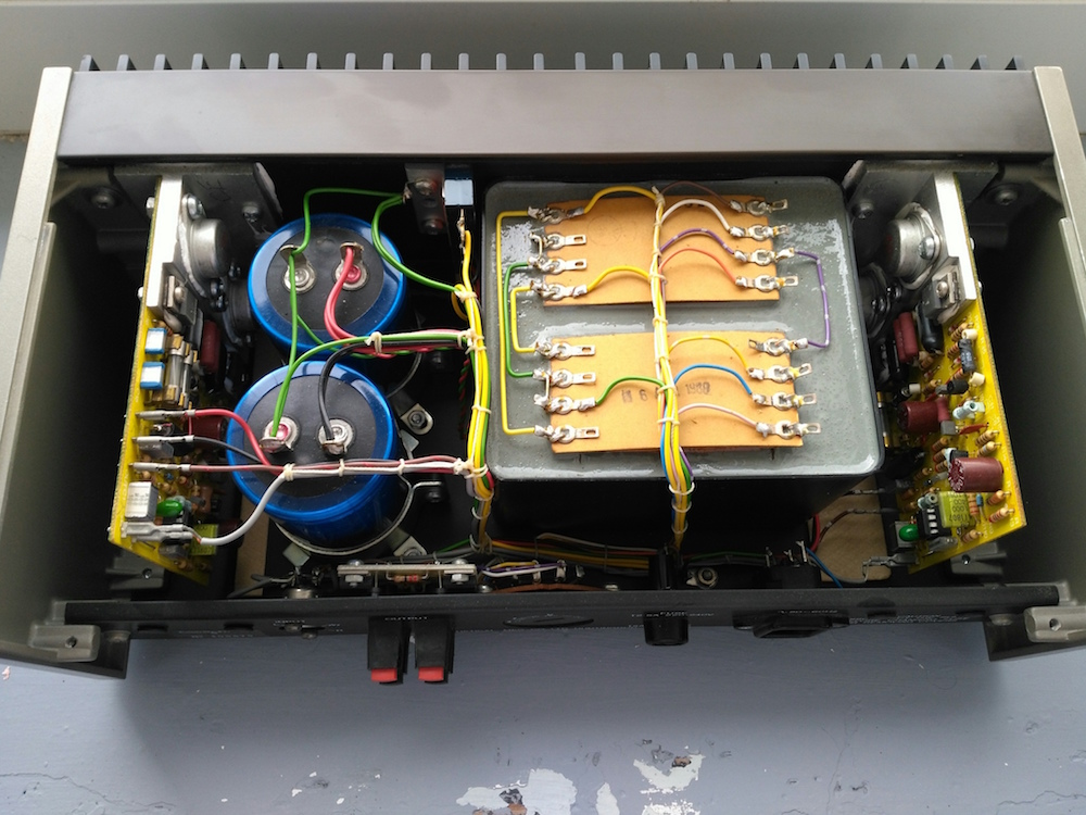

I found a Quad 405 to go with my Pass3x. It's a 405-1 born in April 1980. It was tested and it works, but the sound isn't very nice...
Nothing was changed in since it was made, so to use it I have to change capacitors, on the boards and the 2 big blue, very swollen.
I could see that, on one board, one inductor, L2, suffered. Can it be because of the bad condition of the capacitors ? The electrolytic capacitor on the boards are in very bad conditions, some are cracked on the surface, they flee and very small bubbles of material can be seen along the crack. I couldn't read anything here about these inductors on Quad 405 boards.
I choose a non-modified amp to be sure of that to do on it, and because I just want to service it, I don't want something-other-than-a-405, I want to keep it as genuine as possible.
My amp was sold with all the litterature of the french importator: the manual, the 4-years warranty, and, interesting, all the measures made on MY amp. This is not so common with a 37-years old amp.
An idea about this inductor ? I will change it, of course, but do you see why it is so damaged ?

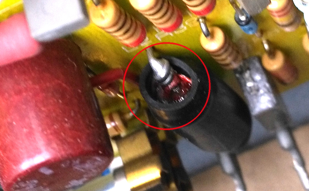

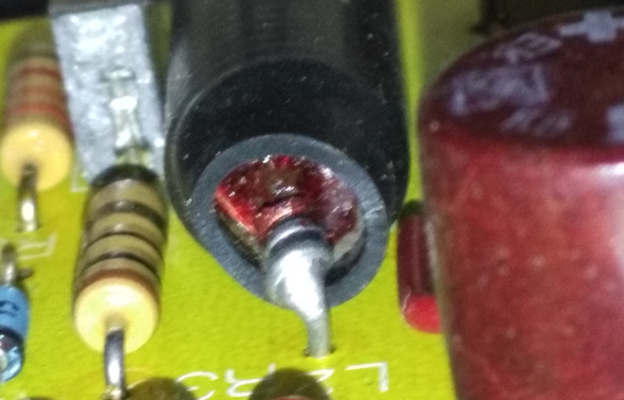

Why do you think the inductor is damaged ? (photos are very difficult to interpret when dealing with something like this)
The inductor carries all of the amplifier driving current to the speaker, but it will be only around 3uH, so it will not suffer any thermal stress, as the wire is quite thick.

Well, I'm not sure, but the end of this inductor doesn't look very clean... When I see the close-up, I'm not very confident.Why do you think the inductor is damaged ? (photos are very difficult to interpret when dealing with something like this)
It's a 3uH, 9A, dadaelectronic sells it, so I will change it, for precautions.
I would be very very surprised indeed if there were any issue with it tbh.

If the inductor still makes contact, I wouldn't replace it.

Yes, I honestly think all is OK with the inductor.
Having the original transistors in place suggests the amp has never failed in such a way to pass high current through that part... and even if it had I'd still bet the part would be OK.

by the way: agreed with others members, the inductor looks fine!

Hello,how is the condition of pcb trace under the inductor?
No mark of heat on the pcb at all.
