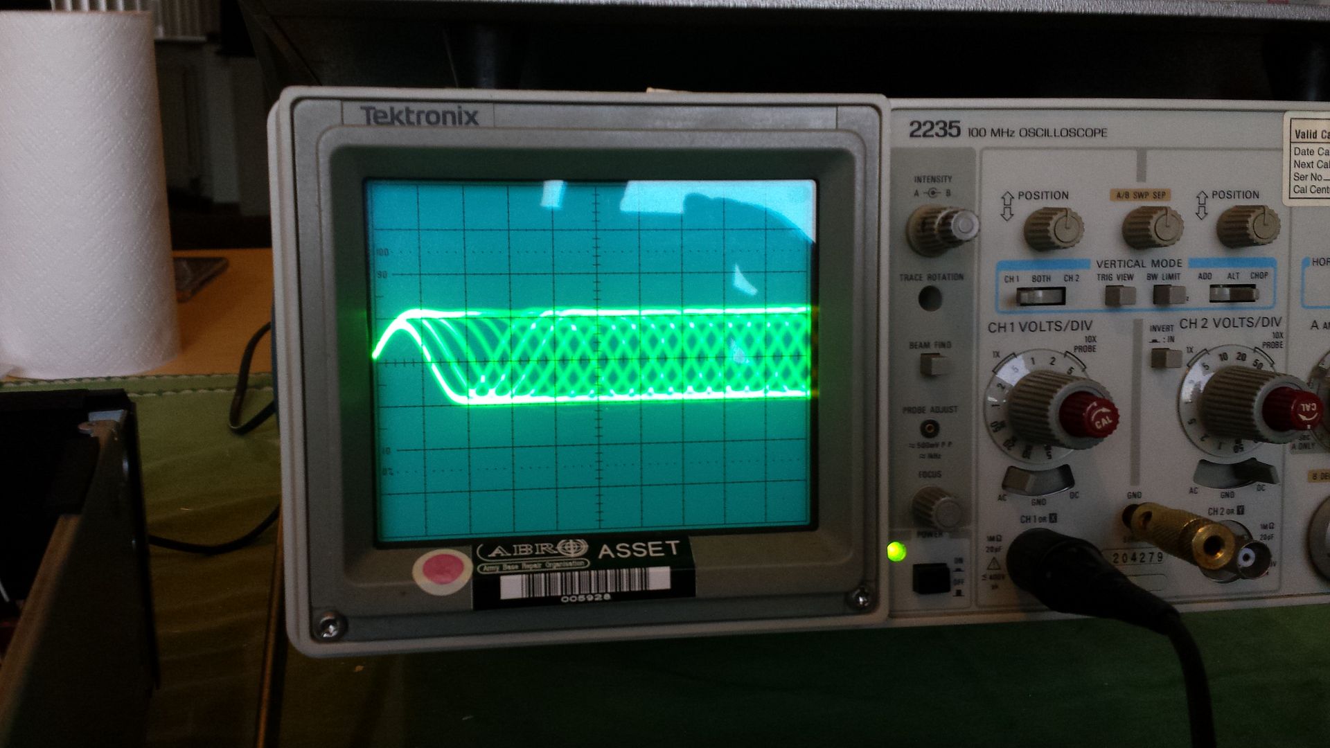

Hi diyaudioers, i'm cracking my head trying to NOS a superb Sony CDP337ESD.
First i've tryed lampizator mode with no good, as soon as i feed the BCLK signal to one of the DACS it starts reading bad, and when hooking up the second DAC it just wont read anymore.
After i've tryed another method where i remove CXD1144 but leave all the resistors on the data, BCLK and LRCLK lines, this time kind of worked but really bad.
The only thing that make it behave correctly was to touch with my finger the BCLK resistor and keep it there beign careful to not touch any ground if not the cdp behaves like theres no clock at all (CD spin backwards really fast).
I've tryed a lot, from diffrent values of resistors (and a trimpot) and capacitors in the place of bclk line to making a small transitorized signal amplifier (that went into smoke).
i'm just locked here, any help is appreciated.
Thanks!

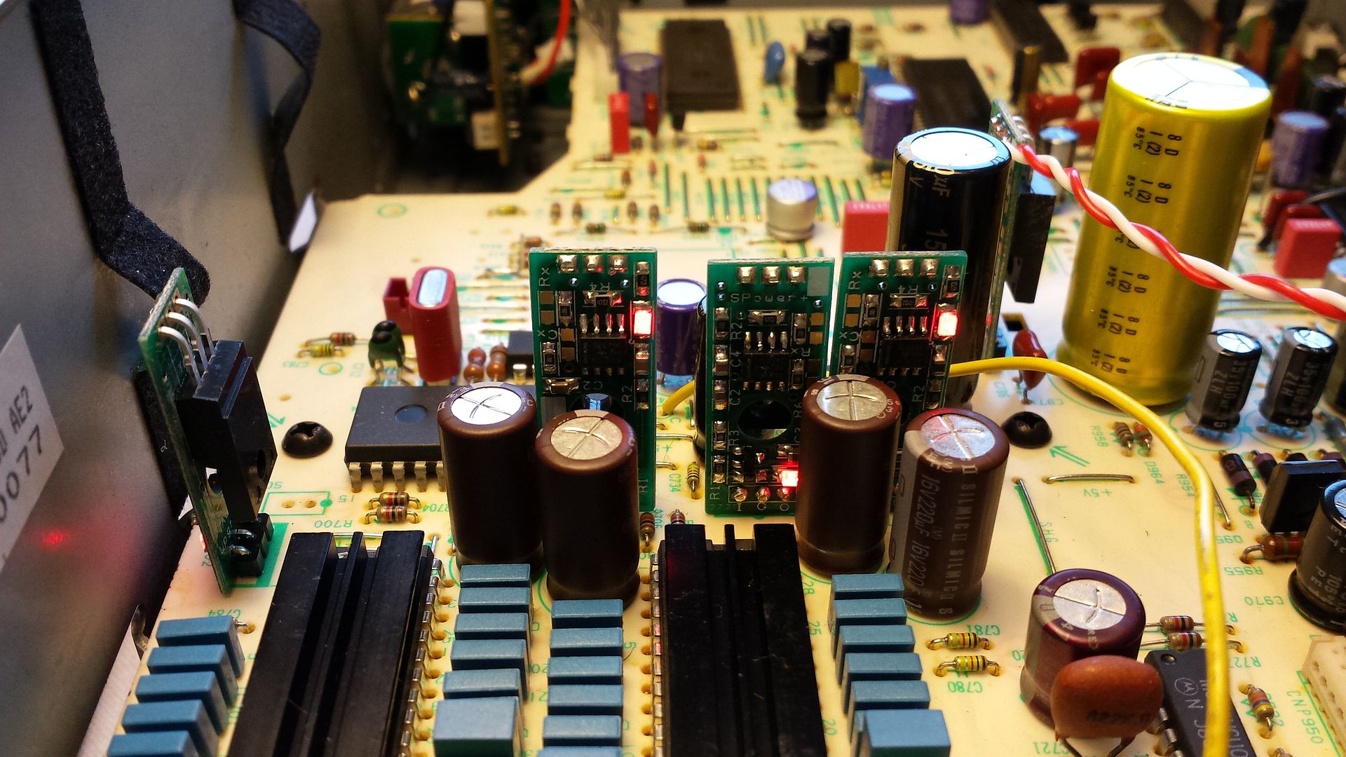

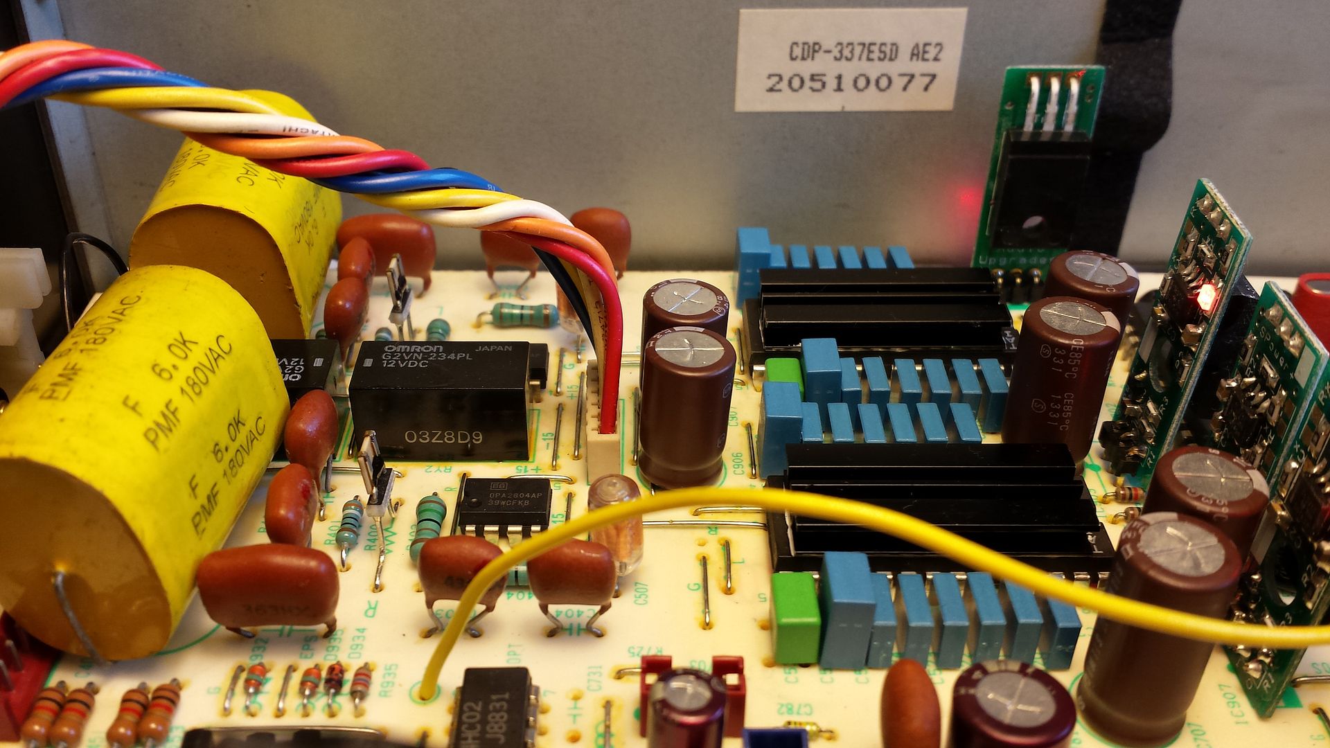

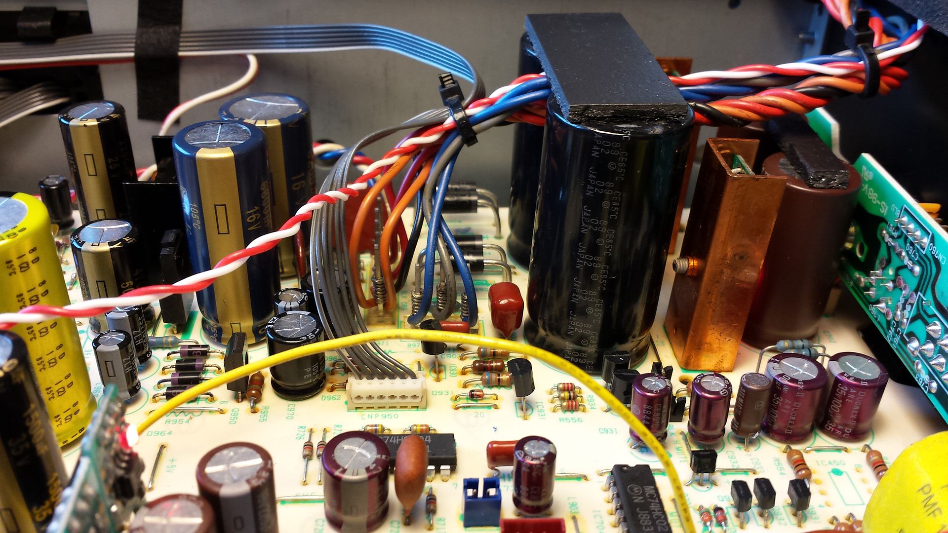

First up, here's the power supply section. As you can see I've replaced the large electrolytics on the digital power supply with larger capacitance Panasonic FC and FM. On the analogue side I have replaced the rectifier diodes with Schottky diodes. The already excellent big 6800uF Elna caps have stayed but the 1000uF caps after the regulators have been upgraded to Elna Silmic. The 7815 and 7915 regulators themselves have both been upgraded to Fidelity Audio S-power HC regs.
All four of the regs for the +/- 5v suplies to the TDA1541A DAC chips have been upgraded to Fidelity Audio S-powers and the decoupling caps have been upgraded to Elna Silmic.
The 14 bit decoupling caps have around the DACs have been swapped to 220nF boxed radial polyester expect for the MSB's which have 1uF polyester.
The DEM clock oscillator caps have been swapped to 560pF Wima FKP polypropylene film/foil.
I've also upgraded the DAC chips to 1998 manufactured Taiwanese made chips and given them heatsinks.
The resistors downstream of the DACs are Takman metal film with the exception of the IV feedback resistors which are Charcroft naked Z-foil.
The op-amps have been changed to OPA2604 and the output coupling caps are 6uF poly film with the small bypass caps removed. The op-amps power supply decoupling caps have been swapped to Elna Silmic.

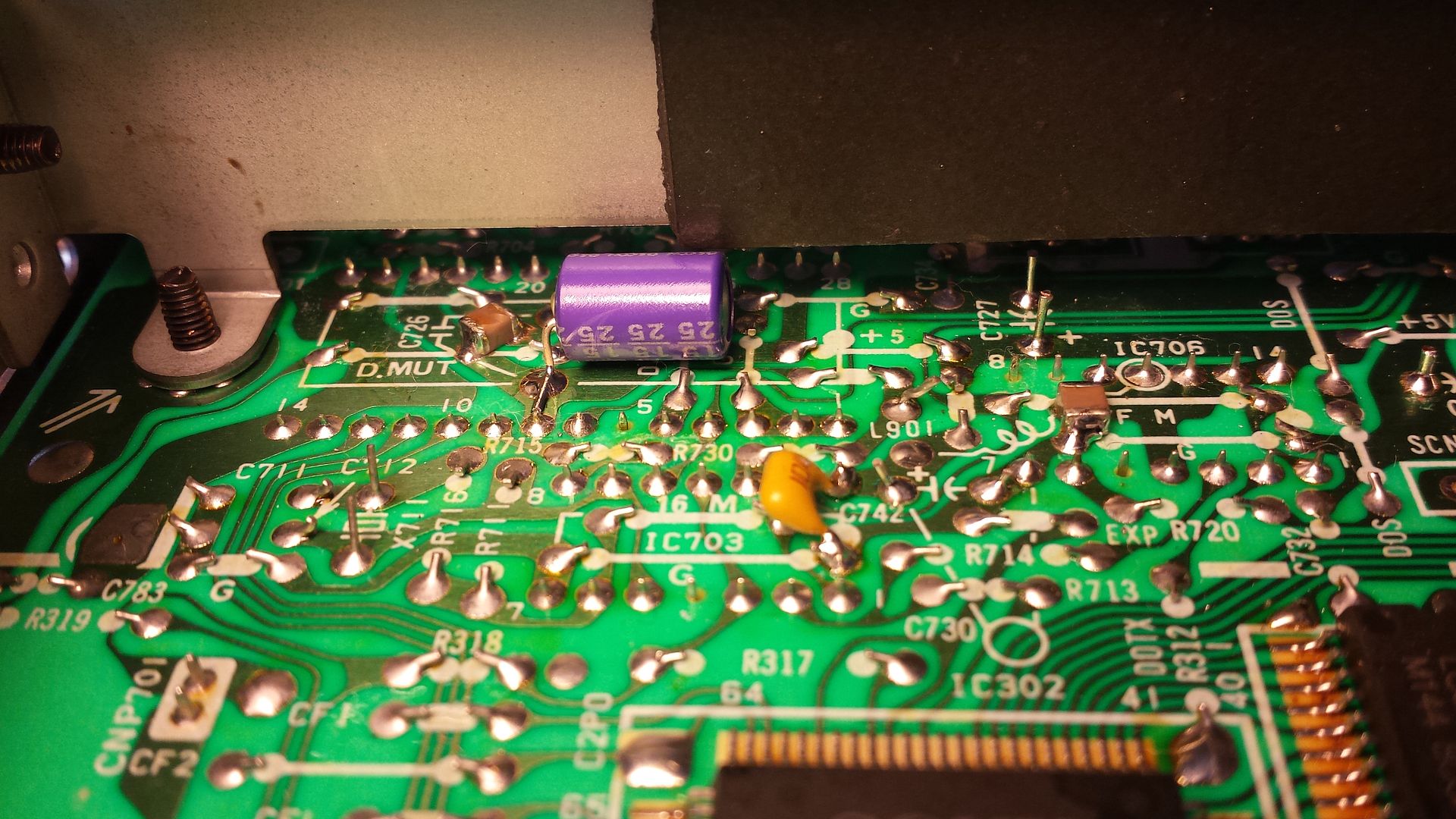

Elsewhere on the PCB all of the electrolytic caps have been replaced with top quality parts such as Rubycon ZLH, Panasonic FM, FC etc. Some have been upgraded to Sanyo Os-con if they're power supply decoupling caps for an IC.

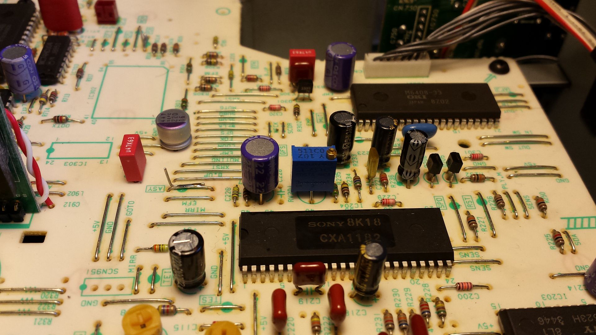

You can see that the potentiometer which controls the PLL frequency has been upgraded to a Bourns sealed multi-turn to allow easier/more accurate adjustment.

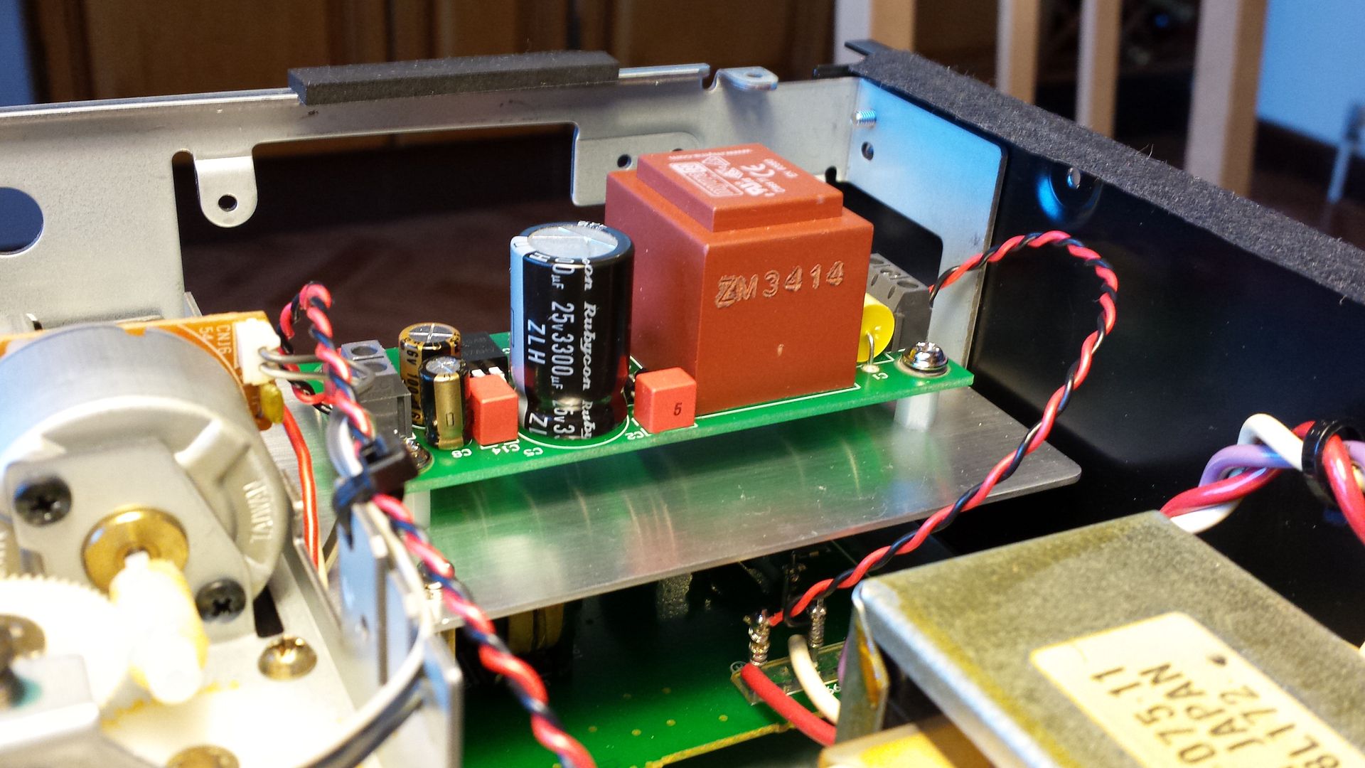

Tentlabs clock upgrade on aluminium shelf fitted to existing screw holes (no drilling!). The shelf has a self adhesive bitumen pad under it to reduce vibration.
And the dedicated clock PSU. This is a modified NET Audio clock PSU. Again on an alloy shelf and supported on brass supports which screw into existing holes.
