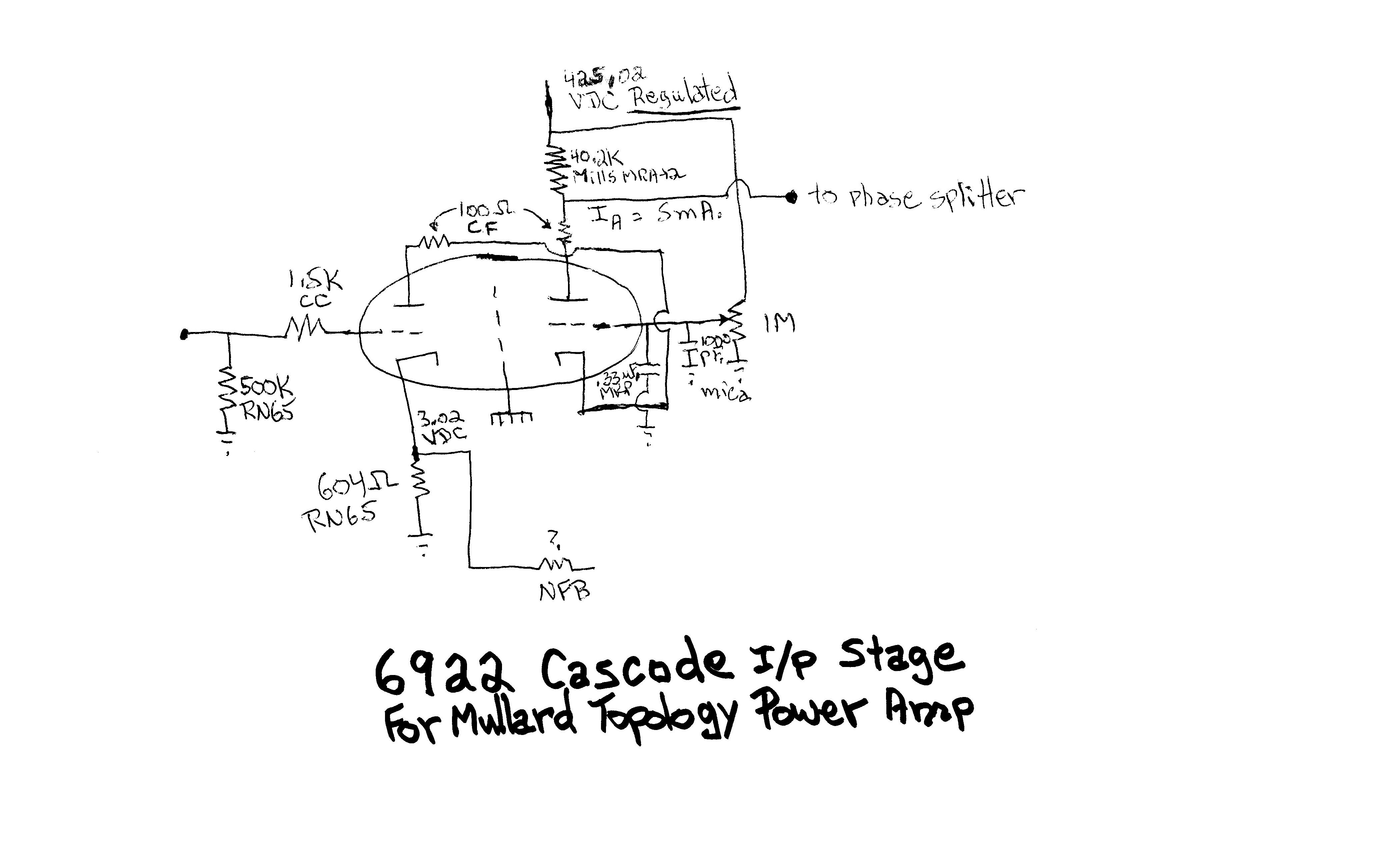

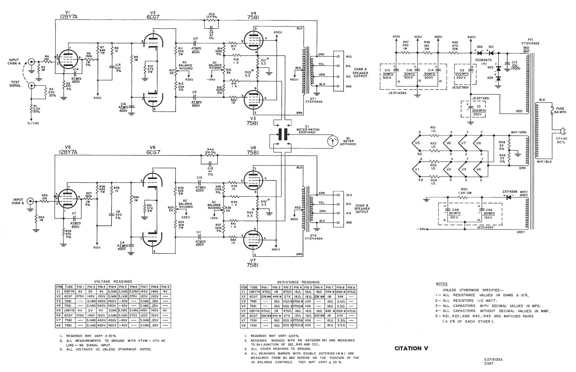

I agree with the KT88 idea. Mullard style circuitry is a good performer that's relatively bullet resistant in the stability department. So I suggest Mullard style circuitry.
A superior implementation of Mullard Topology can be found in the Harman/Kardon Citation V. Notice the use of high gm small signal types, which provide resistance to GNFB induced slew limiting. The 12BY7 shown is getting scarce and (IMO) best reserved for existing equipment. I'm providing a 6922 cascode alternative.
The ability to safely use high grid to ground resistance values with pentodes and cascodes makes a passive control center practical. Your "preamp" is reduced to source selection and level control. Nothing comes free and a passive control center is not an exception. Short, LOW capacitance, cabling between the center and power amp(s) is essential.

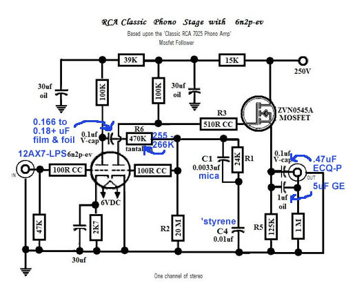

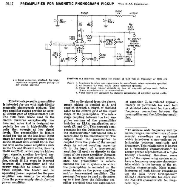

Speaking of phono sections, I've uploaded the tweaked RCA setup for consideration. As phono preamps go, it's a fairly easy build and works well.

Hi Eli,
That's an interesting little circuit. I really like that you have used the 12AX7 for this. When I get a chance, I'll put one together. I'll be using more mainstream components though.

Forget the "boutique" parts shown and pay close attention to the blue corrections. The original graphic was prepared by "Buzz", from a narrative I provided. "Buzz" loves "boutique" parts, but they really aren't needed.
The tweaks deal with weaknesses in the RCA original. Grid leak, AKA contact, bias in the 2nd gain block lightly loads the EQ network and improves bass extension. Credit Thorsten Lösch with that idea. The MOSFET source follower deals with the wretched drive capability of the 'X7 triode.

I would agree with the circuit given by Eli in his post #6, but my little deviation would be for an UL output stage to give a superior loudspeaker driving circuit - not straight pentodes. (Much background on the UL topology vs. pentode and triode is to be found on the internet, mostly sound analyses.)
Good luck there. Some of us who came from the era have long since gone on to s.s. amplifiers, but are still fond of the classic tube execution.
Johan,
I agree with the assessment that the H/K Cit. 5 is a starting point. Either UL mode for the "finals" or, if full pentode mode is retained, regulated g2 B+.
Another tweak is employing an ECC99 as the phase splitter, instead of the 6CG7. The ECC99 exhibits higher gm than the 6CG7 and will provide a bit more gain too, which should be good for KT88 "finals". Another phase splitter "refinement" is replacing the tail load resistor with a 10M45S constant current sink (CCS). Forced symmetry, via CCS tail loading, is very well established as being good.
In the H/K Cit. 5 schematic, R10 and R31 are the phase splitter tail load resistors. Those resistors are candidates for replacement by CCSes. Because of forced symmetry, the AC balance pots. are not needed. Sometimes, it is necessary to connect the CCSes to a small negative voltage, instead of signal ground. A small negative voltage "always" works.
Ultra-linear (UL) mode connects the screen grids to taps on the O/P trafo primary, instead of directly to a positive voltage. The technique is a form of local NFB that has been called partial triode.
IMO, a better O/P tube biasing arrangement is 4X individual trim pots. (1 pot./KT88). "Stand" each KT88 on a precision 10 ohm resistor, which provides a convenient "idle" current test point.
The H/K Cit. 2 schematic illustrates both UL taps and individual bias trim potentiometers. "Cloning" the Cit. 2 is not feasible, as appropriate O/P "iron" is extremely difficult to source.

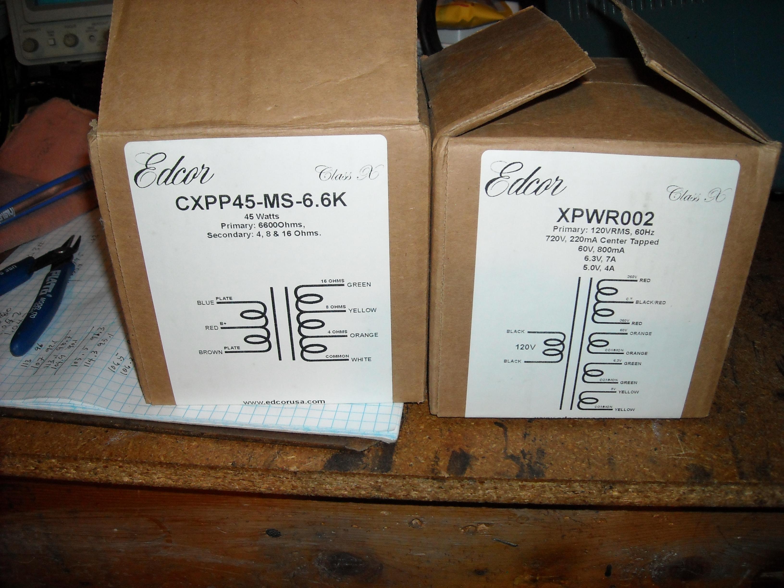

Hey Turbon, good to see you posting.
I've been contemplating something similar with 6L6GCs. I don't see much difference between them and 7581s.
I'm inclined to follow the phase splitter with source follower FET drivers.
I've got Edcor iron already on hand.
The OPTs have UL windings which I plan on using, even though they don't show on the label.
