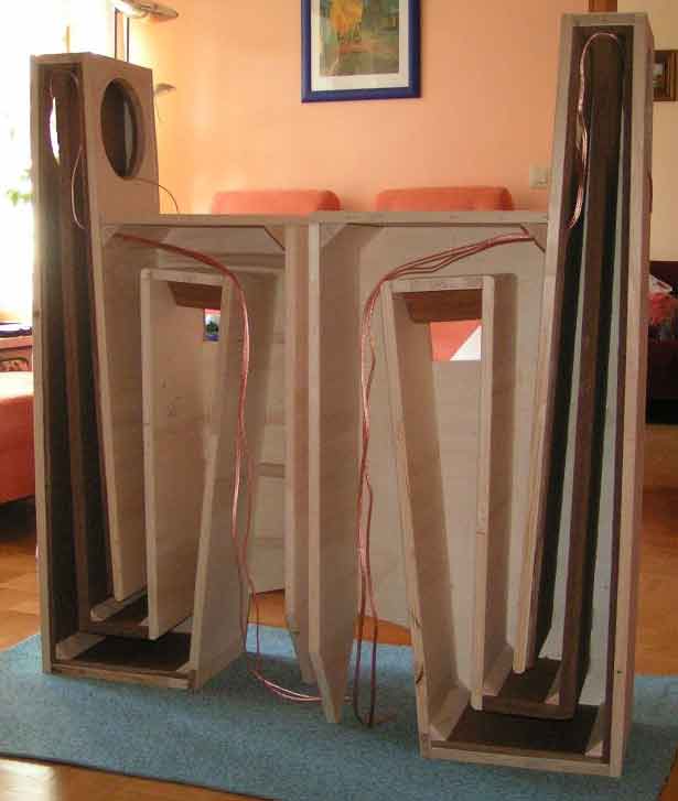

I built the fostex recommended enclosures. It is not too difficult if you can get your local wood merchant to do all the cutting for you.

Dry fitting....
Just before glueing... You can see where I did some prefinishing on the hard to reach inner pieces (the mouth)
Eventual plugging in...

Dry fitting....
