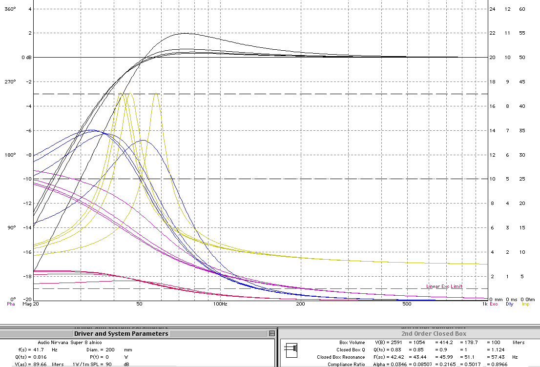

I have been many days looking for a back loaded enclousure for my pair of AN8 super alnico.
The initial project was a BLH for fe206en that are resting in their boxes. Although, my main setup, a pair of AN8 in a BR (fostex recommended) would be upgraded.
The finalist are Kirishima Manifold vs Fe208ez recommended BLH.
Would you suggest me any other option?
Any insights?

This driver is a very different beast. We modeled the Ferrite version and it wasn’t really suitable for a horn. The specs on these deviate by a huge amount. On 1st look at the Qts, it would look best suited for an OB (maybe even without helper woofer), or a big aperiodic box or a Boofle. Bigun did the latter for his AN 15” (similar kind of specs wrt box description) and is very happy.
Looks like you might be able to get away with 100 litres aperiodic or a bit smaller Boofle (at the expense of bass extention). F10 into the 20s, but room will play a big role.

Being a high Q (Qt > 0.707) driver with a 102.234Hz mass corner (Fh) & an 89.66 litre Vas the 8in AN AlNiCo is, practically speaking, not well suited to use in a back horn.
Better AFAIK to use its effective Qes [Qes'] to set the horn's mass corner, which pushes it somewhat lower to the point where Klipsch's little 'Rebel' corner horn tuned to Fs or below should in theory work well enough even if just his false corners are used. Another option would be a large DBR.

my stamped frame AN8 started with fs~42 and now fs is in the mid 60s, raising qts along with fs. IF the specs hold then there's still some peaking with a 100 liter sealed 3rd order box, and power handling quite low as 2.83v would hit around 3mm
