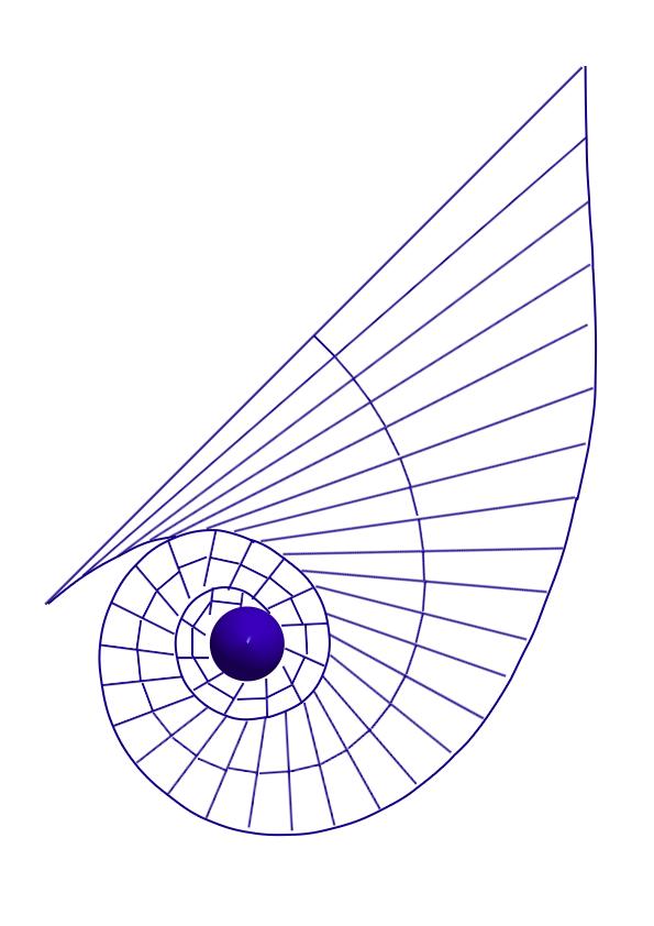

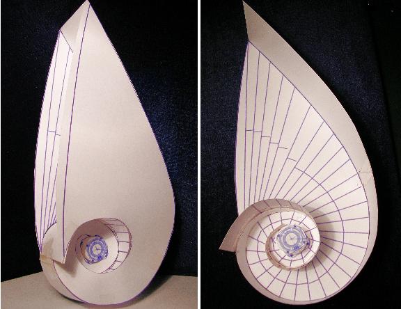

Here is a project I'm going to begin. I wanted to try a horn with a "nautilus" shape, but it's like nobody has tried this before (B&W nautilus is based on another concept).
Advantages of this design is that there are no angles, no parrallel surfaces and a very big mouth. Besides it is a "natural" shape.
See the picture attached: it is what I want to build scaled 1:20
This is a stright exponential horn empirically folded as a spiral. The circle at the end of spiral is the driver. The horn is designed to be appended to the wall. Dimensions are quite big: positioned like shown in the picture (mouth line at 45°) it is 250 cm high, 170 cm wide and 60 cm depth (just the first 100 cm from mouth, then goes decreasing to a few cm). A couple of these may fit in a normal free wall 4 m wide.
Having more mathemathical knowledge (that I have not
) would be nice to drow a logarithmic spiral matching the parametters shown below. Somebody maybe can do it?
Parameters:
Flare freq. : 35 hz
Troath area: 70 cm2 (calculated on Fostex FE206E)
reduction ratio: 4 (2 walls)
Horn lenght: 420 cm.
Mouth area : 15039.37 cm2
Mouth section: 60 X 250 cm
Mouth lenght: 250 cm (~ a quarter wave lenght of 35hz)

That's a pretty cool looking design with a VERY low WAF. You must be somebody who isn't married.
I'm not sure what you mean by a "logarithmic spiral". Could explain?
Denis
Denis
Logarithmic spirals:
a spiral is a curve turning around a fixed point growing its distance from that point at each turn.
In a logarithmic spiral this progression is geometrical and is described with a logarithmic formula.
This formula for the curve growth may be the SAME as that commonly used to calculate a normal exponential contour for a straight horn. For my empirical spiral I used an exponential horn formula then turned the contour in a spiral shape with a graphic software.
Should be interesting to have a formula for a spiral horn contour starting from the throath lenght and growing till the mouth lenght at the right distance.

Hi Thomas,
I would think your original spiral is better as it represent a coiled exponential horn. You second spiral looks like a coiled conical horn, although you probably could adjust the formula to draw a coil with any expansion you want.
Denis

Hi Denis
The coiled exponential horn is what I call "empirical" home made logarithmic spiral. Of course there must be a formula to generate my horn with a logarithmic spiral (but what?), because the growth of both, the straight exponential and spiral, are logarithmic (the last spiral I posted too).
The pure logarithmic spiral shape is a bit different, but, I guess, better, because is the shape used by the nature to fold long things (cyclones, galaxies, spider webs, nutshells..), and is new.
Do you think it will sound? What about the thickness of wood necessary for these big surfaces?

This is not a new idea, althou usually it is fitted to a rectangular box (Fostex even has a version for the old FE108Sigma) ... probably the most elegant execution is the Cornu horn.

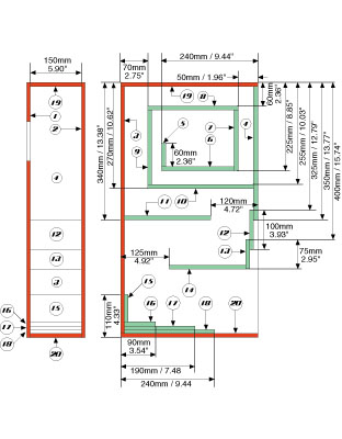

FE108Sigma spiral
Hi Dave
I've found now the discontinued Fostex FE108Sigma recommended enclosure (see picture attached). Yes, that is the concept. But it is a usual folded horn with square angles that affect sound speed.
Have you other link? Thanks in advance.

The folding might be good, but I see a problem with the placement of the driver. It's placed in somthing like a tube which will give you nasty resonances and early reflections in the midrange....
knorke said:The folding might be good, but I see a problem with the placement of the driver. It's placed in somthing like a tube which will give you nasty resonances and early reflections in the midrange....
I see ...
There would be 2 solutions:
1. The flat side of the horn must be on the front and not on the back (that's done turning on the back the drivers compression chamber)
2. I could add a small midrange horn on the driver, like Oris horns.
What do you think?

1. Then you couldnot place the horn flat on a wall...
2. That would do probably the trick...
One more thing to consider:
horns with smooth folding are said to damp midrange less, so you have a horn with a lot of midrange coming out sideways of the throat.
I would prefer something like the "Little Big Horn" from Carefrae (http://www.carfrae.com ).
They also youse the logarithmic spiral as inspiration.
But it's smaller than your design and needs a subwoofer...
