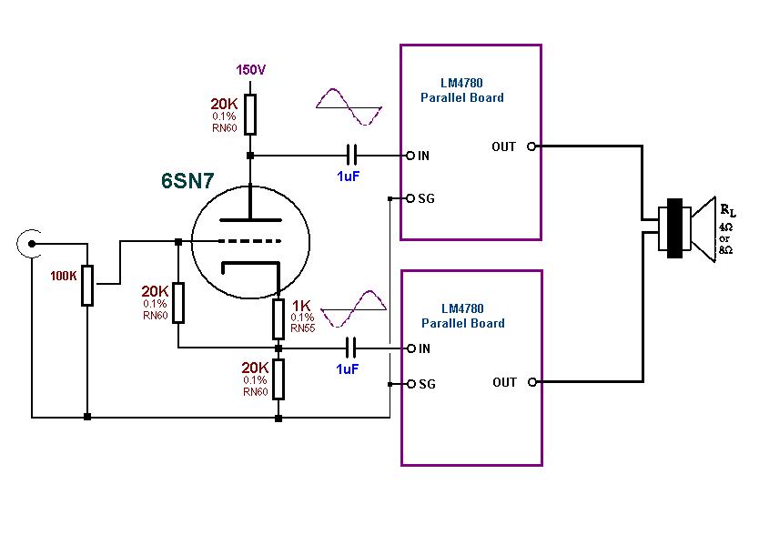

rota,
I have been down this route before. The power expected from a small SE EL84 amp and one sub is practically useless if the sensitivity of the woofer is not in line with the F/R drivers.
I am not sure of what components you have at hand but a simple "bi-amped" stereo system would probably be best.
Assuming you have the iron you could build an SE EL84 stereo amp and drive the C8MX's with that and the ECL86 amp driving the tweeters.

for a "subwoofer amp". I have joined the group buy for the Bpa300 boards. I will run them as a "Push Pull" type sub amplifier. Using a 6SN7 (or any dual triode) as a Split Load Phase inverter. PM me if you're interested in a schematic of the amp.
