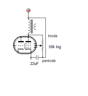

My son wants a low output practice guitar amp. It needs superb clean tones and great crunch but no fancy high gain stuff as he has plenty of pedals for that stuff...
So what to build? Any suggestions?
My inital thoughts are to use two ECL80's witha EZ80 rectifier. The two triode stages should have enogh gain with a tone stack inbetween (propbably Steve Bench's design) and run the output stage push pull triode or pentode... The conventional design would be switchable but I've been toying with using a pot. to vary the triode to pentode percentage... Has anyone tried this or have a view on how it would work - or wouldn't work! see drawing below...
Any suggestions or thoughts would be most welcome.

Are you sure you want to use ECL80s? The gain of the triode section is quite low and even in pp operation I doubt they would give more than 3w and the anode load is quite high, although the power consumption would easy be handled by an EZ80. I can recall only ever seeing one circuit using ECL80s in pp for a gram amp.
Did you mean ECL82s or other triode/pentodes by any chance? I ask because the ECL80 has a common cathode, yet your schematic shows different cathodes for the triode and pentode.

Hi Bournville,
I was thinking of using it fixed bias - with cathode grounded and the ECL80 is lower power than the 82... I am only looking for about 1Wish in triode mode and a bit more in pentode is OK... Do you think this would work?
Using the ECL82 is a definite possiblity (actually PCL82 as I can get them for 3euros)
For gain I would cascade the two triodes and use an IT for SE to PP... should be okay for clean - not sure for crunch yet (I guess I could add a pentode front end to take care of that...)
Most of the time on clean it will run at about 100mW or less into a 12" cab of 94dB/1W/1m sensistivity. It's a practice amp. My son has a 200W Hughes and Kettner system for gigging that is incredibly loud but a bit hard to tame in his bedroom 😉

ECL80s
I admit that it is many years since I've used these tubes, but I remember I did have problems with stability because of the common cathode, because the bias arrangements for the triode and pentode sections are different.
I have not used a fixed bias arrangement with these tubes so cannot comment on it - I used cathode bias on the pentode and grid bias on the triode (via a large grid leak connected between grid and cathode - I think I used 10meg!) with a large bypass cap on the common cathode resistor to get rid of any tendency to instability - 250uf or so.
Other circuits I've seen use NFB between the anodes to keep the circuit stable, but this reduces the gain, and with ECL80s there really is not a lot to play with.

Good question! I guess partially because I've using ECL82s so the ECL80 would be different! Partially because it gives lower power pp and if it's works I'll build myself one for my bass (so pp is better than se...).
I'm not wedded to the 80s so the 82 SE is a real possibility. I guess the OPT will cost more for the SE so that might tip the balance...

Hi Bournville,
Having spent my lunch break running some calculations - I can see that you are completely correct about the low gain and high Zout of the ECL80. It would be diffcult to make a good guitar amp from them...
So back to good old P/ECL82s. Plenty of gain in the triode sctions to drive a tone stack and get some 'crunch'.
I can run a relatively high Z OPT to reduce the output power and ensure that I can crash the psu rails for extra crunch too...

Does anyone have a view on triode mode versus pentode mode for a guitar amp?
How about DHT (31?) for a guitar amp?

James D. said:...but don't you think pentodes are nice for overdriven rock tones?
As I said, my favorite guitar amp uses a single 6V6 in pentode mode. I don't use many overdriven rock tones, but for clean jazz and country stuff it's the best.
I think people who want crazy overdriven distortion at bedroom volume levels need to really consider amps with a Master Volume control. Otherwise you need to limit yourself to an amp that hits the wall at milliwatts of output.
