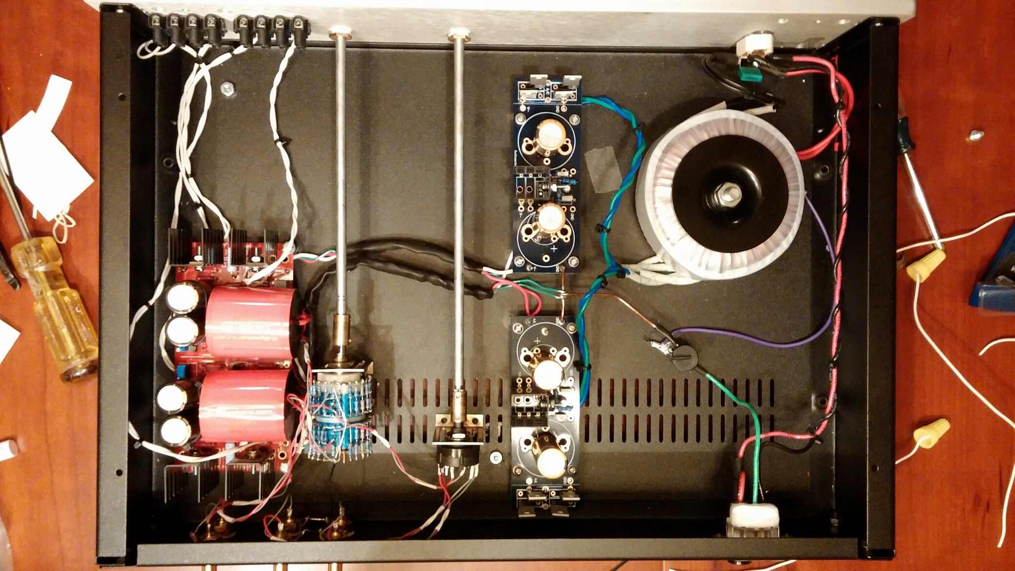

Well, I just started to get into headphones. I do a lot of computer work during the day so I bought a pair of Grados and I am starting to enjoy them.

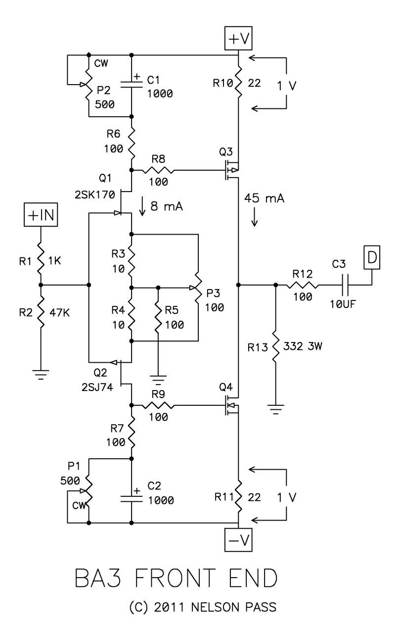

Started to look at putting together a headphone amp like the AMB B22 or a dynalo but then I realized...I am using the BA-3 front end in my main system as a preamp. Looking at some headphone amp designs it dawned on me...Could the BA-3 front end be used for headphones? My Grados are 32 ohm. Seems like it would work to me.
Anybody have any suggestions on how to add a headphone output to this thing? It has enough gain but what about current?

Thanks Zen. Well, it's going to be used as my regular preamp AND headphone amp. I was thinking of just tapping the output to a headphone jack...lowering the rails and more bias is not gonna work.
Or maybe a buffer on output?
