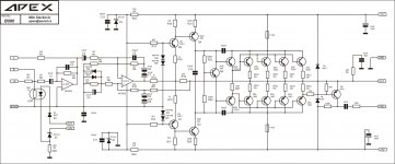

hi friends i try make b500 from apex. i get alot of problems this amp steal my 3weekends i know its easy but i dont know why i still get problems. i finally make it work. but after 2 3 times close and open, one resistor get flame and burnd. when i check it i see my 5200 transistors get short too and fuse blow.
the resistor is R21 on schematic. 100R.
any idea why it can happen? it was working really nice and not getting hot
15032 and 15033 burned and 1943 transistors all is burned too.

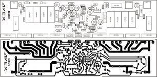

i think i find the problem. it can be the small peace leave there when i open holes on heatsink and it drop on board and short the HV.
is there any thing else can be a reason?
problem fixed. inside my 10 ne5532 only one of them was working but i think they are not good or fake so it get burn too. i put tl072 and all problems go away.
so if any one make b500 use tl072...

i get another problem again 🙁
positive side zener 2v. negative side is 15v. and at signal output have 67vdc 🙁 any advice?
i change 4k7 5w resistor and the 10uf 100v capacitor but still same. now i am changing 100n my board turn to a trash cause of the repair 🙁

Not much point changing random components.
You need to get your meter out and start measuring components for shorts.

If its intermittent first thing to do is do a good visual inspection for unsoldered or bad joints.
I have looked at the circuit for a good few minutes now and I cant see how it works, or at least not the op amp part.
With the input shorted the op amp rails will both be zero volts ! which means it is off.
If the input goes positive then the upper rail rises and turns on the next transistors along and driving the output stage positive.
If the input goes negative then the lower rail goes more negative and turns on the next transistor along and driving output stage negative.

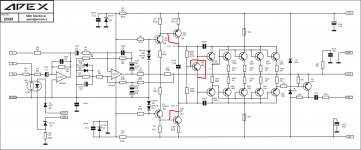

look pics transistor needs capacitor otherwise oscillation and amp selfdestruction
other pic professional amp very stable under heavy load
600 - 1000 PF
about 500 - 600 PF and 1 uf for VBE

Once you get it working again check the output for oscillation.
Oscillation kills output transistors.
As mentioned earlier the VAs needs feedback capacitors to slow it down.
I tend to use 100-220pf with good results.

Yes, but better for safe stable working use 1000 - 1200 PF and 500 - 700 in VBE
was working 12 years in Club, other pic schematic subbass amps in club, never had problem with heavy overloading.
Not burn, not smoke, not fail
