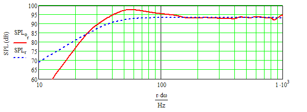

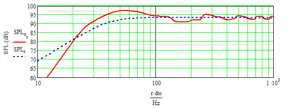

Hi I'm looking for an enclosure for the B200 that will work well in a corner. I'm considering a 175L bass reflex tuned to 40Hz. The enclosure I prefer is roughly rectangular except the front baffle is angled in about 15 degrees. It is 48" high, 24" wide, 15" deep on one side and 10" deep on the other side.

I would be affraid of a broad peak from 130 down to 40 Hz in your simulation. This driver has a very high Q, so it will be hard to get a tight bass in BR alignment.
Actually the high Q works out well with the high fs. If I add a couple ohms of series resistance the peak narrows. It is centered around fs (55Hz). It should give it some kick, rather than sounding mushy.
The more I play around with the sims the more I appreciate how carefully they designed this driver.
The peak would be narrow enough even without additional resistance. Qtc is .9 for this driver. In a closed box you would get Q above 1.0, which to me sounds like a one-note boooom...
In a vented box you will get a two-wave ripple. I cann't model it right now, but would guess at least +-3-4dBs. First peak would be around 120-150 Hz. Second - below 50.
It's a question of taste for sure, but I don't like it. Couple years ago I've got a Linkwitz Transform (Marchand "Bassis") with Q adjustable on the fly. I've tried everything from 1.2 down to .25. After long listening to a variety of music I settled down on Qts=.5.
Another problem with such tuning is that the driver would become unloaded below port tuning very rapidly. With limited Xmax of this driver in a large box it would bottom out at couple Watts of power.
