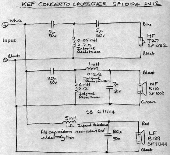

http://www.hifiloudspeakers.info/Anatomy/SpeakerSystems/Concerto/ConcertoCrossoverSchematic.jpg
The B139 SP1044 working with the DN12 SP1004 crossover is a 8 Ohm driver. Older units of the B139 and B1814 where 15 Oms. If interchanging crossovers/drivers make sure you are using adequate impedances or redesign the crossover for that.

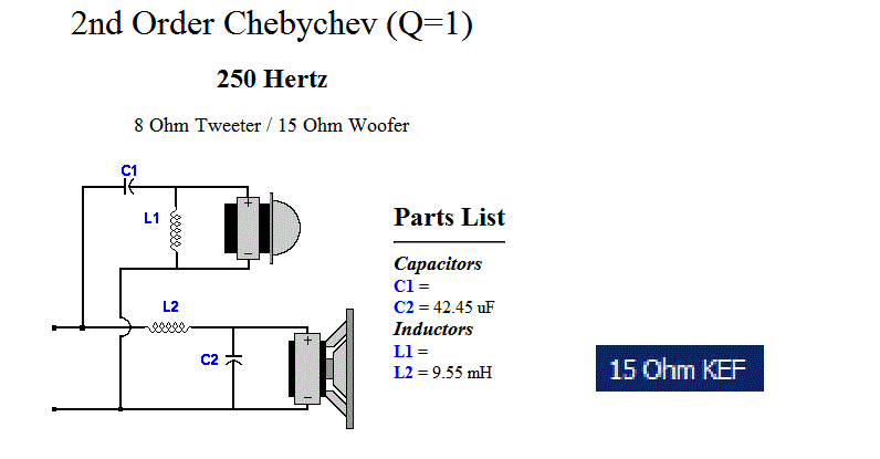

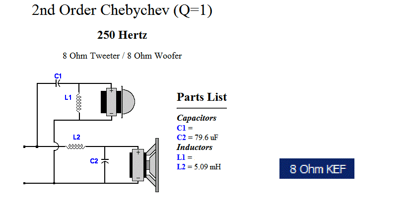

Yes, the B139 is 15 ohm and the other units I am putting in are 8. The SP1004 DN12 crossover is all 8 ohm. Alas, though, modifying a crossover circuit is beyond me. As it is, the LF part consists of a 5mH choke (1 ohm internal resistance) with an 80u capacitor (50v) going to earth from the end of it. Any sugestions gratefully received.
You can double the inductor and half the cap. Adjust, because probably you don't need as much full value components maybe less more between the two. Having access to an old crossover for the 15 Ohm might give you the answer. Post with new info.
You can verify this later, for a better more accurate list of components values.

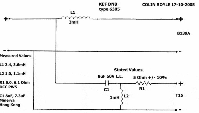

Catawallah, you really need to pull a SP or A number off the B139. There were so many versions! You're also going to have to work out what the original crossover values were for comparison even if you need to buy a £60 multimeter with an inductance scale. That should tell you something, especially since bafflestep is hard to guess, though I'd think these were designed to mount against a wall in big cabinets, hence not so big coils, but bigger rolloff capacitors.

These schematics by Colin Royle and Steve Bell as usual.
