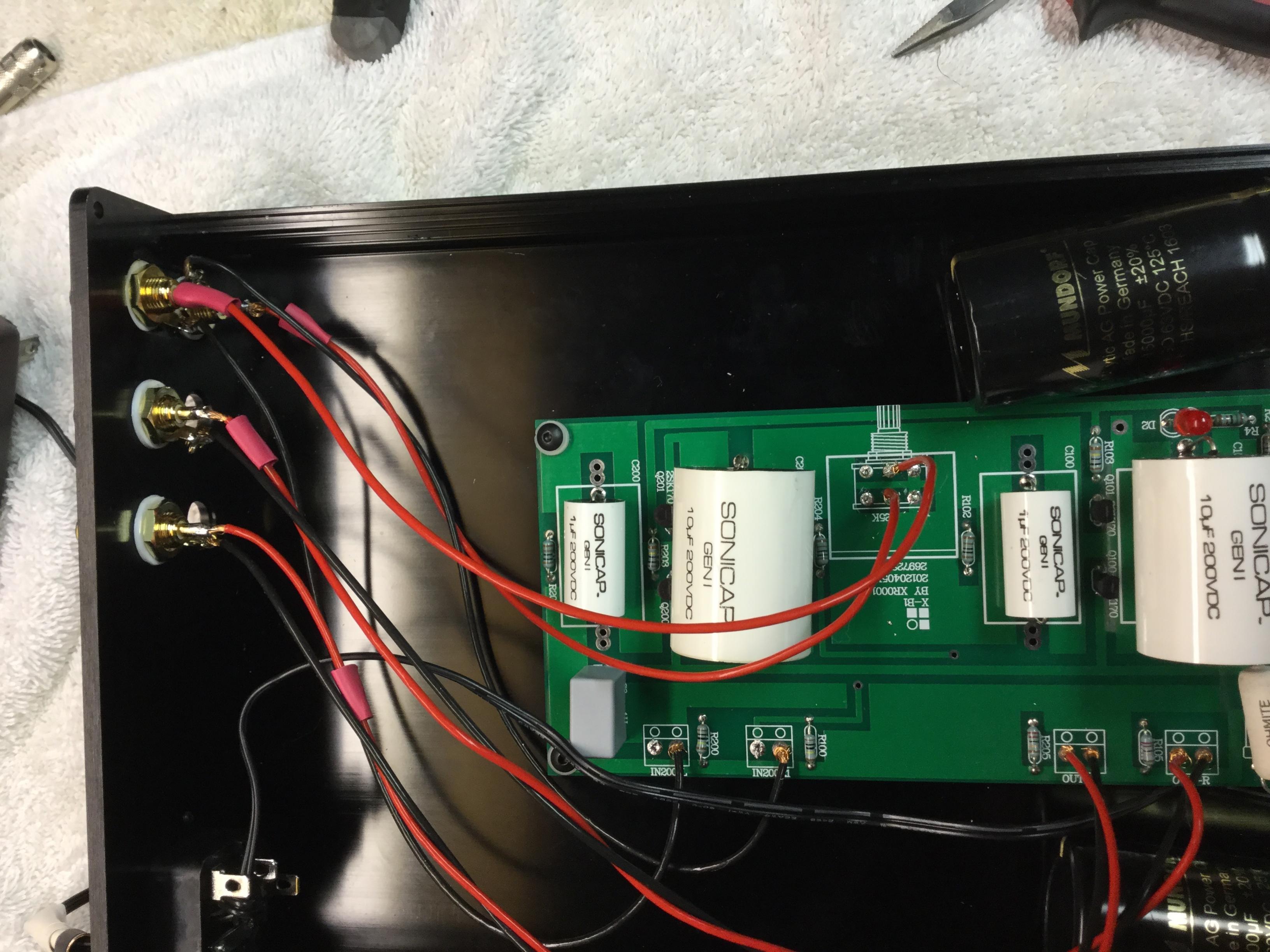

I picked up a B1 build from a fellow DIYer, knowing it had a problem (and hoping I could troubleshoot it). It works, but one channel has extremely low output. I can hear the signal coming through, but even at full volume it is barely audible. The other channel works fine. At first I suspected the Alps Blue Velvet pot, so I removed it from the circuit and wired the output wires directly to the board (I want to use it as a buffer only with my passive preamp anyway). That wasn't the problem... I've checked continuity of all the wires, and there are no issues. I've also verified that all grounds are common on the board. No issues. So I checked voltage from the caps (c100/c200 and c101/c201) to ground and they seem read about the same. I also checked all the resistors, and they seem fine. So at this point I'm stumped. I guess my next thought is a bad JFET? But I thought that since the caps read similar voltages the JFETs were probably okay ... but I could be completely wrong bout that. For the record, electronics isn't my strong suit, although I'm trying. I'm not sure how to check for a bad JFET.
Any thoughts or suggestions on what might be wrong or what to check next? My plan, if I can get it working properly, is to take it out of the chassis it's in now and mount the board into a box that matches my passive pre. It will not have a volume pot, and I'll only need one input and one output. A pic of the board that is used is attached (it's a clone B1 board).
Thanks! And I can take pics of anything if needed or if they'll help.
The soldering doesn't look too good, I'd start with that. Make sure there's 10VDC bias on the input gate.
That is an unlicensed PCB and not original Pass Labs.....
Soldering looks pathetic, builder did not understand the connector symbols obviously. Then, after having made the mistake not to use connectors wires have been twisted so sloppy that you can see near shorts. Grounding and input wiring done wrong ...Building like this gives DIY a bad name.

I've been helping Tlarwa troubleshoot this little pre a bit over email and can maybe provide some more second hand details.
The symptom is that the right channel is very weak/low output. The left one sounds like it's working correctly (I haven't heard it personally, but Tlarwa would know if there was an issue as he has played with a lot of gear and knows his own system well).

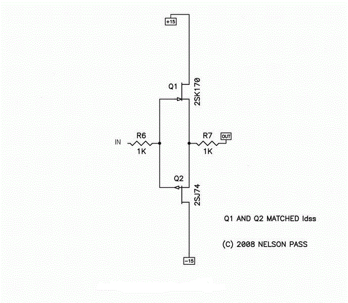

* The power supply and the 2 x 10k resistor divider (mid point to upper JFET gate) measure correctly.
* The JFET sides of the output caps (10uF) both measure about 8.5VDC.
* The JFET sides of the input caps (1uF) both measure the same DC voltage between channels (maybe Tlarwa can provide the exact measurement).
* Tlarwa removed the input pot so tracking/bad pot can be eliminated.
* touching the lead of the input cap on the JFET side leads to a buzz in the right channel (no effect in the left channel)
I am not a JFET expert, but it sounds to me like the JFETs are biased correctly (or at least consistently between channels). Could they measure consistently between channels but still have a dead (or incorrectly installed) device in the right channel? We've also been discussing the possibility that one of the caps in the right channel is bad, though JFETs are the more fragile device and that's where our suspicions are still focused.
