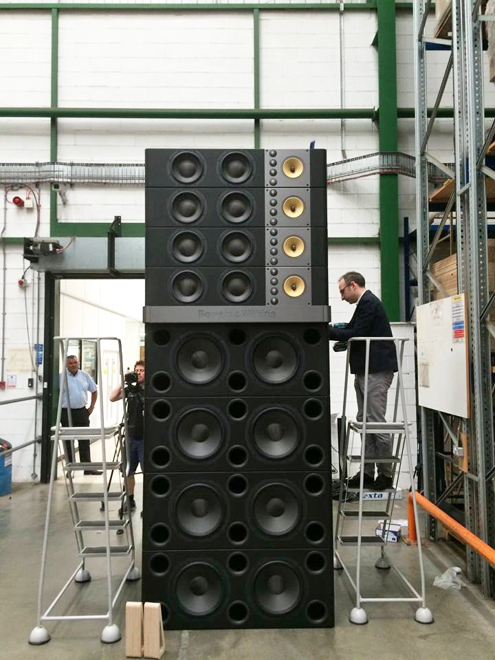

This is one of the twelve 6" midranges used in the B&W Sound System for the 2014 Primavera Sound festival (ESP)
Project engineer and system designer was our very own @truecolour

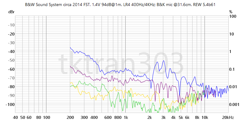

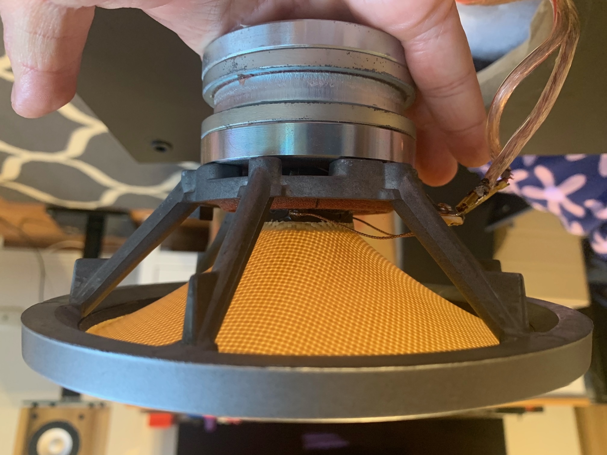

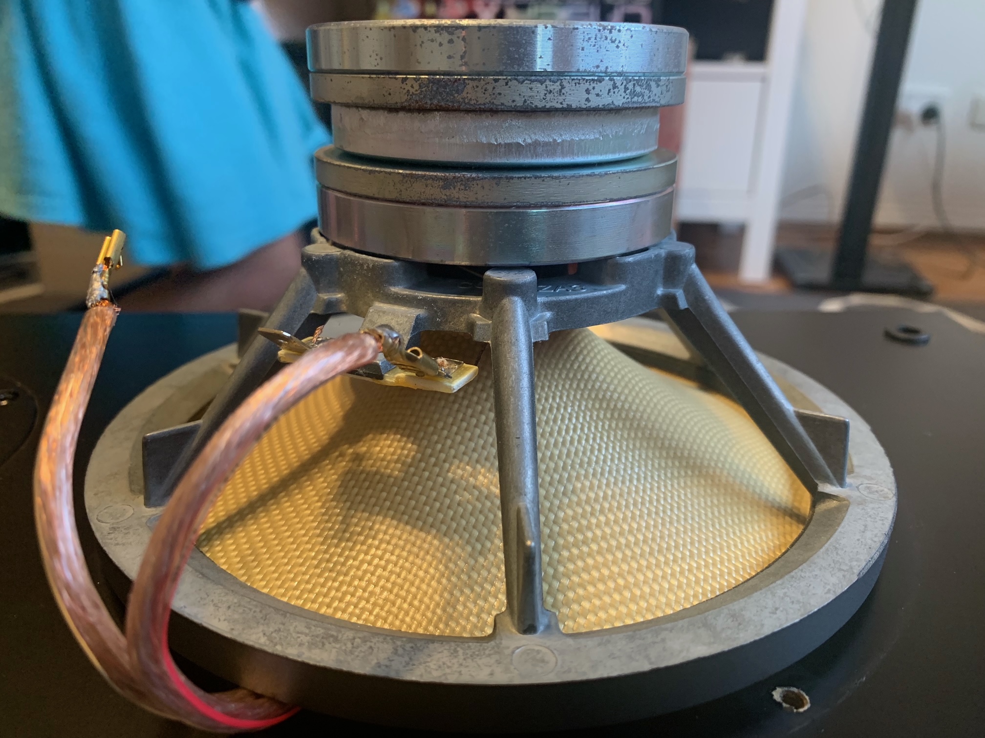

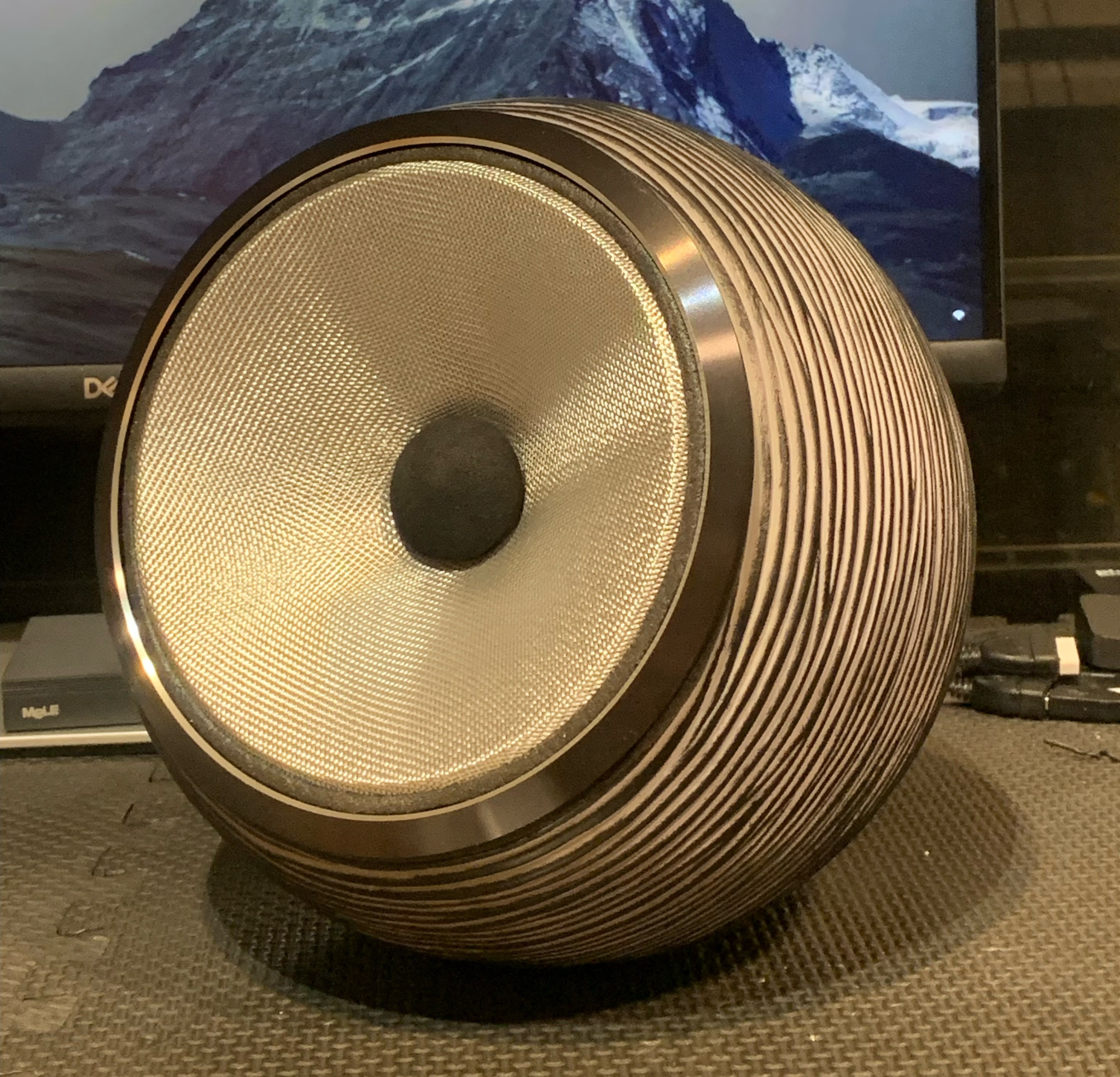

This thread is a measurement/review of the custom 6” drive unit from the system. A few of us were fortunate to acquire this unicorn.

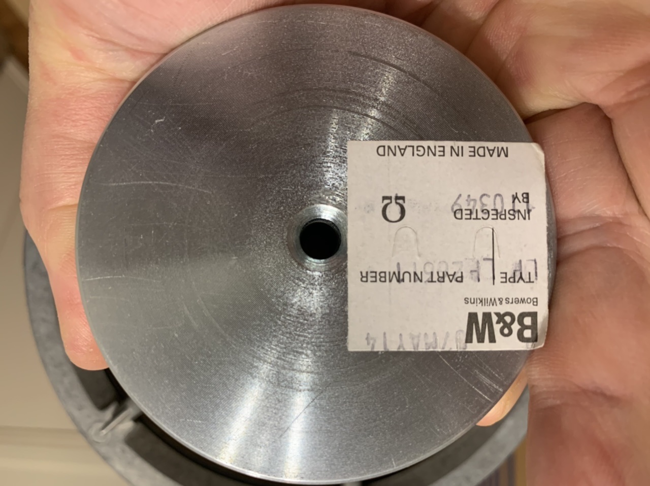

Background- the midrange unit is based on a midrange unit from the CT8LR custom-install system:
The main difference between this and the CT8 driver is that this has a yellow cone, but the similarities include a twin neo magnet, allegedly for symmetric BL(x) and Le(x).

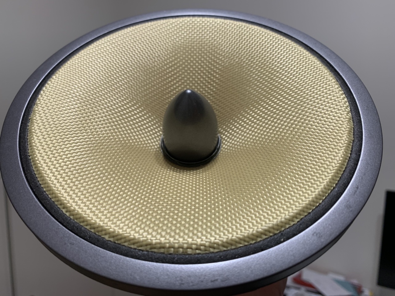

Like the 800 series midranges, it uses the woven Kevlar cone, and dispenses with the traditional surround, instead having a thin foam “Fixed Suspension”. This surround (and spider) affords the cone only a few mm of movement, BUT perhaps because of this, reduces surround radiation distortion

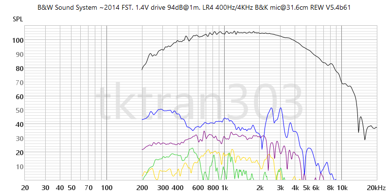

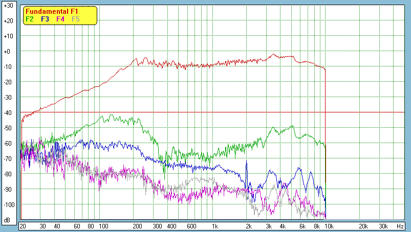

So low, In fact, that the microphone was not able to accurately measure the harmonics:
Sonarworks Xref20 mic:

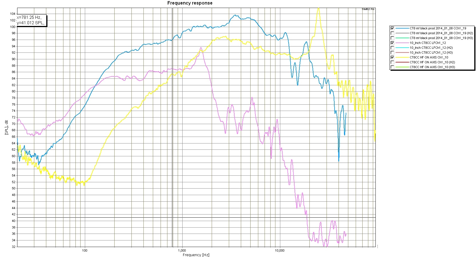

Incredibly, it has the sensitivity of pro-sound midranges- ie. >95dB/2.83V/1m, yet displays a smooth and extended frequency response to past 10KHz, and mild breakups only occurring past 3KHz.
B&W measurement of individual drivers in CT8 cabinet (blue trace)

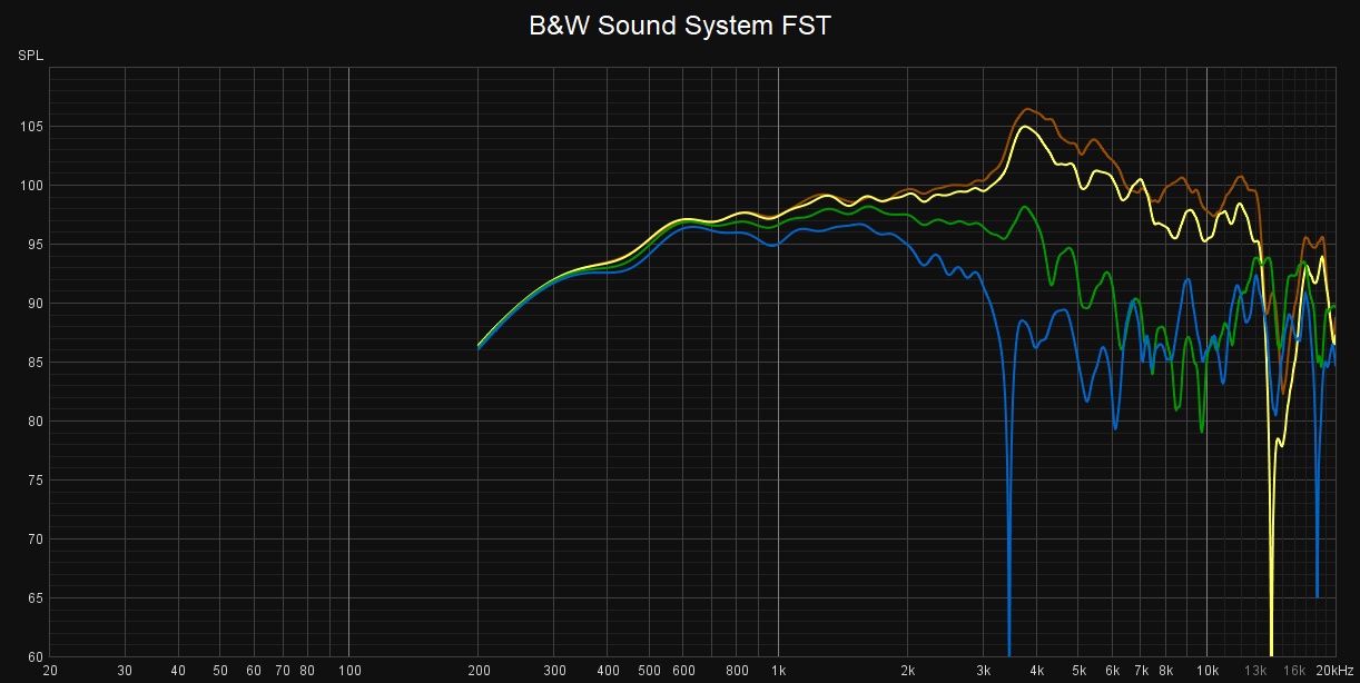

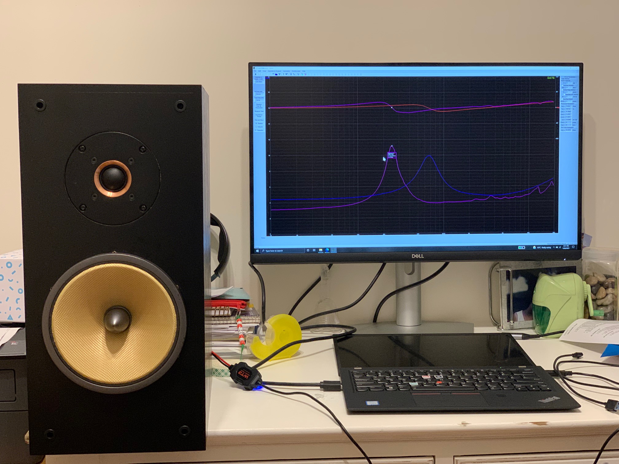

When this first arrived to me in Australia, I plopped this driver into an existing test box and took some measurements, including on axis, 15, 30 and 45 degrees off axis.
The sine sweep had a gate of of 5ms (measurements good down to 200Hz) and since it is an 4 ohm nominal driver, I tested with only 2V drive at 1m.
The baffle is 8 1/4” wide; with no roundovers for edge diffraction control- this contributes at least 2dB to the peaking at 4KHz. Also the driver is surface mounted, which causes raggedness of at least +/-1dB anywhere above 2Khz. So this quick/dirty measurement on an unoptimised baffle.
Just add 3dB to figure out the 2.83V sensitivity- that’s almost 100dB /2.83V
Now, to find woofers and tweeters that can keep up!

Looks ok up to about 3kHz then you start seeing some oddities, first there is a 5db peak at ~3,8kHz that needs some attention even if crossed around 2-2,5kHz, and above that it stays abit bumpy, impressive sensititivity though, considering its size.

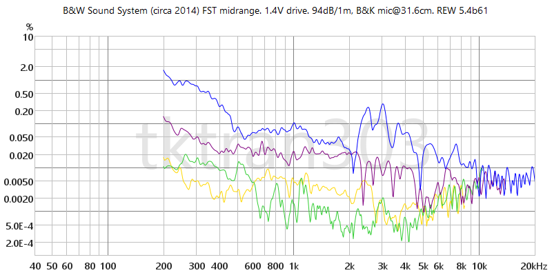

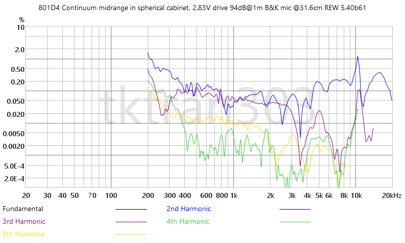

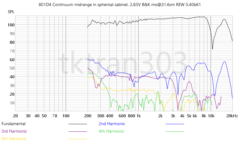

Looks like total THD above 400 Hz of that mid is around -50dB, which is really good,
That notch just under 4k looks like a VC gap cavity resonance coupled with start of cone breakup right above that. Off axis looks manageable with tricky filtering. This isn't your typical DIY friendly driver. Impressive feit pushing the cone breakup on a driver this size that far out.

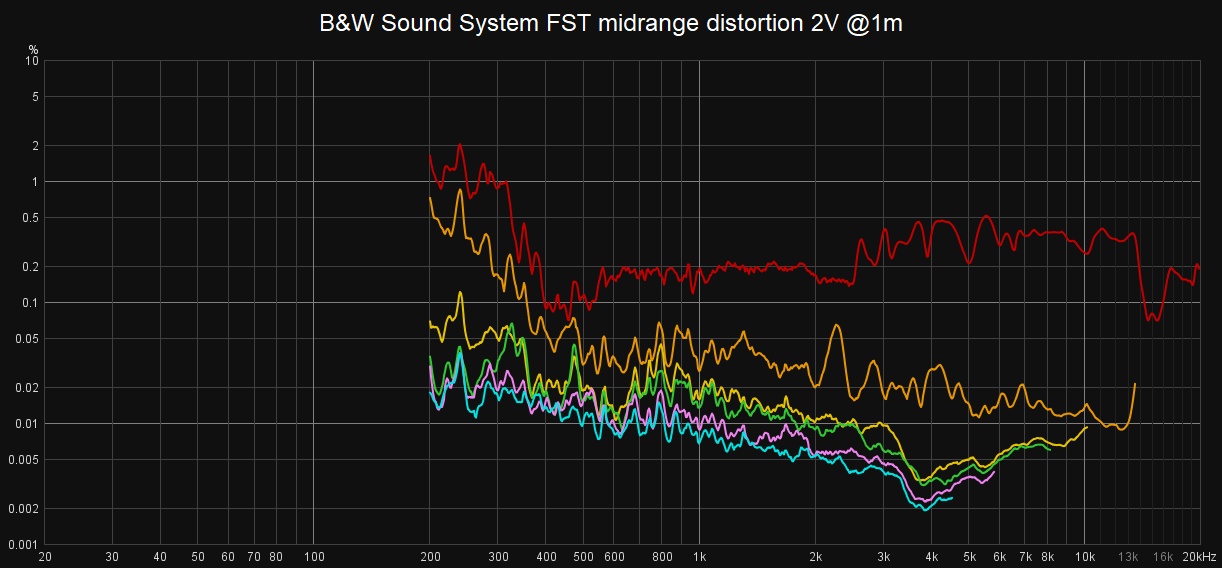

The distortion is excellent, particularly H3 and higher order H5 to H9.
Letting the drivers talk to me, I think the natural lower cutoff is around 400Hz. Maybe 300Hz LR4 depending on how loud I listen. At the upper end; I’d take it to 1.8Khz if I wanted to maximise the dispersion. But that mean it’s only covering 2.5 octaves.

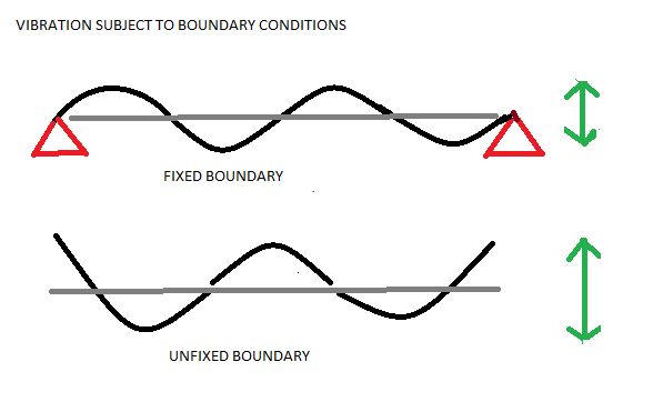

Before you get too carried away by B&W's engineering genius, we can be aware of the maths behind solutions to a differential equation with different surrounds and voicecoil drive...
Rigid surrounds and voltage drive tend to fix the boundaries into what is known as the Dirichlet boundary condition. Bit like a guitar string fixed at the fret and bridge. B&W solution or corrugated surrounds might get near this. Top image.
Unfixed surrounds and current drive will leave the ends or boundaries free to flap around. This is the Neumann boundary condition. Foam surrounds might get near this. Bottom image.
Many other factors involved. Cone profile, inherent damping of the cone. Damping at a rubber edge surround and voicecoil in intermediate conditions. Always hard to get right.
Nothing is perfect! Kevlar is generally considered overly lively and prone to nasty breakups around 4kHz here. Metal is worse, polycones better on breakup.
Because maths applies to most things, the images below might as well be the hypothetical strings in Physics either attached to a D-Brane or in free space. Or speakers! 😀
Baffle shape and size might be classed as a boundary condition too. Affects dispersion.

I agree with Zvu; Zaph measured this type of driver 10 years and 1 month ago and I remember wow- what a phenom of a midrange.
The woven Kevlar cone behaves closer to a soft cone than a hard cone, with very well managed breakups. And that higher order harmonic distortion was just sunk below the recesses:
This midrange just supercharges the sensitivity using a double neo magnet.

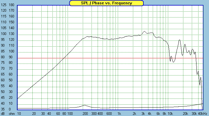

I agree, and the closest available product available to DIYers, I think, is the SB Audience
6” Nero midrange:
SB Audience :: NERO-6MRN150D
Sensitivity very high (98dB/2.83V; 8 ohm driver)
Benefits of soft cone- smooth FR with controlled breakups without high Q resonances
Flat foam surround with 1-2mm Xmax and
bandwidth about 400Hz to 2.5Khz judging by the distortion measurements; as
tested by Vance for Voice Coil recently.

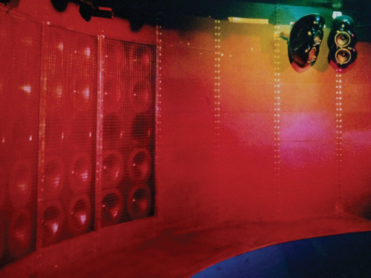

As far back as 1993, Simon Ghajary and Lawrence Dickie were excavating walls and installing 801 drivers into nightclubs.
Here’s twenty four 801 bass drivers at The Great Escape, a nightclub in Brighton, England.
…this is before Twilo, Space.. before the fall of the Berlin wall, the Love Parade… or even “in-wall subwoofers” became “a thing”

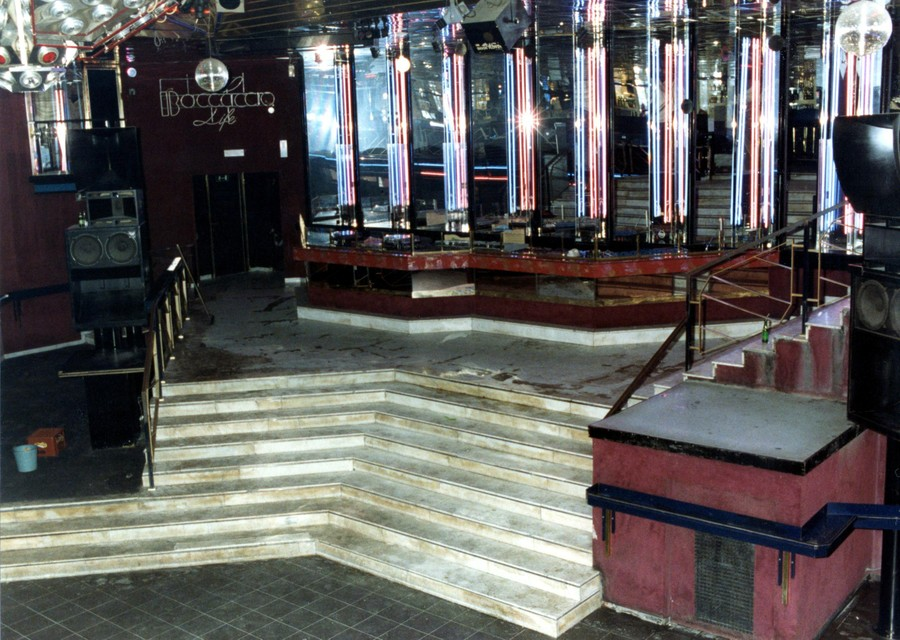

Our oldest (modern style) night clubs in Belgium, the Popcorn used Altec A7 speakers, and the other legandaric club in Belgium of the 1980's, the Boccacio had a JBL Cinema systems. The Fuse, the legendaric techno nightclub in Brussels, had in the early days also an Altec A7 system, but it was soon replaced as it could not keep up with the modern techno they played there....
This is the Boccacio in 1988, in the mids of the newbeat and EBM hype that ran around this club with the JBL rig. The club was running (under different names) until a few years ago and is now demolished to make place for a sport complex.
So running hifi or theater gear is not new at all, in the early days of nightclubs it happened all the time as those were often better than the pa gear of that time in sound quality. Nightclubs in Belgium in the 1970's and 1980's bought often old movie theater gear as it's fit for big closed spaces on high volume.

Look up the posts from @5th element , on his FST project or his webpage, concerning the yellow kevlar cone FST.Now we have to figure out how to get a tweeter in place of the dust cap...
The b&w FST "phaseplugs" are fairly easy to remove.
No glued in place dustcap
