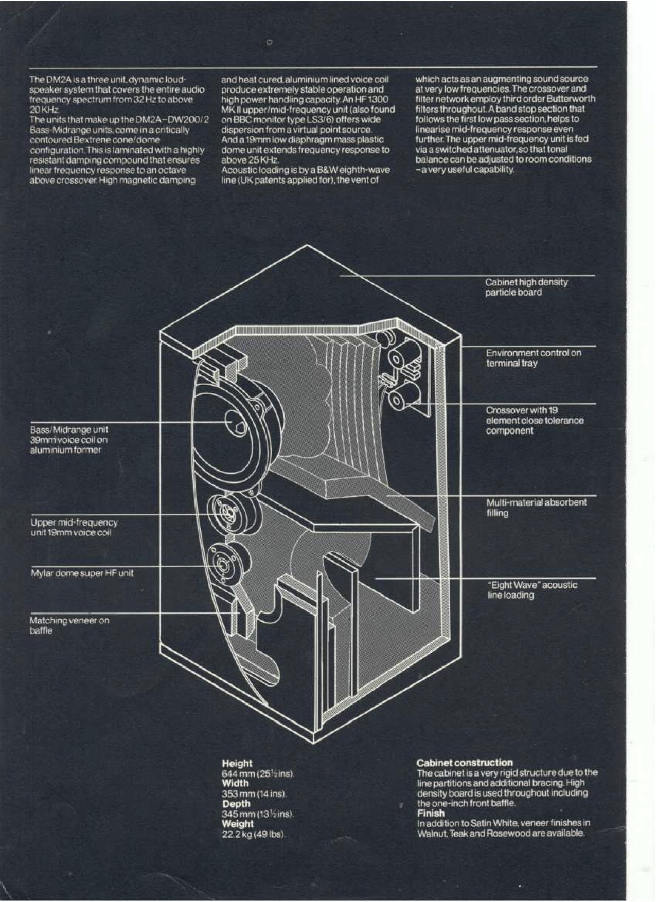

Hi there, I own a pair of the DM2 speakers, and absolutely love them.
Mine are a DM2a, and they have the port with the rounded ends. The tweeters are in a vertical line with the woofer at the top, and these ones are fitted with the Coles. These ones are fitted with a three position tweeter balance control on the rear by the terminals.

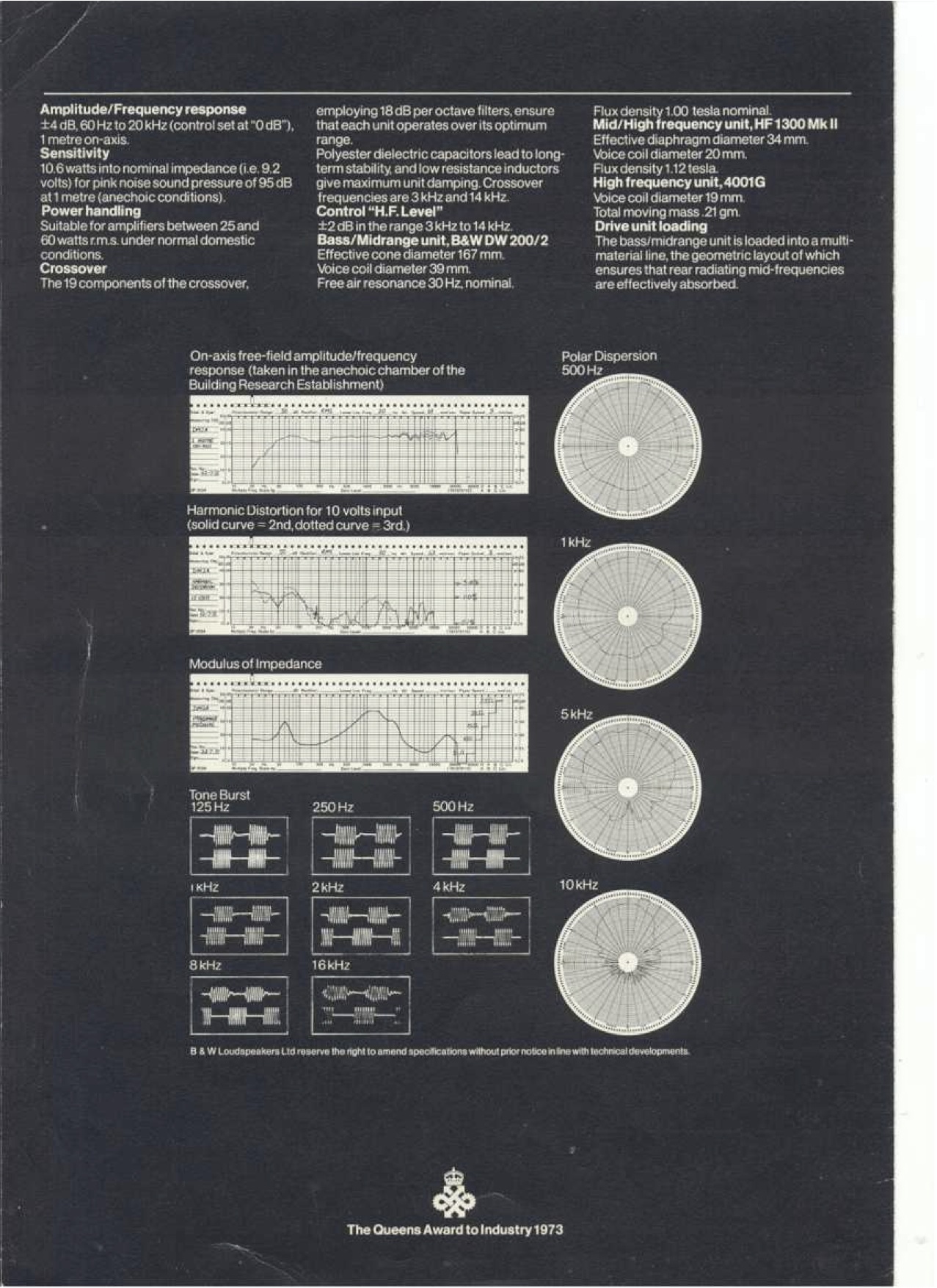

I really love the sound of these speakers, a bit limited by todays standards but they have that deep warm sound that only the high-end British speakers have, similar to the KEF's and Celestions of the day. Like many other speakers of the era, these use a transmission line type enclosure (the DM2 uses an 8th wave line) and the woofer cone is bextrene. Slightly thicker than the KEF units such as B110 and B200 etc so doesn't have the same resonance problems, but in return has a lower efficiency. They are only rated to 60/70W or so, but need at least a 100w amp or more to get the best from them.
I have also uploaded a 4 page information brochure which has a bit more info on them.

Heh I opened them up to have a look inside before I even connected them up to an amp! (I open up pretty much every new bit of equipment I receive to inspect the workings and see how its built, unless doing so would void any warranty)
Don't go changing any of the damping material, there is about 3 or 4 different damping materials used throughout the line and its very well thought out, so changing it would likely only make it worse.
I haven't bothered doing the caps on mine, they sound great as they are and both speakers sound balanced, so I don't see the need to replace them. I think some of the caps are metallised polyester or polypropylene caps etc and not electrolytic so there's no need to replace those. I can't remember how many if any electrolytics there are in there.
