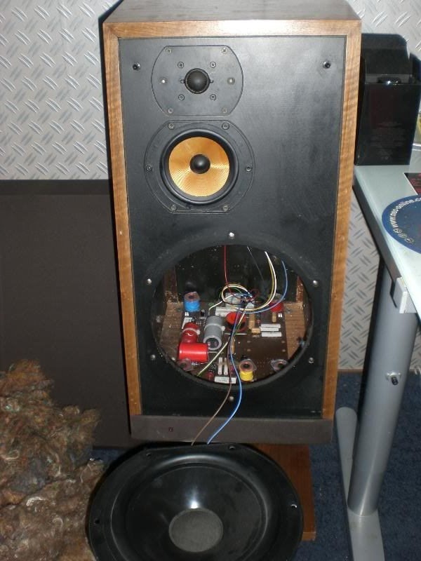

I have some B&W DM16 that I decided to restore by improving them as much as possible.

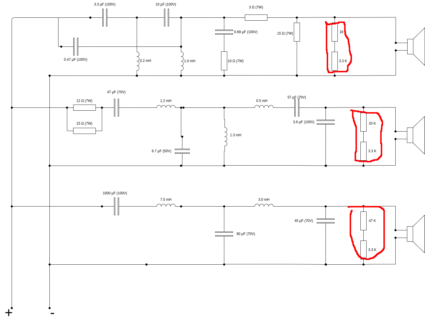

In this thread, I would like some help on the crossover. Please bear in mind that I'm not an expert. I want to create new crossovers starting from 0, leaving the originals intact to be reinserted without problems.
My project also includes internal rewiring, spreading soundproofing on the internal walls, and possibly also changing the sound-absorbing material (from the factory is wool threads). As for the crossover, I designed from scratch an implementation without the protection circuit.
Could you give me some suggestions? Could it work as I designed it?
In your opinion, is the 1000 µF capacitor on the woofer line necessary?
