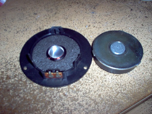

Otherwise I wouldn't have thought it is terribly difficult to fit a new tweeter behind the B&W face plate. You'd need to do some serious measuring to make this easier. Most of these things are 19 or 25mm metal domes. The good ones detach the magnet and dome from the faceplate with three screws, which is why measuring can make this easier.
There really isn't much to a modern tweeter, as below. Which is a plastic clip style. Some use screws.
Always good to do some testing too. An old tweeter that still measures 4-6 ohms DC might just have solidified ferrofluid in the gap. You might clean and replace.
