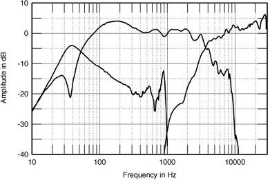

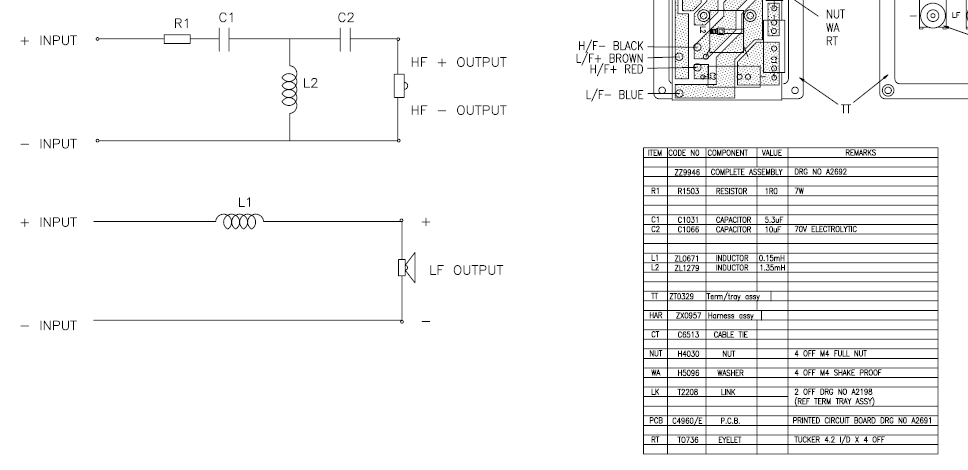

B&W LOVE this 3kHz 4 ohms tweeter filter. I've seen it so many times. Kevlar 6" bass. B&W Compact Domestic Monitor 1 loudspeaker | Stereophile.com
