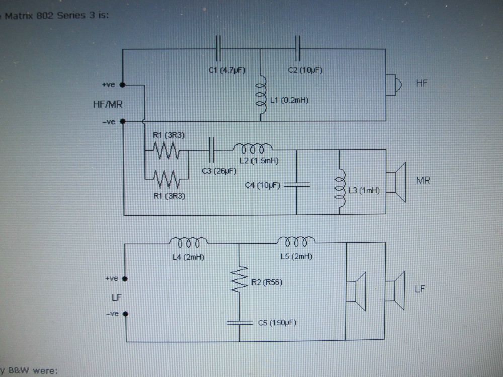

To figure out the schematic for the N804's, I would have to take the boards out
which I don't want to do.
However, looking at the component list of the N804's, its a close match to the Matrix 802 schematic attached.

Uunderhill,
That is a much more refined crossover you just posted. It is a 3rd order design, I am not a great fan of those because of the phase shift at crossover point but this is a much more thought out design. Are the speakers in the two different speaker cabinets the same? If not you are just taking a chance that this crossover will work for you. It just seems that you are working backwards as far as improving what you actually have. I still think you need someone to check your speakers without the crossovers attached and start from there.

There is no real way to get the N804 crossover schematic
without pulling the boards out - which I am chicken (or wise) about doing.
So I can only speculate that the Matrix 802 and N804 crossovers are very similar.
However, the component list for both crossovers is nearly identical.
