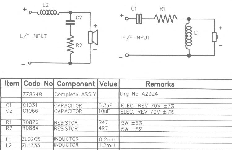

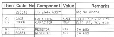

It always helps to post the crossover diagram and a picture. Below from the service manual.

The 10uF is in series with a 4.7R resistor, so the ESR and hence type of capacitor shouldn't matter. So electrolytic or MKP.
The tweeter has an electrolytic 5.3uF and not much resistance at 0.47R, so changing it to a standard 5.6uF MKP (polypropylene) might entail changing the resistance. Say 1.5R if it sounds too bright, because electrolytics come with "free" series resistance around an ohm.
Since the capacitor is 7% tolerance, and always a bit vague in practise anyway, I wouldn't lose too much sleep over a 5% change in value. That will be inaudible. In practise 5% change alters crossover frequency by 2.5%. It's a square root relationship of inverse LC in a second order filter.

The B&W DM610i is an interesting speaker. It's actually a 4 ohm unit. Polycone bass and metal ferrofluid tweer.
Since it's 4 ohm, crossover must be around 3kHz. If you were using 8 ohm units, you'd add 50% to inductance and resistances, and reduce capacitors by about a third. So the bass just has a bit of near-Zobel impedance correction.
Which is pretty much what works with most well-behaved 8" bass units. And polycones are the ultimate well-behaved and smooth units. 😎
