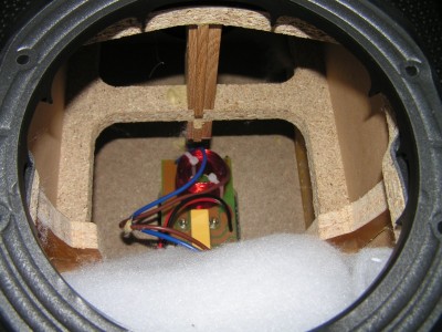

I am now the happy owner of a pair of modified 602 S3 and thought it might be useful to share my experience. There are two things I have done:
1. Stabilized the cabinets. As it can be seen in the picture, I added two "ribs" on the lateral walls just aside the woofer and a piece of hard wood that links the back, front and the original middle reinforcement of the cabinet. The front is build like a low resonance sandwich of wood, plastic (filled with mica, according to B&W) and the aluminium chassis of the woofer, but I backed the plasic with some self-adhesive bitum tape to further reduce resonance.

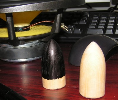

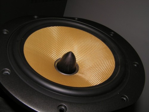

2) Actually THE modification: I removed the plastic dustcap of the woofer and installed phase plugs !
The plugs are made of wood, I tried to keep the shape of the dustcap (it resembles the phase plug of the B&W 700 and 800 series). THere are a few aspects that must be considered when performing the operation:
- I wouldnt try to remove the cap by pulling it in any way, because it it firmly glued to the Kevlar cone. Instead, I have cut it with a cutter (and attention) just at its base, leaving a plastic ring glued on the cone.
- the plugs can be gluet to the pole piece without problems.

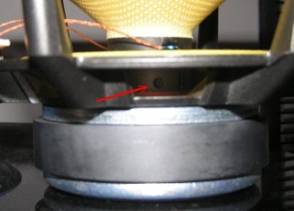

- the voice coil has 4 holes in it, just behid the spider, that serve to eliminate compression behind the dust cap. With the dustcap removed, these holes are now openings between the interior and the exterior of the cabinets, which is not goot. Make sure you cover them (I used adhesive paper tape, for protection by paining), they make a HUGE difference.
That's it.

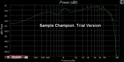

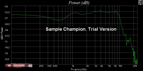

I managed to make some more measurements using the MLS software SampleChampion (Trial Version) - great program !, and the SPL-meter as microphone. Here we go with the farfield (~1m) woofer response on axis:

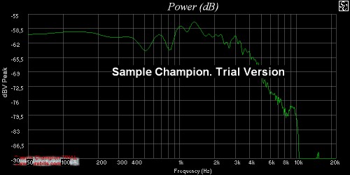

I've also measured the whole loudspeaker. There seems to be no indication of a frequency response dip. A slightly increased, B&W typical high frequency response can be noticed (it also seems that my microphone does not respnd above 10-12 kHz anymoore).
So it looks safe on the technical side..(to me). As to the sound, I have already covered this sobject before.
In both cases the distance was ~1m.
The woofer was measured roughly on its axis, while the whole loudspeaker was measured roughly on the tweeter axis, which is closer to the real setup (ear height is approx. on the tweeter axis)

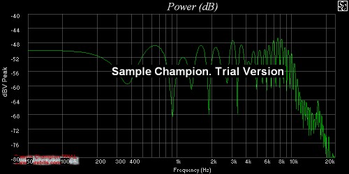

However, I have also done measurements from my listening position (~3m from loudspeaker and ~10 degrees off axis). In this case, the direct and reflected components of the signal are much more closer to each other, so you can select both on the time axis and have a summed response of loudspeaker and room reflection.
Of course, the summed response was quite chaotic with dips all over, but the direct component was almost perfectly linear !!! I have previously seen measurements of 602 S2s which were also better slightly off-axis.
From what I see, the mic is totally uncalibrated. I cant make out useful conclusions. Live aside that to take power response you need to average a grid of readings (maybe 20) over a 1,5m(h) x 2,5m (w) window around your ear at listening position for both speakers (one and then the other and sum the averages) using pink noise. Leave it at that. If it sounds ok, its ok.
What do you mean by "uncalibrated" and how did you draw this conclusion?
I just measured the relative response of the speaker, I do not care much about absolute values. If you mean the mic might be non-linear, then you may be right, but the deviation should be small. I intend tu ose a proper mic in the future though.
