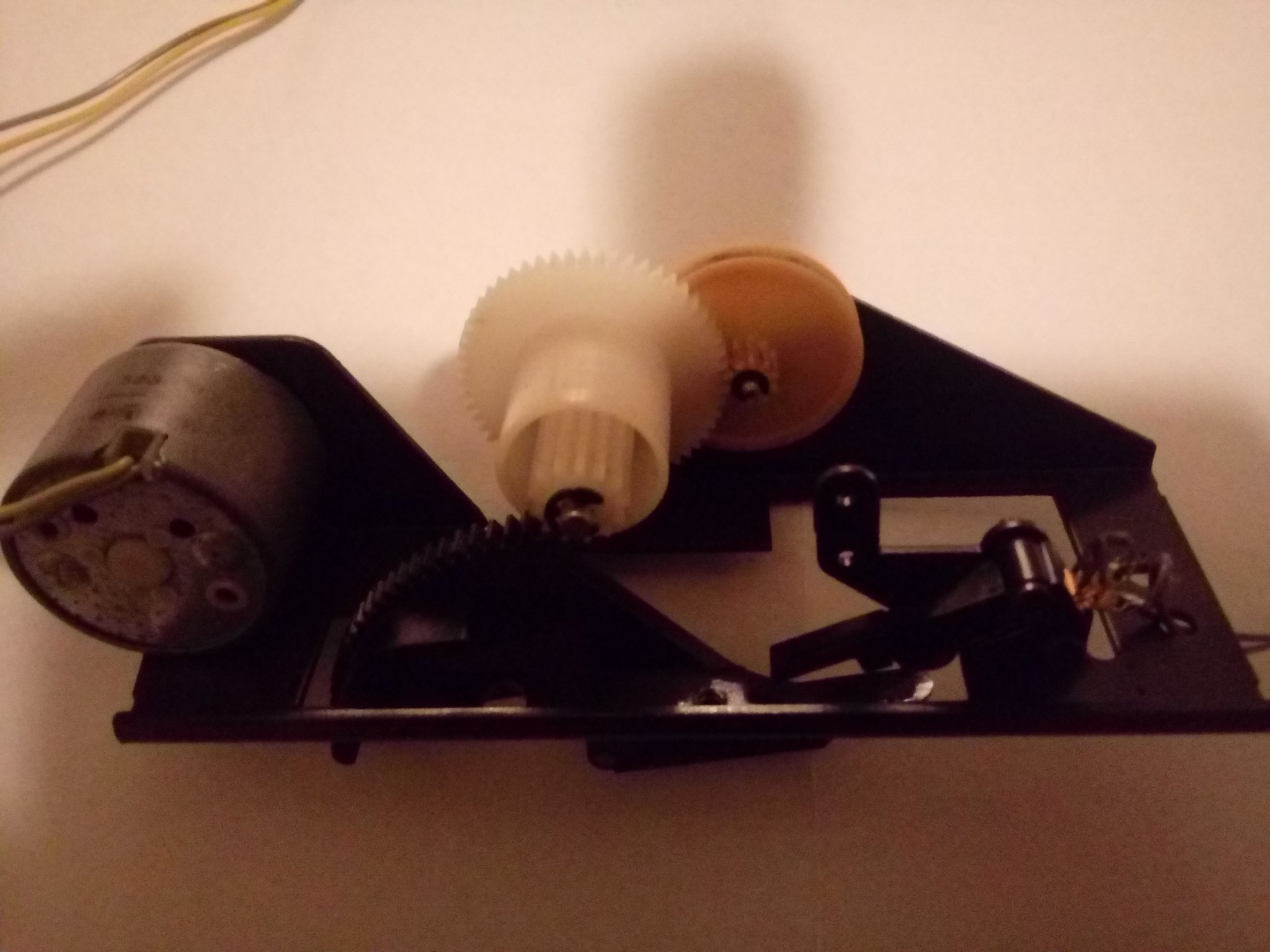

Does anyone have any experience with a stuck lid of this cd-player?
For sometime it worked very well, but recently it got stuck and i don't know where to begin to repair this.
The player thinks the lid is open, but in fact it is closed....How to reset this thing? Anyone?

just i remember ....
a: check the switches, for 'open' and 'closed'
b: tray motor running / starting ?

Hello,
Thank you for your reply.
I'm afraid i messed up. Certain that i was that the problem was something mechanical, i broke a tooth from the toothed wheel by lifting the lid.
So i think i should see a dentist ( ha,ha,ha... ) But seriously, can somebody supply a toothed wheel? It's the yellow one top left corner of the image above.
Because the lid will not open anymore...
I think the models cdx and cd3300 are similar to the cdx-2.
Hope somebody can help me out,

Hello again,
I ordered a pulley/toothed wheel at ebay. It is not an original and i hope it will work.
To be continued later...

Hello hello,
I managed to put a new pulley and belt in it. And for now it works like a charm! 🙂
The lid closes and opens even faster than before...Thanks to a supplier from Denmark via ebay.
Cheers and best regards
ps on the photo below, the old situation
